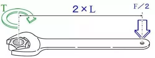

In physics, moment refers to the tendency of a force to cause rotation around an axis or pivot point. It is a physical quantity that measures the rotational effect of a force on an object. Moment can be divided into two types: the moment about an axis and the moment about a point. Torque, also known as turning moment or twist moment, is a type of moment specifically referring to rotational forces.
In the formula:
  • L is the distance vector from the rotation axis to the point of force application,
  • F is the force vector.
Moment is also a vector quantity, and its unit of measurement is Newton-meters (N·m).

  1. Torque refers to the turning moment or force couple that causes rotation in mechanical components (and other objects with a tendency to rotate). When a component is subjected to torque, it will undergo some form of twisting deformation, which could involve elastic or plastic deformation. Therefore, torque is sometimes referred to as twisting moment or torsion.
  • In engineering, torque is more commonly used, while torsion often refers to the twisting deformation caused by torque.
