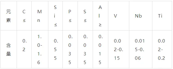

化学成分
Q345A:C≤0.20,Mn ≤1.7,Si≤0.55,P≤0.045,S≤0.045,V 0.02~0.15;
Q345B:C≤0.20, Mn ≤1.7,Si≤0.55,P≤0.040,S≤0.040,V 0.02~0.15;
Q345C:C≤0.20,Mn ≤1.7,Si≤0.55,P≤0.035,S≤0.035,V 0.02~0.15,Al≥0.015;
Q345D:C≤0.20,Mn ≤1.7,Si≤0.55,P≤0.030,S≤0.030,V 0.02~0.15,Al≥0.015;
Q345E:C≤0.20,Mn ≤1.7,Si≤0.55,P≤0.025,S≤0.025,V 0.02~0.15,Al≥0.015;

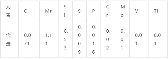

1.化学成分
Q345化学成分如下表(%):

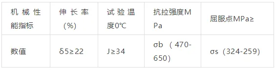

Q345C力学性能如下表(%)
其中壁厚介于16-35mm时,σs≥325Mpa;壁厚介于 35-50mm时,σs≥295Mpa

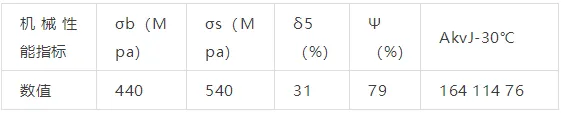

力学性能见下表:
