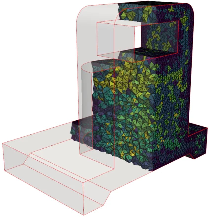

Example: Read stl to delimit tetrahedral mesh and use pyvista to visualize the mesh (you need to manually adjust min_facet_angle, max_radius_surface_delaunay_ball, max_facet_distance, max_circumradius_edge_ ratio, etc. to get the ideal mesh). ratio to get the desired mesh)
import pygalmesh
import pyvista as pv
mesh = pygalmesh.generate_volume_mesh_from_surface_mesh(
    “test.stl”,
    min_facet_angle=25.0,
    max_radius_surface_delaunay_ball=1,
    max_facet_distance=0.5,
    max_circumradius_edge_ratio=1.3,
    verbose=False,
) # meshio object
mesh_pv = pv.wrap(mesh) # Wrap to pyvista object using wrap() function
# Split the visual mesh
crinkled = mesh_pv.clip(normal=(1, 0, 0), crinkle=True) # profile
p = pv.Plotter()
p.add_mesh(crinkled, color='w', show_edges=True)
stl_model = pv.read(“test.stl”) # original model as reference
p.add_mesh(stl_model, color='w', opacity=0.2)
p.add_mesh(stl_model.extract_feature_edges(), color='r')
p.show()

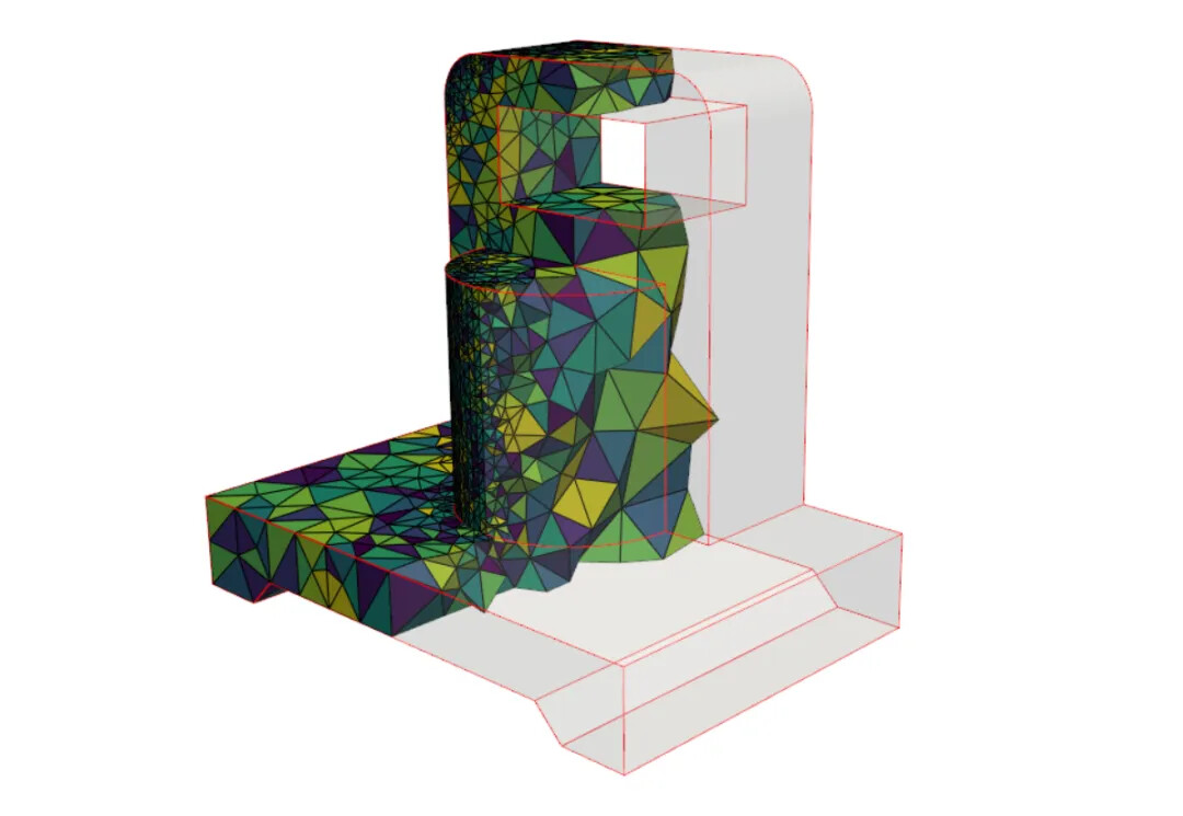

Example: Read stl and partition linear or quadratic tetrahedral cells, specify global mesh size, use pyvista visualization.
import gmsh
from pygmsh.helpers import extract_to_meshio
def generate_tetra(model, mesh_size, mesh_order=1, threads=2):
    # 初始化
    gmsh.initialize()
    gmsh.option.setNumber("General.Terminal", 0) # 控制台信息输出 0:不输出 1:输出
    gmsh.option.setNumber("General.NumThreads", threads) # 多线程 (加速效果不明显)
    gmsh.clear()
    if mesh_order == 1:
        cell_type = pv.CellType.TETRA
    elif mesh_order == 2:
        cell_type = pv.CellType.QUADRATIC_TETRA
    else:
        raise ValueError('mesh_order must be 1 or 2')
    # 加载STL模型
    gmsh.merge(model)
    # 识别面
    gmsh.model.mesh.classifySurfaces(40 * 3.1415926 / 180.)
    # 创建体
    gmsh.model.mesh.createGeometry()
    s = gmsh.model.getEntities(2)
    l = gmsh.model.geo.addSurfaceLoop([e[1] for e in s])
    gmsh.model.geo.addVolume([l])
    gmsh.model.geo.synchronize()
    # 利用背景网格的场数据指定全局网格尺寸
    f = gmsh.model.mesh.field.add("MathEval")
    gmsh.model.mesh.field.setString(f, "F", str(mesh_size))
    gmsh.model.mesh.field.setAsBackgroundMesh(f)
    # 指定网格阶次
    gmsh.option.setNumber("Mesh.ElementOrder", mesh_order)
    # 2D 网格划分算法 (1: MeshAdapt, 2: Automatic, 3: Initial mesh only, 5: Delaunay, 6: Frontal-Delaunay,
    #               7: BAMG, 8: Frontal-Delaunay for Quads, 9: Packing of Parallelograms, 11: Quasi-structured Quad)
    gmsh.option.setNumber("Mesh.Algorithm", 2)
    # 3D 网格划分算法 (1: Delaunay, 2: New Delaunay, 3: Initial mesh only, 4: Frontal, 5: Frontal Delaunay,
    #               6: Frontal Hex, 7: MMG3D, 9: R-tree, 10: HXT)  - 目前只有HXT支持并行
    gmsh.option.setNumber("Mesh.Algorithm3D", 10)
    # 划分网格
    gmsh.model.mesh.generate(3)
    # 转pyvista UnstructuredGrid
    mesh = pv.wrap(extract_to_meshio())
    gmsh.clear()
    gmsh.finalize()
    # 提取四面体 (完整的网格包含点、面、体单元)
    mesh = mesh.extract_cells_by_type(cell_type)
    # 二次四面体节点编号顺序修正
    if cell_type == pv.CellType.QUADRATIC_TETRA:
        mesh.cells = mesh.cells.reshape(-1, 11)[:, [0, 1, 2, 3, 4, 5, 6, 7, 8, 10, 9]].ravel()
        mesh.cells_dict[24] = mesh.cells_dict[24][:, [0, 1, 2, 3, 4, 5, 6, 7, 9, 8]]
    return mesh
model = 'test.stl'
mesh = generate_tetra(model, mesh_size=2, mesh_order=1)
# 剖分可视化网格
crinkled = mesh.clip(normal=(1, 0, 0), crinkle=True) # 剖面
p = pv.Plotter()
p.add_mesh(crinkled, show_edges=True)
stl_model = pv.read(model) # 原始模型作为参照
p.remove_scalar_bar()
p.show()

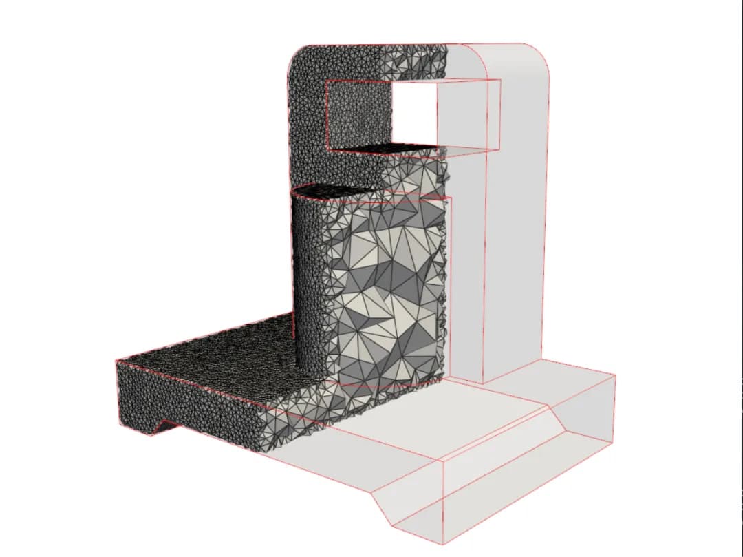

Example: Read stl and divide tetrahedral cells, use pyvista to visualize.
import tetgen
sphere = pv.read('test.stl')
tet = tetgen.TetGen(sphere)
tet.tetrahedralize(order=1, mindihedral=20, minratio=1.2)
grid = tet.grid
# Split the visualization grid
crinkled = grid.clip(normal=(1, 0, 0), crinkle=True) # profile
p = pv.Plotter()
stl_model = pv.read('test.stl') # original model as reference
p.show()
