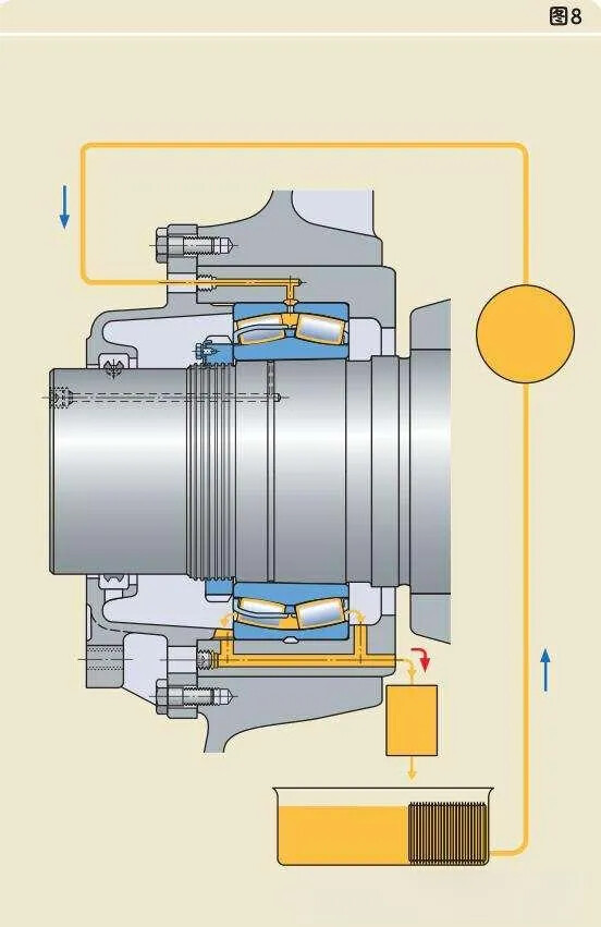

  1. Design Lubrication Points for Rotating Parts

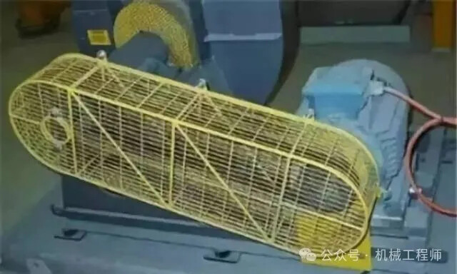

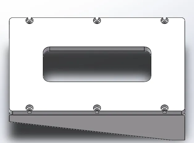

  2. Design Safety Covers for Rotating Parts (Include Observation Windows)

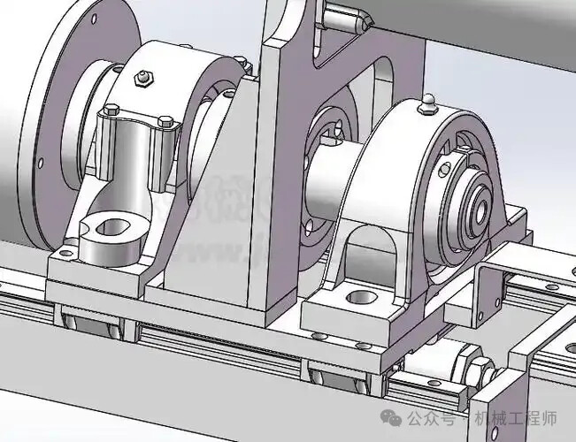

  1. Design Positioning and Load Adjustment Bolts for Bearing Housings

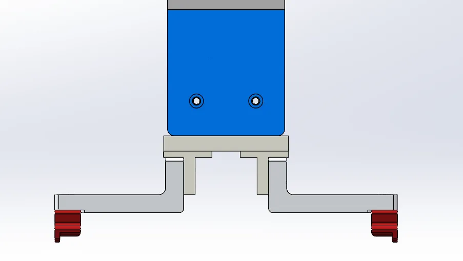

  5. Indicate Motion Range (Start and End Positions) and Trajectory for Moving Parts

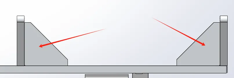

  7. Reinforce Load-Bearing Areas (e.g., Stiffeners) and Reduce Weight in Non-Load-Bearing Areas (e.g., Weight Reduction Holes)
  • Stiffeners: Enhance the strength and rigidity of specific areas to withstand greater loads and stresses. Properly designed stiffeners can significantly improve structural load-bearing capacity and stability without increasing overall material usage.
