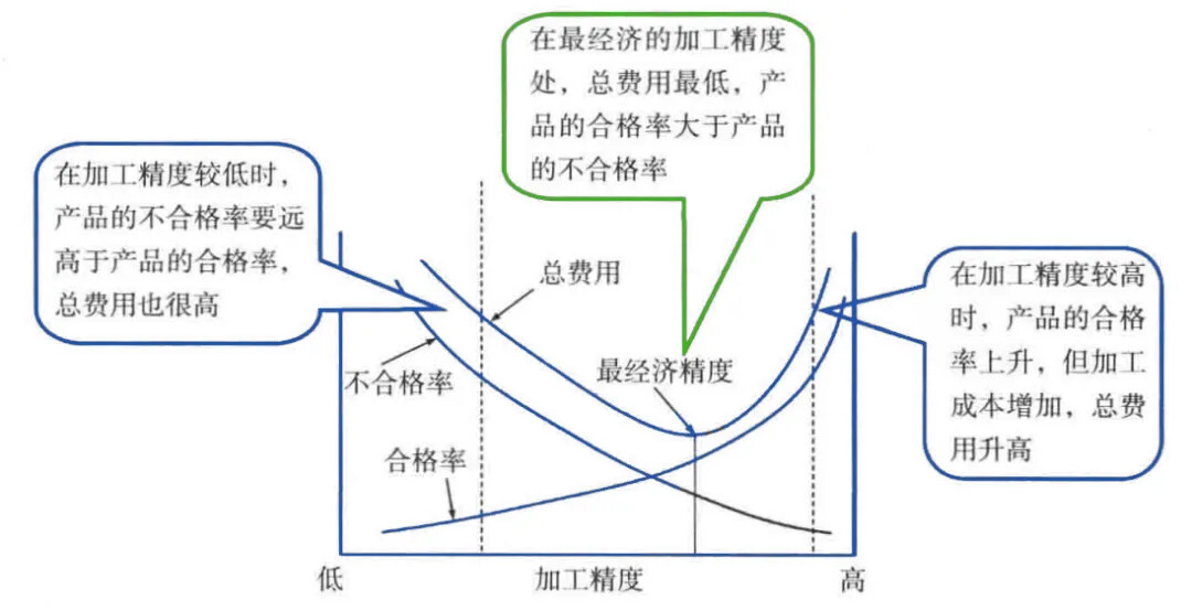

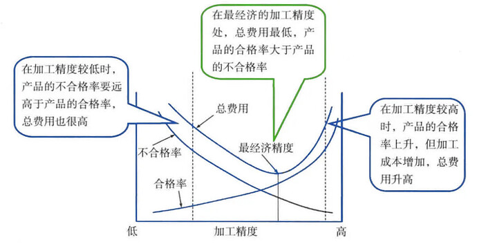

Economic precision refers to selecting the lowest-cost and suitably precise machining standards while meeting usage demands to maximize benefits. Therefore, the formulation of process guidelines must consider economic precision. Figure 1 illustrates the relationship between machining precision, defect rates, and economic viability, where the point with the lowest total cost represents the most economical precision.
Figure 1: The Relationship Between Machining Precision, Defect Rate, and Economic Viability

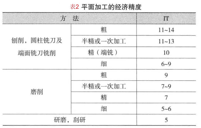

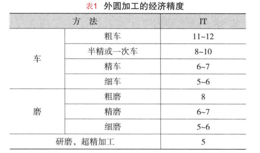

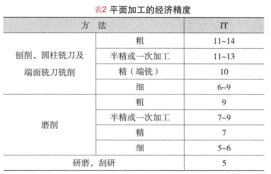

Economic precision in mechanical processing refers to the economically reasonable range of the average deviation between the surface dimensions of a part and its nominal dimensions under conventional production conditions. The achievable economic precision varies among different machine tools under normal conditions, and this range defines their economic precision.
