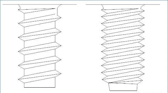

Machine Threads: When assembling, a hole is drilled and tapped in the assembly item, matching the internal threads with the external threads of the screw, allowing for assembly with lower torque.
Self-Tapping Threads: A hole is drilled in the assembly item without the need for internal threads, using higher torque for assembly.

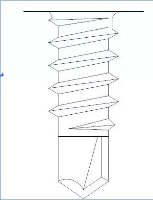

Self-Drilling Threads: Used directly on the assembly item, the screw drills and taps in one step.

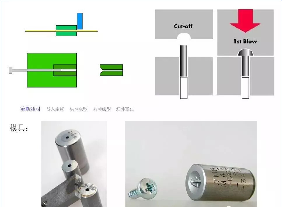

- Forging:
- Deforms material under external pressure to achieve the desired shape.
- Advantages: Fast production speed, low cost, suitable for mass production.
- Disadvantages: Forming is limited by molds, and complex molds can be costly.

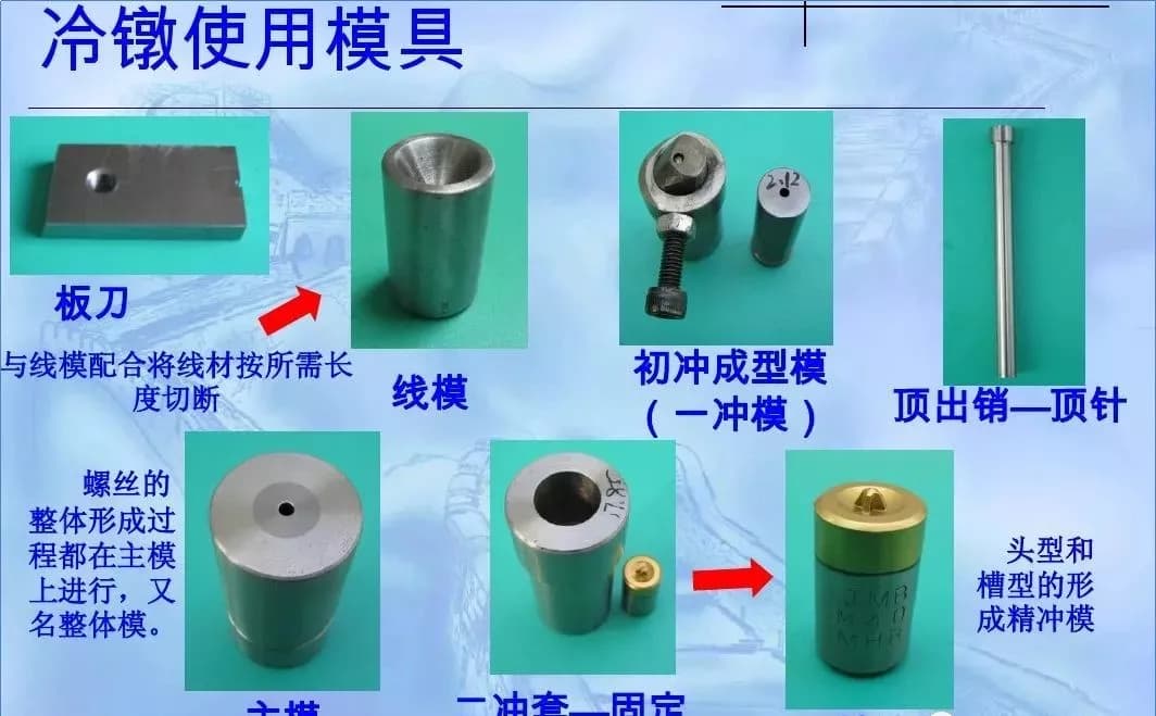

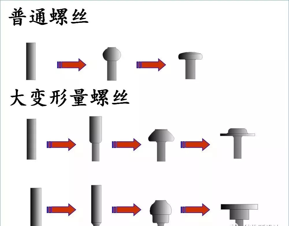

- Cold Heading:
- A process where metal wire is deformed using molds under no heat, a type of forging.

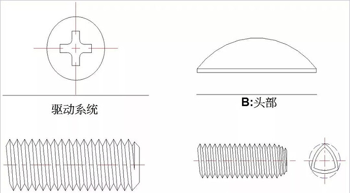

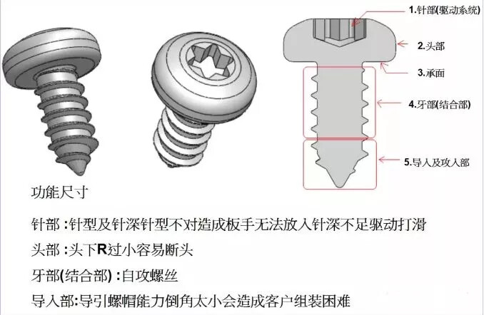

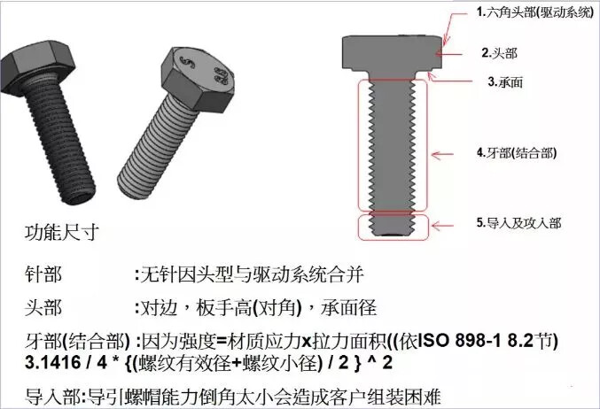

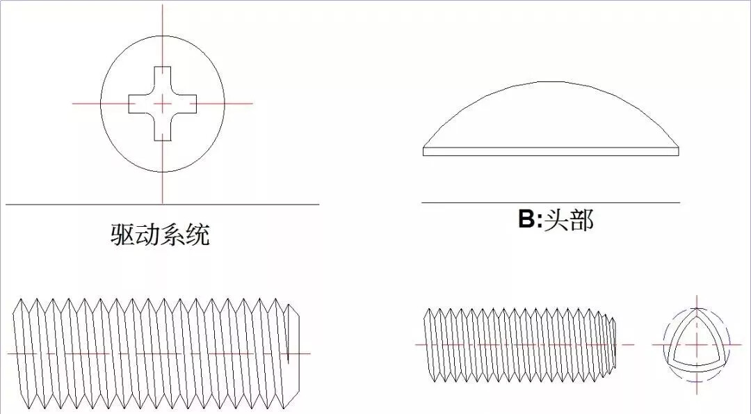

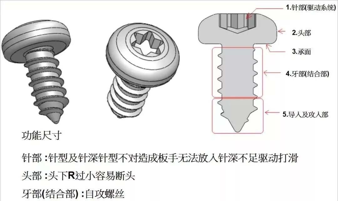

Basic Screw Configuration
To understand screws and bolts, one must know their types, features, and functions:
- A: Drive System
- B: Head
- C: Thread Profile Junction
- D: Lead-in and Threading Section

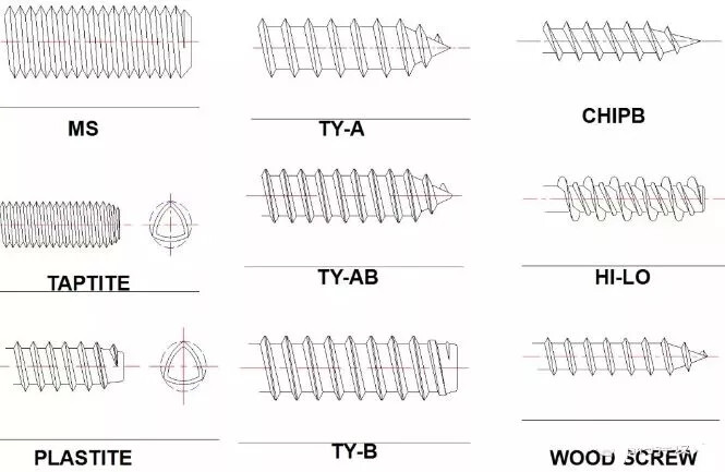

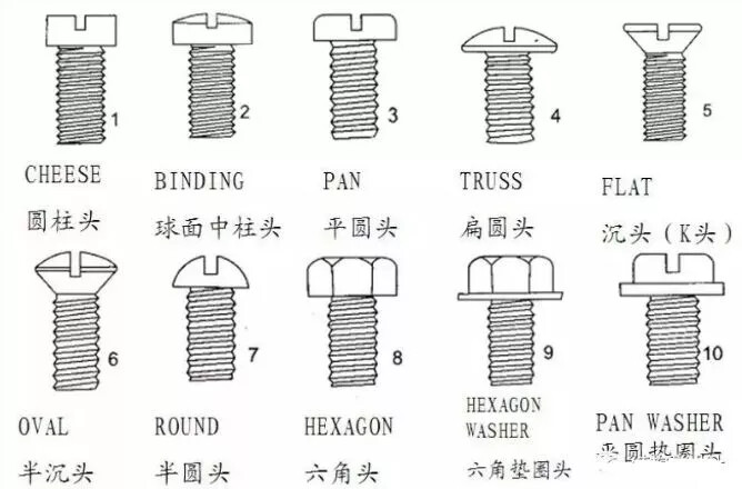

Types of Screws
Mechanical Thread Screws
Self-Tapping Screws
Triangular Thread Screws
Screw Head Types and Thread Profiles

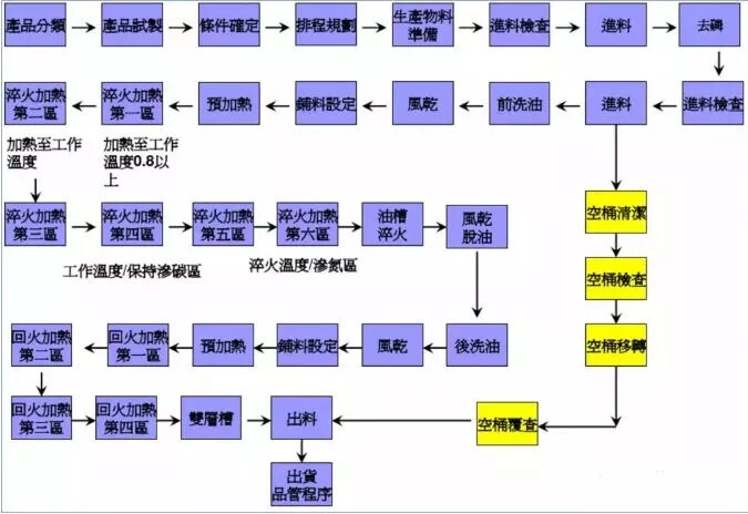

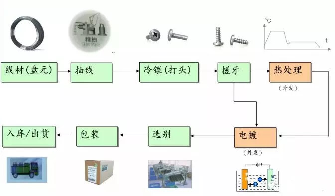

Process Flow for Screws
The general process flowchart is as follows:

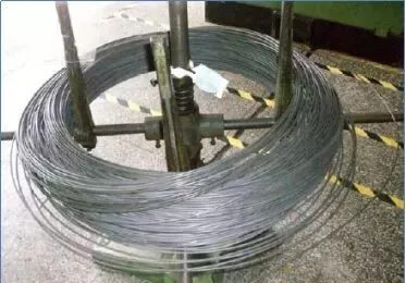

- Raw Material Process:

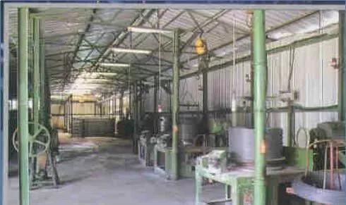

- Refers to the original coils purchased from the manufacturer, including parameters like brand, name, specification, material, furnace or batch number, and quantity or weight. Major chemical components of carbon steel coils include C, Mn, P, S, Si, Cu, Al, with lower contents of Cu and Al being preferable.
- Drawing Process:
- Achieves the desired wire diameter (e.g., drawing to 3.5mm).

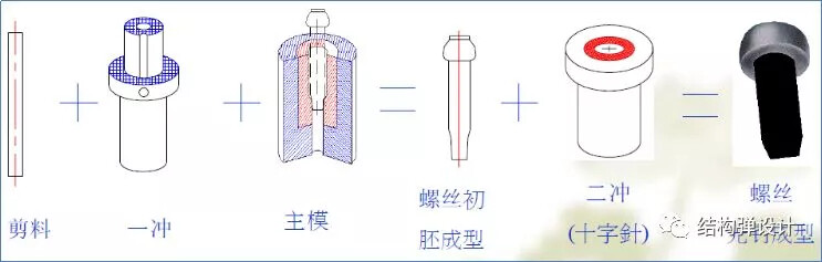

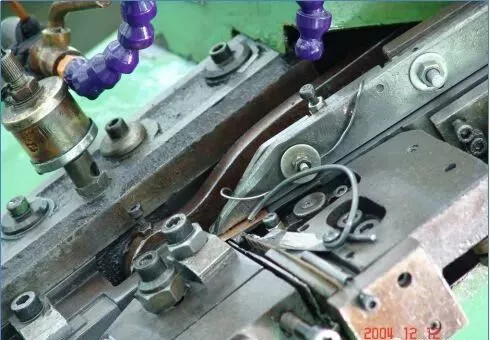

- Cold Heading Process:
Forms the screw blank through the interaction of molds, cutting the wire to shape the head, cross slot (or other head types), thread blank diameter, and rod length, including the radius under the head.
Note: Designs can be customized based on customer requirements. Common head types include P-head, B-head, F-head, T-head, with common slots being Phillips, slotted, and hex.

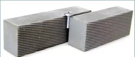

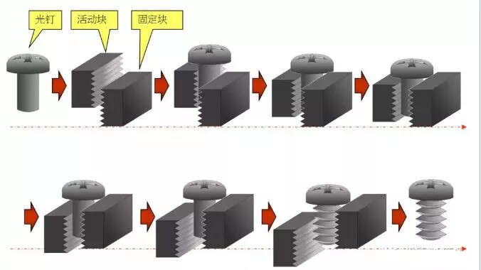

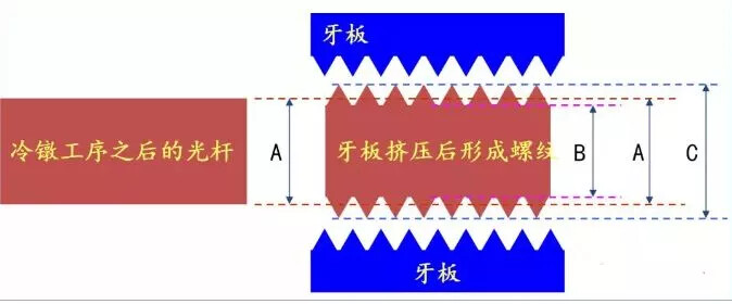

- Thread Rolling Process:
- Forms threads on the cold-headed blanks through the interaction of movable and fixed thread plates.
- Heat Treatment Process:
Purpose: To achieve higher hardness and strength after cold heading.
Function: Enhances the self-tapping characteristics of metal, improving mechanical properties like torsion, tensile strength, and wear resistance.
Types:
Annealing (700°C x 4hr): Alters the structure to obtain a regular polygon shape.

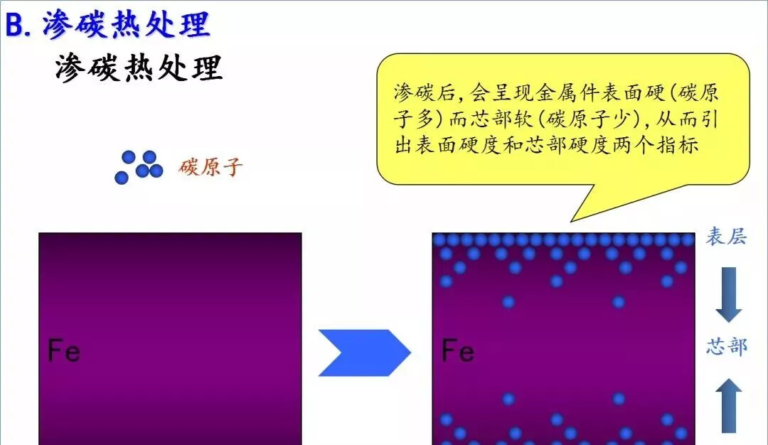

Carburizing Heat Treatment: Adds carbon to improve surface hardness, especially for low carbon content metals.
Quenching and Tempering: Changes internal structures through temperature variation to achieve better mechanical performance.

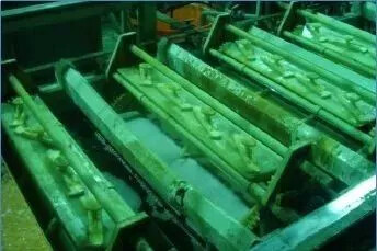

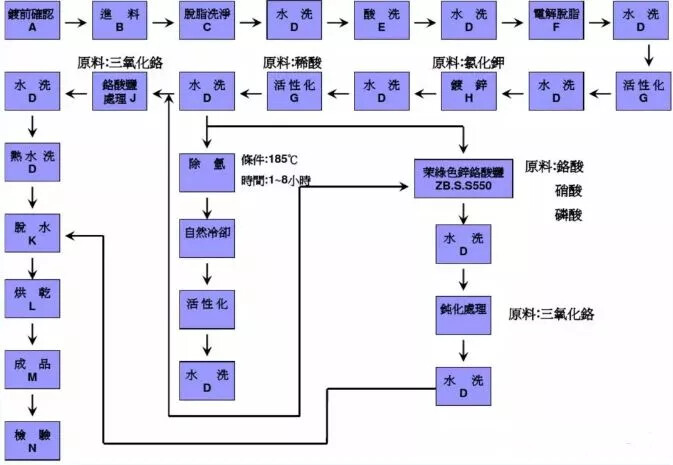

- Electroplating Process:
- The finished product surface can exhibit desired color effects and anti-oxidation coatings.
