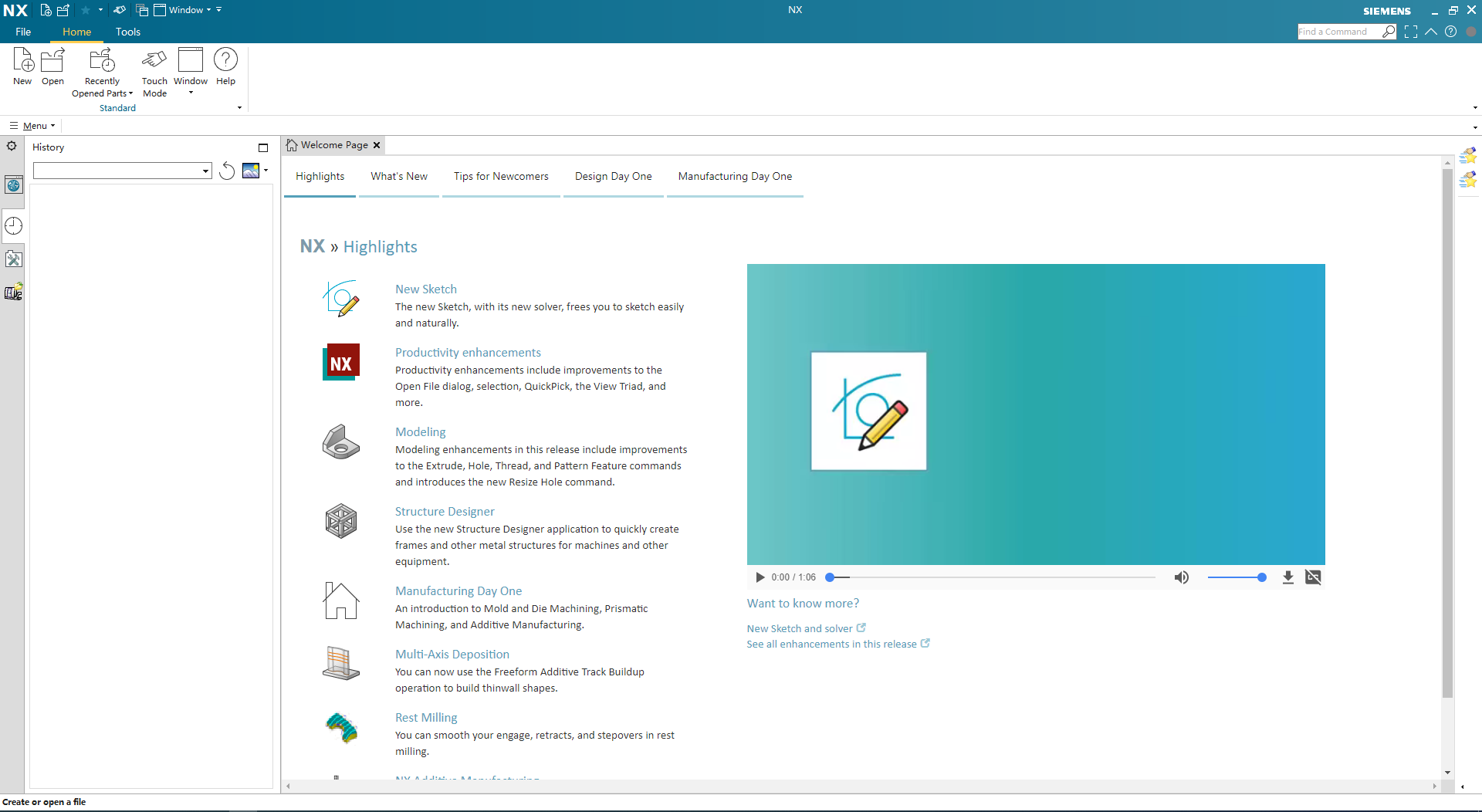

In NX UG, the Welcome Page /Discover center opens every time the software is launched. Is there a way to turn off the Discovery Center?
2024-11-09T23:48:00Z
You can use this method to close them:
set an environment variable:
Variable name:
UGII_DISCOVERY_CENTER_PAGE
Variable value:
NO_AUTO_DISPLAY
Cool
, it works!!!
