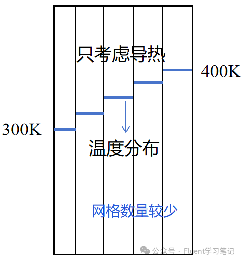

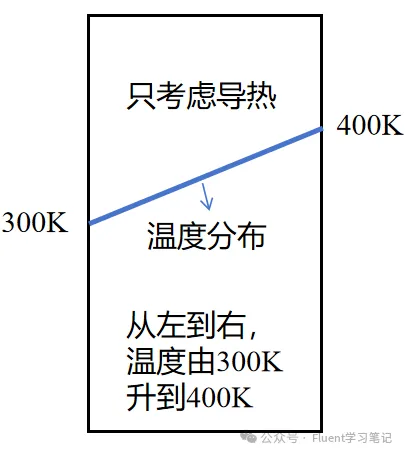

Example: Rectangular Model

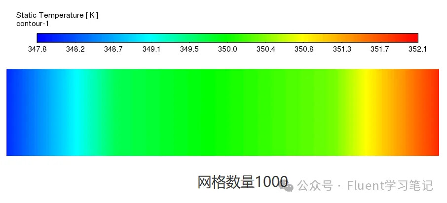

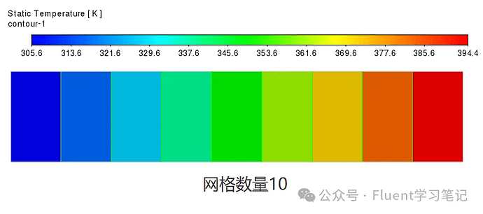

For a rectangular model where the left and right walls are at 300K and 400K respectively, the true temperature distribution along the model should be linear under heat conduction.
Coarse Grid
 With just a few grids, the temperature distribution appears very rough and clearly deviates from the true distribution.

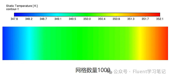

Fine Grid
 When the number of grids increases to 1,000, the temperature distribution becomes continuous, and the calculation is more accurate.

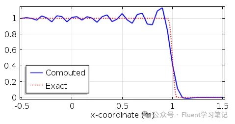

Gradient Capture Capability

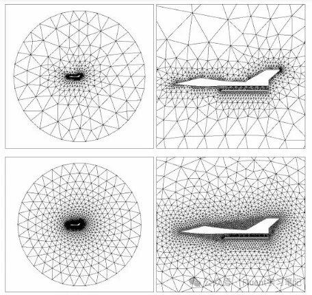

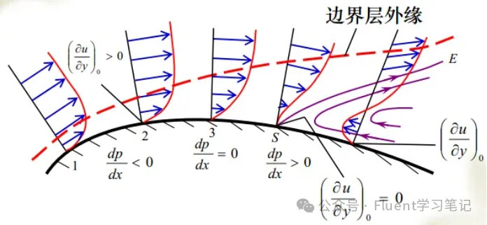

Another reason is the gradient capture capability. In flow fields, especially in regions with sharp variations (e.g., boundary layers, shockwave regions), fine grids are necessary to capture detailed variations. Increasing the grid density can better describe these changes, thus improving simulation accuracy. Coarse grids smooth these areas, leading to errors.
This is also comparable to image resolution. Areas with rich colors and more details require higher resolution, while areas without scenery can use lower resolution.
Similarly, in grid density, regions like boundary layers with high physical gradients require finer grids. Even with the same number of grids, differences in grid detail in these specific regions can result in discrepancies in results.

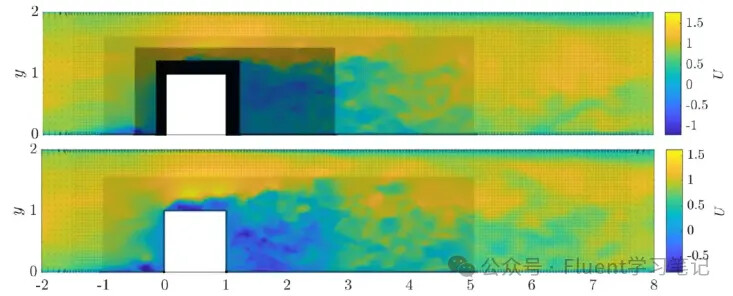

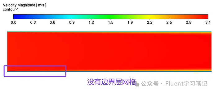

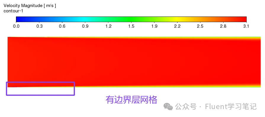

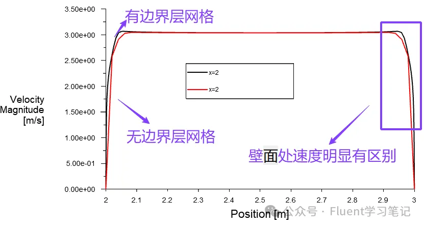

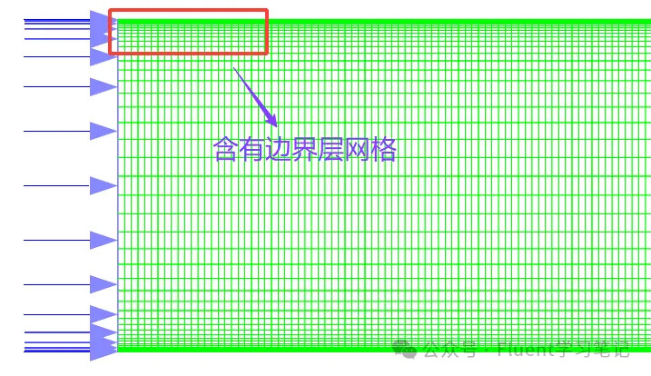

Example: Circular Pipe Flow
For flow inside a circular pipe where the main flow velocity is 3 m/s, most regions inside the pipe should have a velocity of 3 m/s. Near the wall, however, the presence of a boundary layer causes a large velocity gradient. The number of grid layers and grid sizes used in the boundary layer will affect the detailed velocity profile.
Without Boundary Layer Grids
 Velocity distribution near the wall differs significantly.
With Boundary Layer Grids
 Detailed velocity gradients are accurately captured.

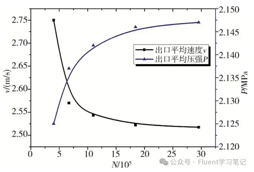

- Calculate the rate of change in results after each refinement. When relative changes are within a certain error range, grid independence is achieved.
Two Common Comparison Methods
Comparing average values across the entire computational domain.
Comparing values at specific regions or monitoring time-varying results.
4. Determine the Optimal Grid
- Once results stabilize, the current grid is deemed optimal.
- Record the grid density and refinement parameters for future use. The optimal grid balances accuracy and computational efficiency.

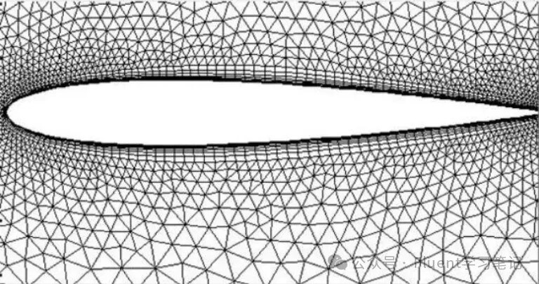

5. Key Points for Grid Independence Verification
Grid Type Selection - Use hybrid grids for complex geometries and structured grids for simple ones.
Boundary Layer Grids - Refine boundary layer grids to ensure accuracy near walls, especially in regions with high gradients. Gradual refinement ensures consistency.
