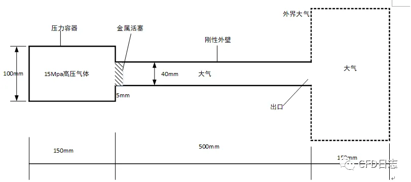

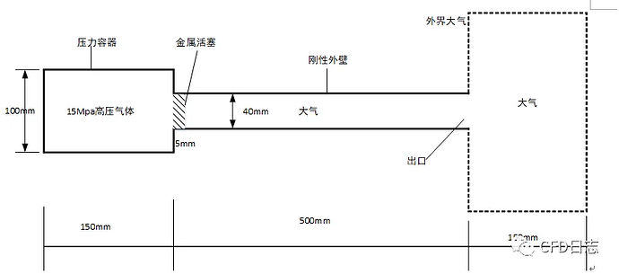

The high-pressure gas inside the pressure vessel has a pressure of 15 MPa. The gas pushes a metal piston (with a width of 5 mm) to move within a rigid pipe, from the outlet to the surrounding atmosphere.

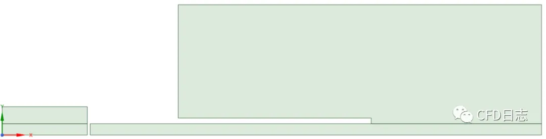

2. Geometric Model

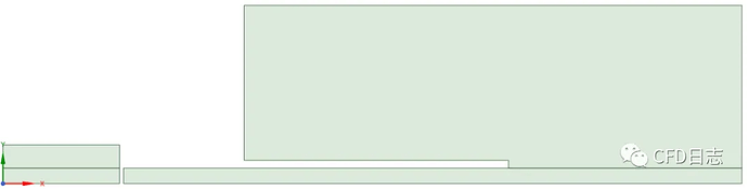

A two-dimensional geometric model was created using SCDM, as shown in the figure below. The geometry is simplified to a 2D symmetrical problem to reduce the computational effort.
Figure: Geometric Model
Note: The computational domain is divided into several parts for ease of dynamic mesh setup.

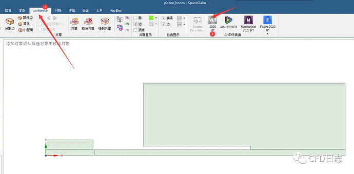

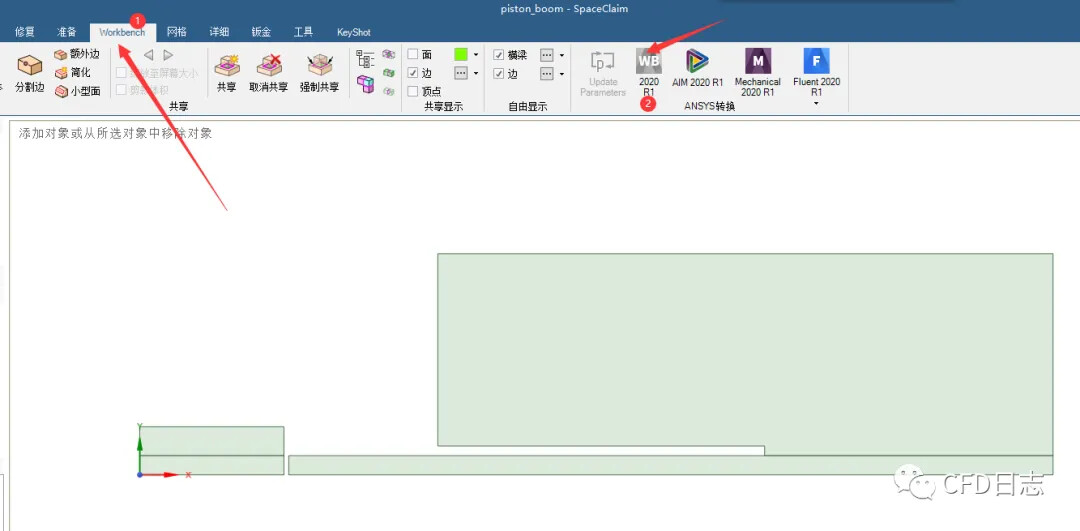

  • Import the geometry from SCDM into Workbench. In the main menu, select the Workbench tab, then click on WB 2020 R1 to transfer the model into Workbench, as shown below.
Figure: Import Geometry to Workbench

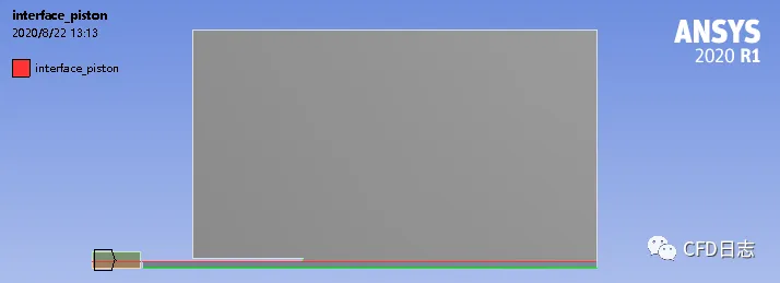

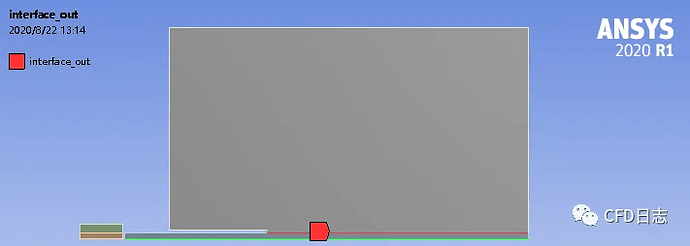

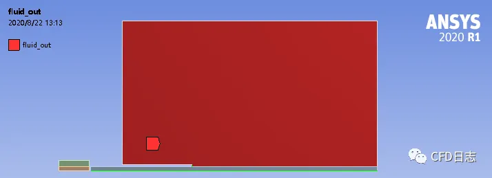

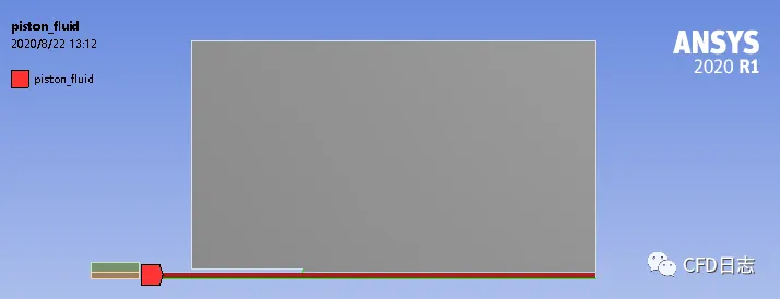

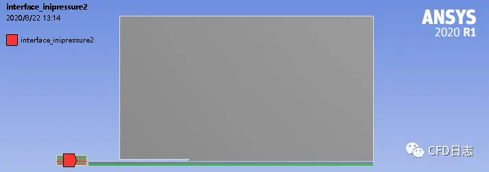

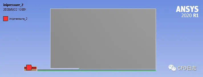

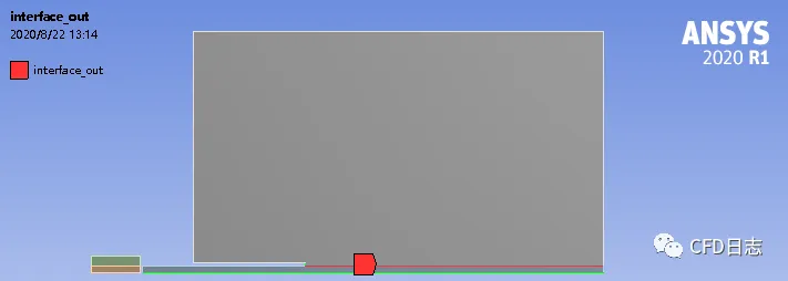

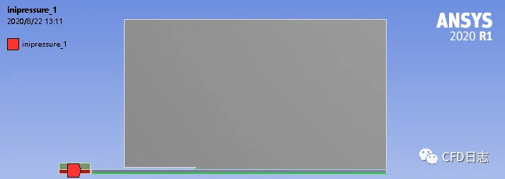

  • Name the fluid domains and boundaries. The four fluid domains include: inipressure_1, inipressure_2, piston_fluid, and fluid_out. The four solid boundaries include: piston, top, out, and out2. The three interfaces between fluid domains are: interface_piston, interface_out, and interface_inipressure2. There is also a symmetry boundary symm. Some of these are shown in the images below.
Figure: inipressure_2
Figure: inipressure_1
Figure: piston_fluid
Figure: fluid_out
Figure: interface_piston
Figure: interface_out
Figure: interface_inipressure2

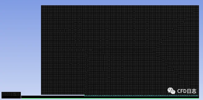

  • Mesh Generation: The mesh size in the region traversed by the piston is 2 mm, while the mesh size in other fluid regions is 4 mm. The final mesh is shown in the figure below.
Figure: Mesh Generated
  • Save the mesh in Fluent format.

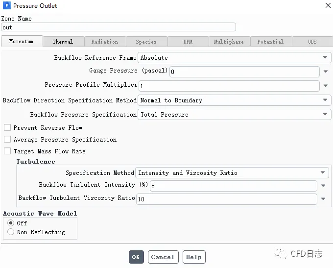

4.2 Boundary Conditions
The outlet boundaries out and out2 are set as pressure outlets, as shown in the figure below.
Figure: Outlet Boundary Conditions

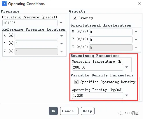

4.3 Operating Conditions
Click on the main menu bar, select Physics → Zones → Cell Zones, and set the operating conditions in the popup window as shown below.
Figure: Operating Conditions Setup

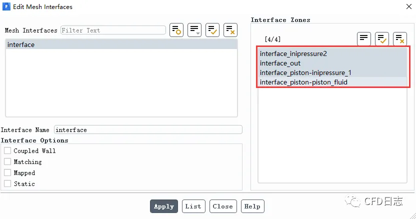

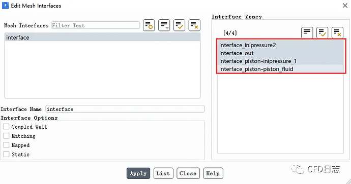

4.4 Interface Settings
Manually set the interface between fluid domains as shown in the figure below.
Figure: Interface Setup

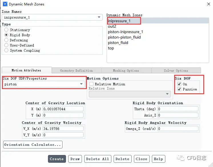

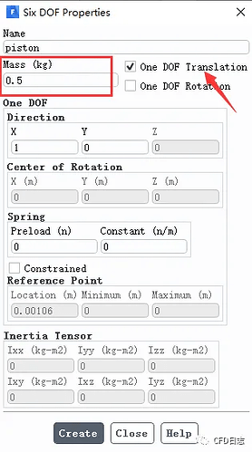

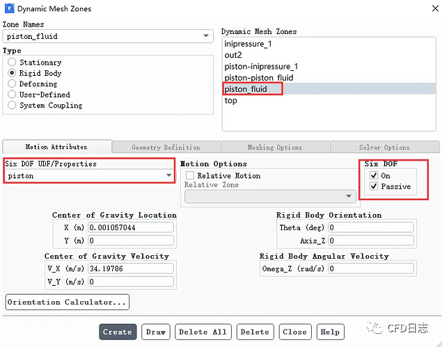

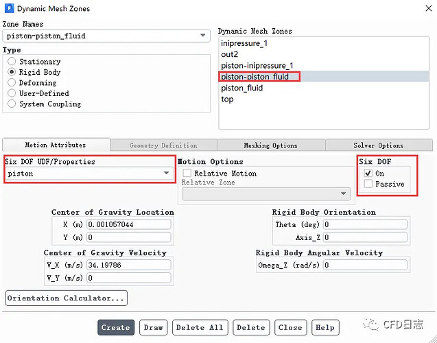

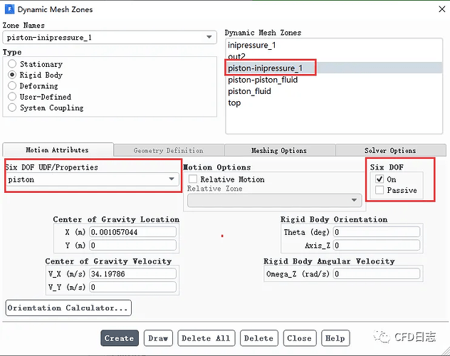

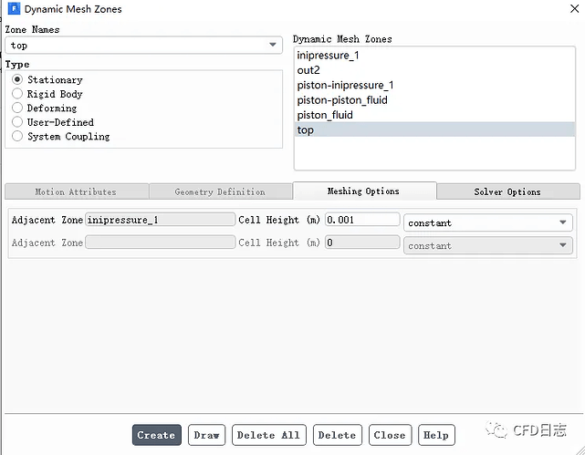

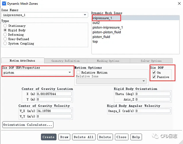

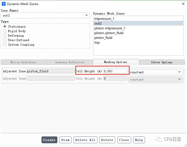

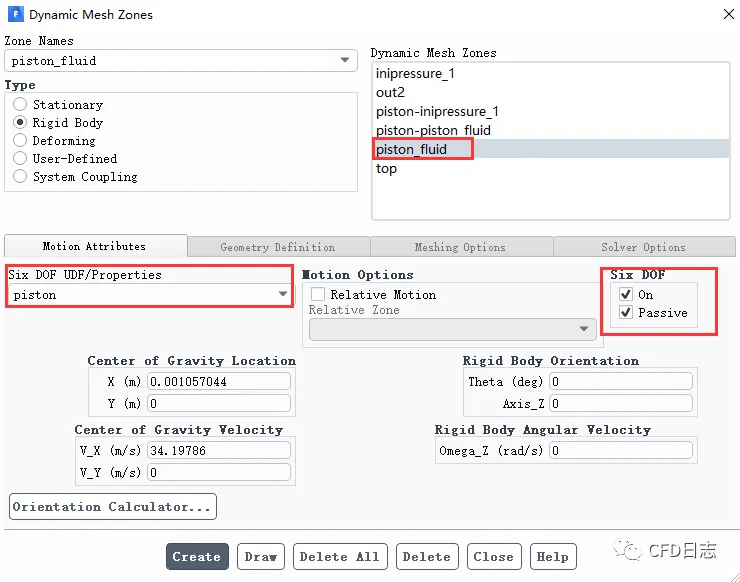

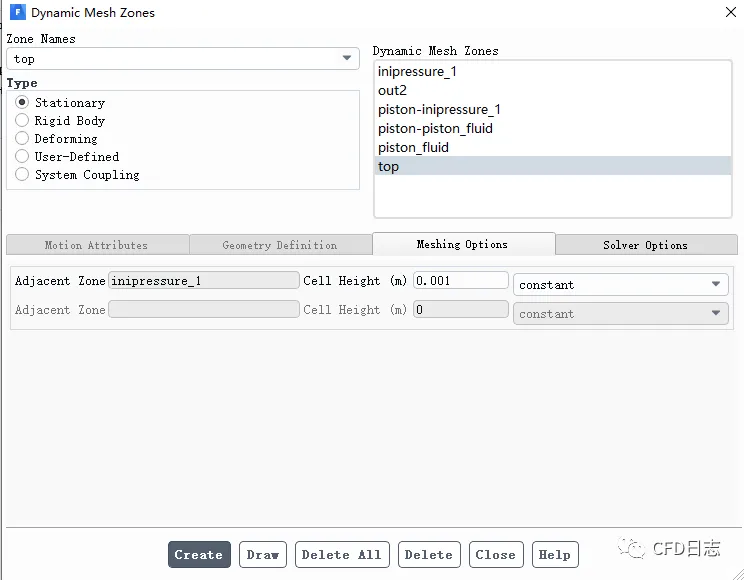

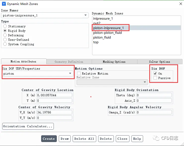

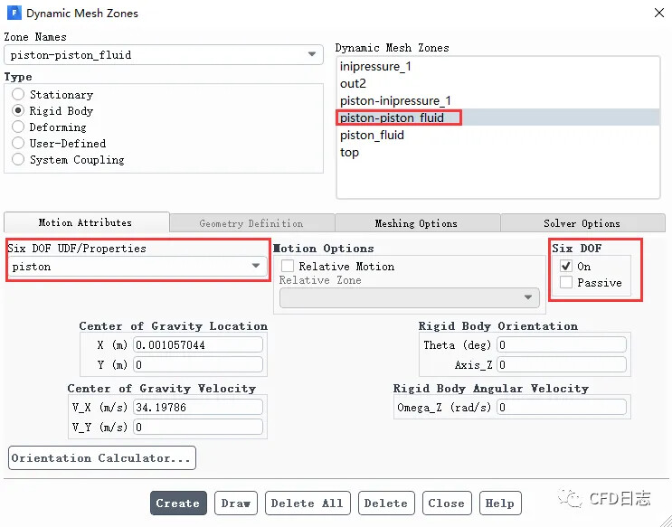

4.5 Dynamic Mesh Settings

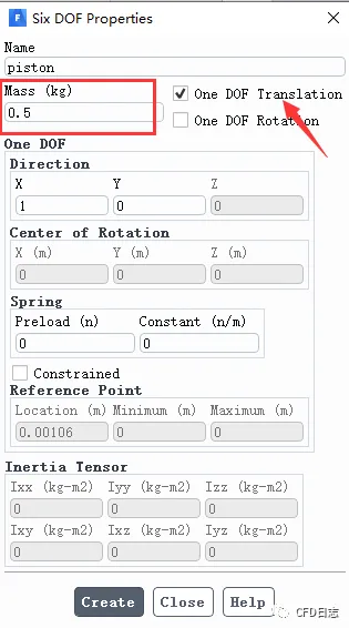

Double-click on the Dynamic Mesh in the model tree to enable Layering and Six DOF, and create the Six DOF properties as shown below.
Figure: Six DOF Settings

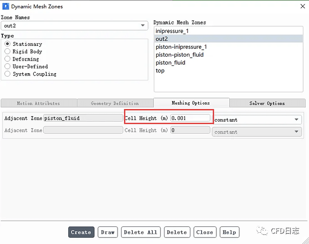

  • The dynamic mesh regions and their parameter settings are shown in the images below.
Figure: piston-inipressure_1
Figure: piston-piston_fluid
Figure: out2
Figure: top

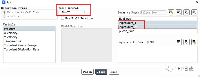

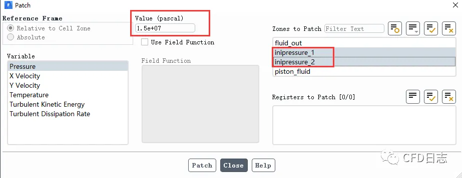

4.6 Initialization
Use the standard format for initialization, then set the patch as shown in the figure below.
Figure: Initialization of High-Pressure Region

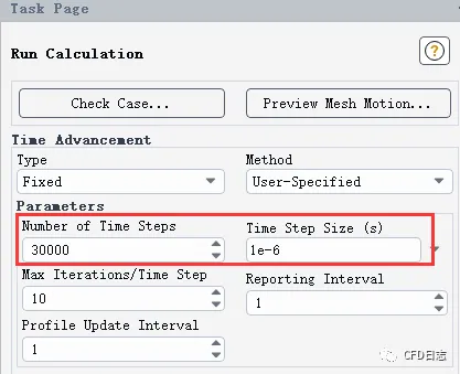

4.7 Calculation Settings
The calculation settings include the total number of time steps and the time step size, as shown in the figure below.
Figure: Calculation Settings

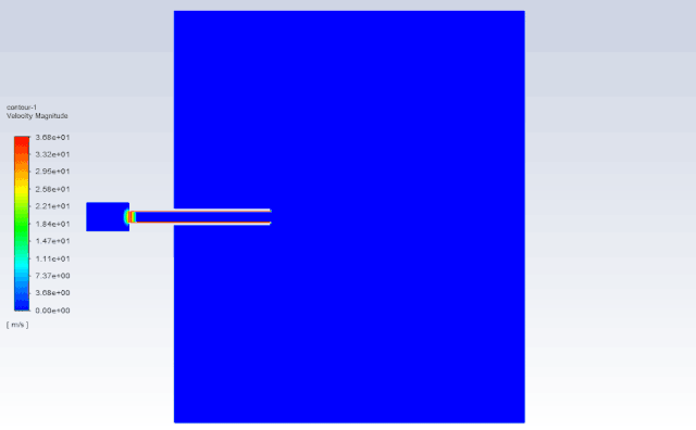

5. Result Analysis
An animation is provided, concluding the process.
640 (3)
Figure: Result Animation
