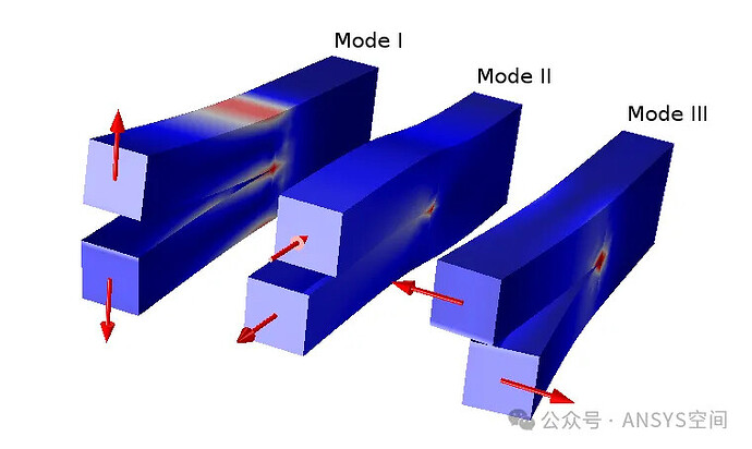

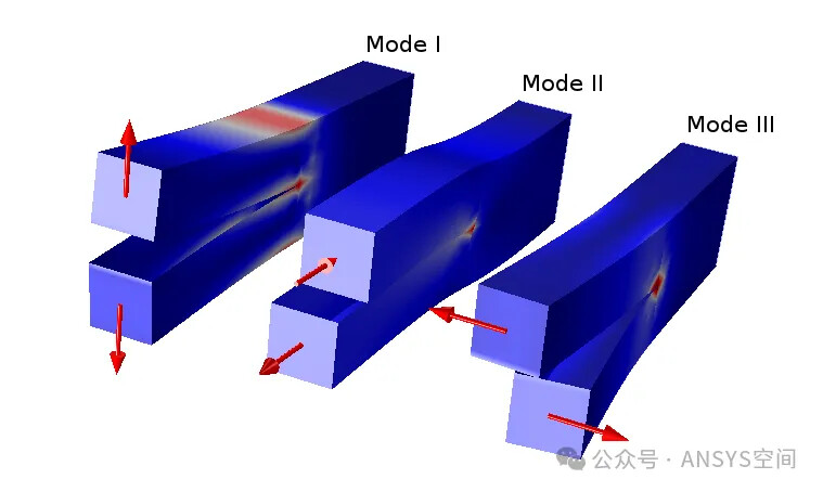

3. Classification of Stress Intensity Factors
  • Mode I: Opening Mode (KI) – Also known as tensile or opening mode, it is the most common crack propagation mode. Under Mode I, the tensile stress perpendicular to the crack surface causes the crack to open. According to Griffith’s theory, when the Mode I Stress Intensity Factor KI​ reaches the material’s fracture toughness KIc​, the crack will begin to propagate.
  • Mode II: Sliding Mode (KII) – In Mode II, sliding or shear stress causes the crack surfaces to slide relative to each other. The direction of crack propagation is perpendicular to the shear force at the crack tip.
  • Mode III: Tearing Mode (KIII) – In Mode III, or anti-plane shear, the crack surfaces slide along the crack front under shear force. The crack propagation direction aligns with the shear force at the crack tip.
Mode I fracture is the most critical and is thus the primary focus in engineering.

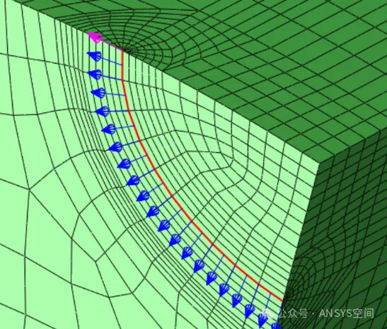

4.2 Finite Element Method (Recommended)
The Finite Element Method (FEM) is a numerical approach that discretizes a structure into a finite number of small elements, approximating stress and displacement distributions within each element to solve for SIF. Currently, software like ANSYS supports SIF calculations for various crack models in both 2D and 3D structures.
  • Applicable Conditions: FEM is suitable for complex geometries and load conditions, including non-planar cracks, non-homogeneous materials, and variable boundary conditions.
  • Calculation Process: First, create the structure’s geometric model and apply mesh division. Then, select appropriate element types and material properties to construct the finite element model. By solving the finite element equations, obtain stress and displacement at each node. Finally, calculate the SIF using specific techniques, such as the J-integral method or crack closure technique.
  • Pros and Cons: FEM offers high versatility and can handle various complex engineering problems. However, it requires significant computational resources, and result accuracy depends on mesh density and quality.
