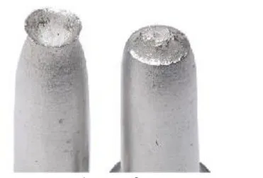

1. Definition and Characteristics of Plastic Fracture
Plastic fracture, also known as ductile fracture, refers to the fracture process in which significant macroscopic plastic deformation occurs before the fracture. This type of fracture typically occurs under conditions above the material’s yield strength. Compared to brittle fracture, plastic fracture absorbs more energy during the process and is a form of high-energy fracture. In plastic fracture, the material’s fracture toughness is relatively high, so there is often noticeable plastic deformation before fracture, absorbing a significant amount of energy.

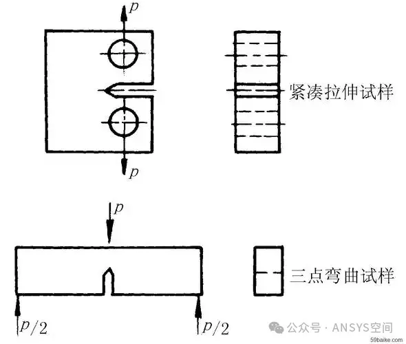

Experimental determination of the J-integral typically involves crack propagation experiments, such as Compact Tension (CT) tests or Three-Point Bending (3PB) tests. During the experiment, the displacement field and load response at the crack tip are measured to calculate the J-integral. The steps include:
- Design and fabricate standard specimens.
- Apply loading and record the load-displacement curve.
- Measure the displacement field at the crack tip using techniques like Digital Image Correlation (DIC).
- Use the experimental data to calculate the J-integral.
