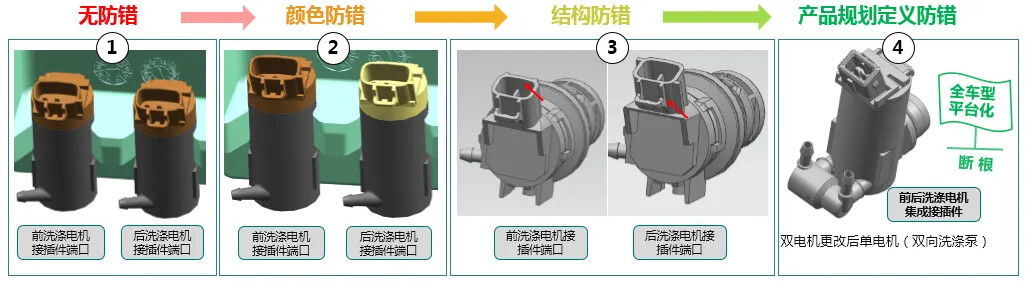

For example, in the design of a windshield washer system, the front and rear washer motors were difficult to distinguish by appearance and color. To solve this issue, color coding and structural error prevention measures were implemented. Eventually, a new model was introduced that combined the connectors for both motors into one, allowing for the installation of only one motor. This change led to a reduction in the defective installation rate from 10% to 0% and improved assembly efficiency by 30 seconds.

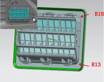

Many times, a component with a regular shape, such as square or circular parts, may not be easily distinguishable at a glance when assembled onto another component, which can lead to incorrect assembly. For instance, the design of a certain vehicle’s vent component exhibited similar top and bottom shapes, which often resulted in reverse assembly during actual assembly. To address this, the design engineer modified the radius dimensions at the arrowed areas, preventing the part from being inserted incorrectly into the metal casing. This change reduced the defective installation rate from 10% to 0%, and subsequent models adopted this error prevention feature with excellent results.
In cases like this, structural engineers should strive to incorporate clear error prevention design features. Non-symmetric ribs, holes, grooves, and protrusions are common features that help prevent errors. The more pronounced these features are, the better they serve their purpose.

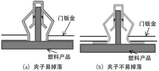

After installing a metal clip on a plastic component that must be secured to a door panel, frequent disassembly for maintenance can lead to detachment of the metal clip from the plastic. If the metal clip is poorly designed, it may fall into the door panel and become difficult to retrieve. The following illustration shows the difference between a metal clip that is prone to falling and one that is securely designed.
