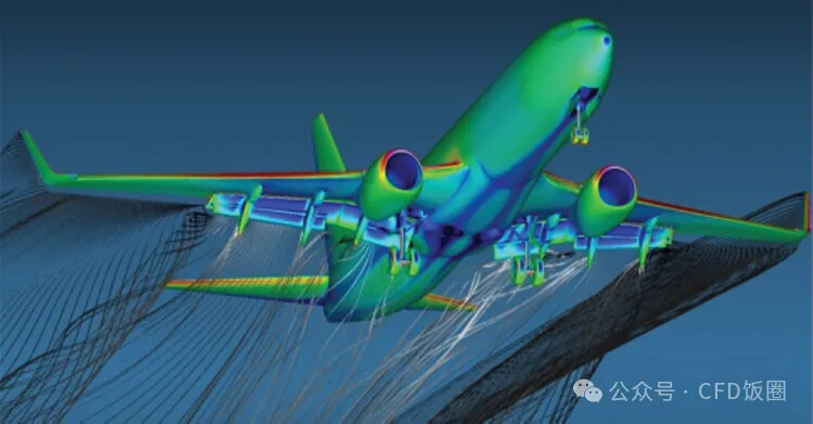

1. The Importance of CFD in the Aerospace Industry
The review highlights the critical role of CFD in aircraft design and analysis, such as reducing design rework and ensuring that aircraft meet target and safety standards. It provides examples of how the Boeing 777 and 787 have benefited from CFD technology and how CFD has become a complementary tool to wind tunnel testing:

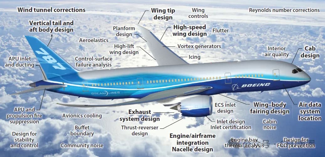

1.2 Boeing 787
  • Widespread CFD Use: By the time the Boeing 787 was designed, CFD technology had matured enough to be applied across a broader range of aircraft design areas. The review highlights CFD’s contributions to cabin noise, inlet design, regional noise, stability, and control design.
  • Multidisciplinary Optimization: The application of CFD extends beyond single domains, providing optimization solutions across various aspects of aircraft design.

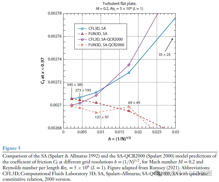

2.1 Verification and Validation (V&V)
The review emphasizes the importance of the verification and validation (V&V) process for CFD tools to ensure their reliability and effectiveness. Verification confirms that numerical algorithms are implemented as intended through code reviews and benchmarking, ensuring the correctness of CFD model implementations. Validation focuses on whether the model accurately replicates real-world observations, comparing CFD predictions with wind tunnel and flight test data, and assessing the influence of different mesh resolutions on predictions. Modern V&V processes increasingly emphasize uncertainty assessments of data, including both experimental data and CFD predictions. The literature notes that for CFD data to replace other data sources, V&V demonstrations must be conducted on real configurations rather than standard cases. Furthermore, high-quality multidisciplinary validation data is crucial for achieving certification based on analysis (CbA). Therefore, V&V is not only a critical step in the development of CFD technology but also foundational for building confidence in CFD applications in design, analysis, and certification.
To ensure the reliability of CFD tools, the industry has adopted measures such as stringent V&V processes, process automation, modular workflows, documentation, and continuous investment and research.

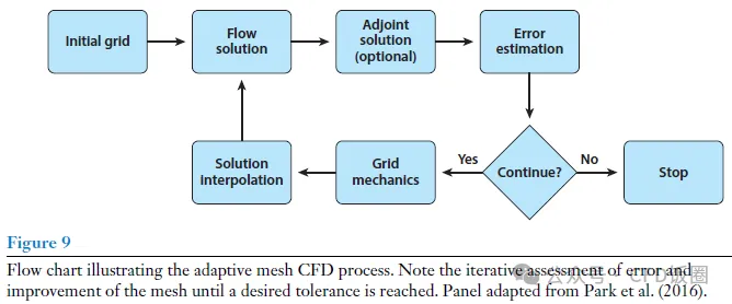

2.3 Mesh Adaptivity
The review addresses advancements in mesh adaptivity techniques, which optimize computational resource allocation by dynamically adjusting mesh density based on the characteristics of the flow field, thus improving the accuracy of CFD solutions while maintaining computational efficiency. By automatically refining the mesh to capture critical features in the flow field, such as shock waves, boundary layers, and detached flow regions, mesh adaptivity techniques enable CFD simulations to predict flow characteristics more accurately, particularly in complex flow and geometry scenarios, which is vital for aerospace design and analysis.

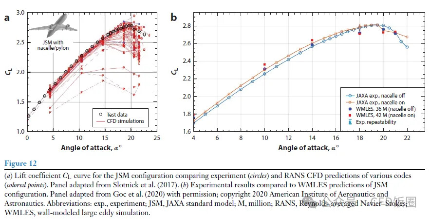

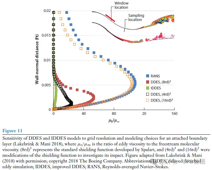

2.5 Turbulence Models
The review delves into various methods for addressing turbulence effects in CFD simulations, focusing particularly on Reynolds-averaged Navier-Stokes (RANS) models and hybrid RANS/Large Eddy Simulation (LES) models, including both steady-state and transient simulations. RANS models are extensively discussed due to their widespread application in industry, especially for their effectiveness in handling attached flows and small-scale separations, while also noting their limitations in addressing large separations. Additionally, the literature examines hybrid RANS/LES models, which combine the efficiency of RANS models with the ability of LES models to capture large-scale turbulent structures, although these hybrid models still face challenges in dealing with near-wall regions and mesh resolution. These discussions underscore the ongoing importance of research and improvement in turbulence models within the aerospace domain.
