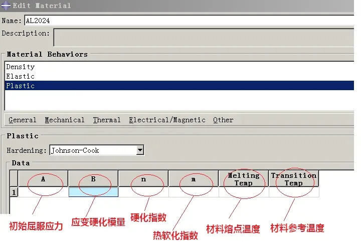

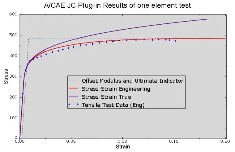

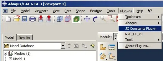

If we have determined the parameters A, B, and n, we can input the corresponding Johnson-Cook parameters in Abaqus. The key point is that, given the elastic modulus, Poisson’s ratio, yield stress, and ultimate strength of a material, we can use the JC plugin to automatically calculate parameters A, B, and n. Below is the stress-strain curve for aluminum alloy AL2024 obtained using the JC plugin.
