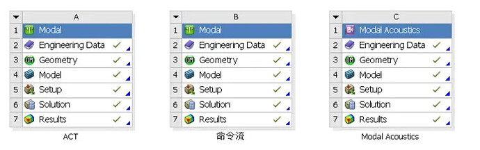

In the newer versions of ANSYS, the Modal Acoustics module is included for acoustic modal analysis. This article will utilize that module for analysis.

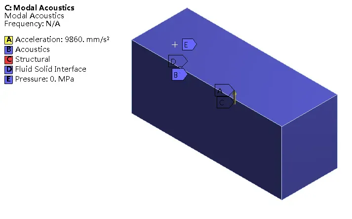

  1. Define Acoustic and Physics Regions:
  • In ANSYS Mechanical, designate the fluid domain as the Acoustics Region. This allows the software to apply the appropriate acoustic properties during the analysis.
  • Set the solid domain (submarine structure) as the Physics Region, enabling the analysis of the structural responses.
  1. Fluid-Solid Interface:
  • Identify the submarine’s surface as the Fluid Solid Interface. This interface facilitates the interaction between the fluid and solid domains, allowing for accurate modeling of the coupling effects.
  1. Apply Pressure Load:
  • On the surface of the fluid domain, apply a pressure load constraint. This simulates the effects of underwater pressure on the submarine’s surface, which is critical for accurately analyzing the wet modes and the resulting acoustic field.

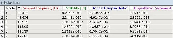

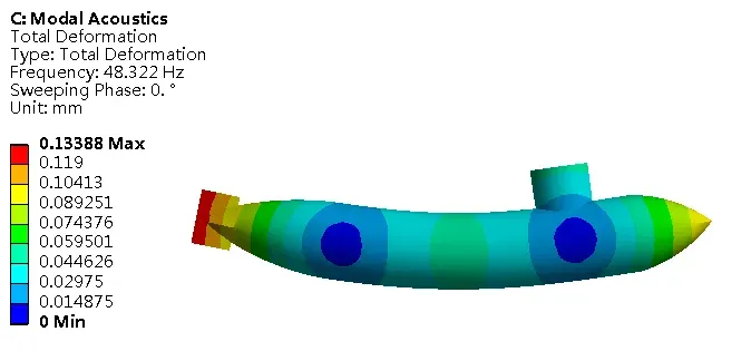

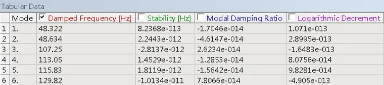

The modal results and mode shapes obtained using the Modal Acoustics module for acoustic modal analysis are as follows. Excluding the rigid body modes, the first-order mode primarily exhibits bending vibrations.
