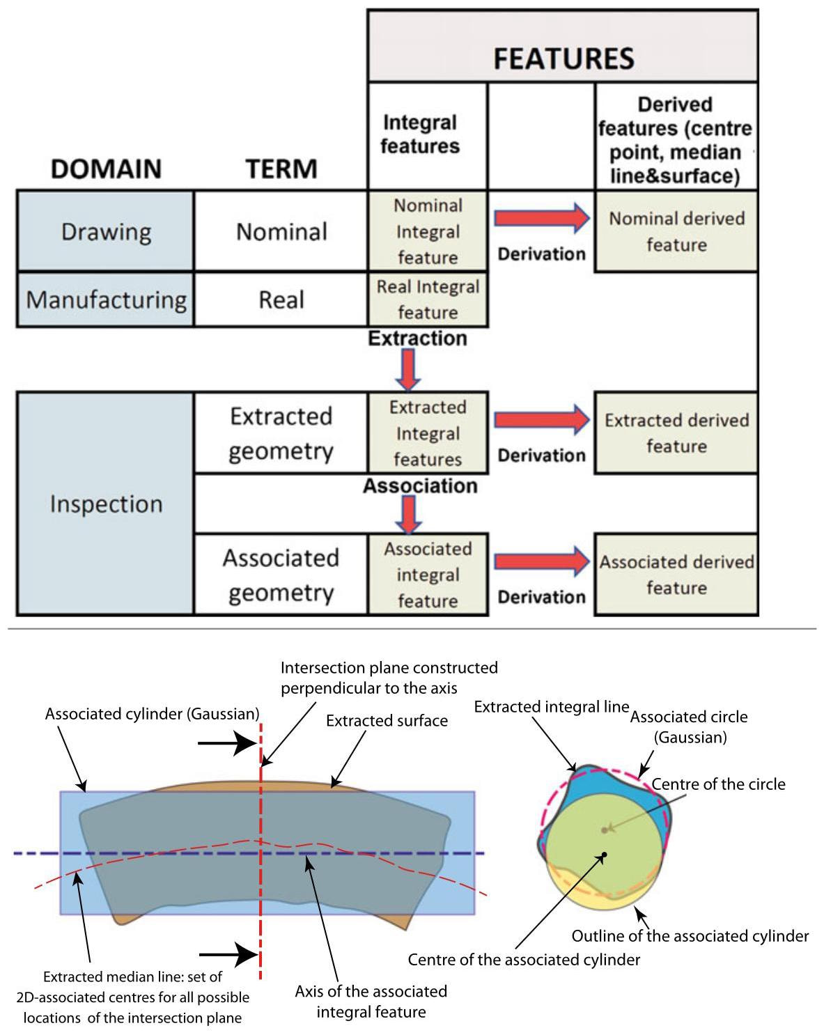

Table 2.1 shows some basic concepts of ISO 14660/1, which are often referred to in the ISO 17450/1 standard as the definitions of integral, associated and derived features.

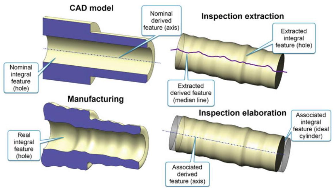

An integral feature is a geometrical feature that pertains to the real surface of a workpiece or to a surface model. An associated feature is an ideal feature that is established from a non-ideal surface model or from a real feature through an association operation. A derived feature is a geometrical feature that does not exist physically on the real surface of a workpiece, but which can be established from a nominal feature, an associated feature, or an extracted feature. The centre of a sphere is a derived feature obtained from a sphere, which is itself an integral feature. The median line of a cylinder is a derived feature that is obtained from the cylindrical surface, which is an integral feature (Fig. 2.1). The axis of a nominal cylinder is a nominal derived feature.
In metrology, through the use of a CMM measuring machine, the extracted feature (integral or derived, that is, an approximated representation of the real feature, which is acquired by extracting a finite number of points) is obtained from the real integral feature (Fig. 2.2). A perfect associated feature (a cylinder or the derived axis, which can be used, for example, as a datum) can thus be obtained from the extracted features.
Table 2.1 Relationship of the three domains and the feature types
Fig. 2.1 Illustration of the process adopted to build an extracted median line: an extracted median line is a set of 2D-associated centres
Fig. 2.2 The ISO 14660/1 standard provides terms that allow an engineer to understand the impact of the drawing specifications on inspection. A nominal integral feature is a theoretically exact feature that has been defined in a technical drawing. A nominal derived feature is an axis that has been derived from one or more integral features. Extracted and associated features are parts of the inspection domain. An associated integral feature is an integral feature of a perfect form associated with the extracted integral feature. An associated derived feature is an axis or centerplane of a perfect form.

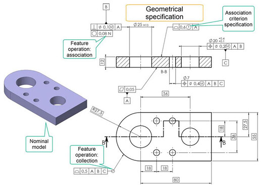

The specification process is the first process to take place in the definition of a product or a system. The purpose of this process is to translate the designer’s intent into a requirement or requirements for specific GPS characteristics. The designer is responsible for the specification process, which comprises ensuring the following steps (Fig. 2.6):
(a) feature functionality, i. e. the desired design intent of the GPS specification;
(b) GPS specification, which consists of a number of GPS specification elements each of which controls one or more specification operations;

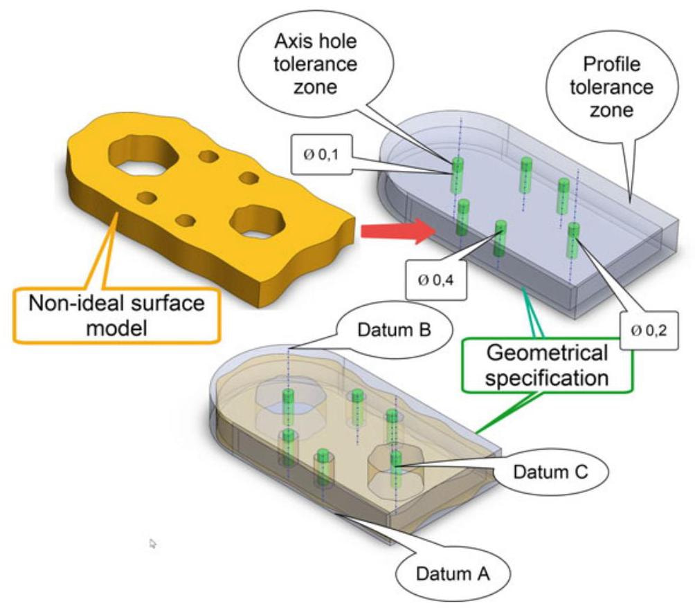

Fig. 2.4 The non-ideal surface model is used to simulate variations of the surface at a conceptual level, thus optimising the maximum permissible limit values for which the function is downgraded but still ensured
(c) specification operations, which are defined as an ordered set of operations and can be thought of as a virtual measurement instruction, where each operation and the parameters that define such an operation are steps in the measuring process.
A specification operator is necessary to define, for example, a possible specific “diameter” in a cylinder (two-point diameter, minimum circumscribed circle diameter, maximum inscribed circle diameter, least squares circle diameter, etc.), instead of the generic “diameter” concept. A specification involves expressing the field of permissible deviations of a characteristic of a workpiece as the permissible limits. There are two ways of specifying the permissible limits: by considering the dimension or by specifying the zone that limits the permissible deviation of a non-ideal feature inside a space.
This is a new, more complicated approach than the previous methodologies, but it offers the designer more opportunities and more powerful tools to define the expected functional requirements with the maximum allowed tolerance.

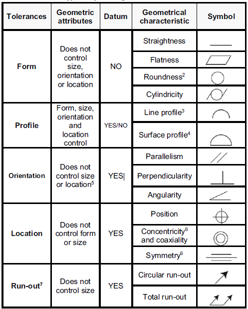

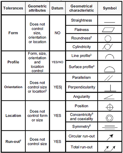

The chart in Table 2.2 shows the characteristic geometrical symbols used for geometrical tolerancing and the four tolerance types into which these symbols are divided. The symbols are explained in more detail later on.
As can be seen from the table, some non-associable tolerances (for instance, planarity, roundness, etc.) do not refer to other features of a part, taken as a datum; some geometrical characteristics require a datum (such as parallelism or the location of a hole) and other tolerances that may or may not be associated with another feature, such as tolerances on profiles.
In other words, while a form error concerns an isolated feature (such as a flat surface), an orientation or location error is associated with another feature of the workpiece, which is known as the datum feature (more details of which will be presented in the next sections, together with details on how such a feature should be indicated). In short, a geometrical tolerance defines a space (either bi-dimensional or three-dimensional) within which the feature that has to be controlled must remain. For example, a feature of a plane, for which one wishes to control the straightness, should remain within the area defined by two straight parallel lines at the same distance as the tolerance value; the tolerance zone in the 3D space should be a cylinder with a perfectly straight axis and generatrix, and with the diameter equal to the tolerance value.
Table 2.2 Classification, types and symbols of geometrical tolerances

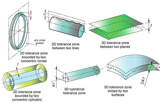

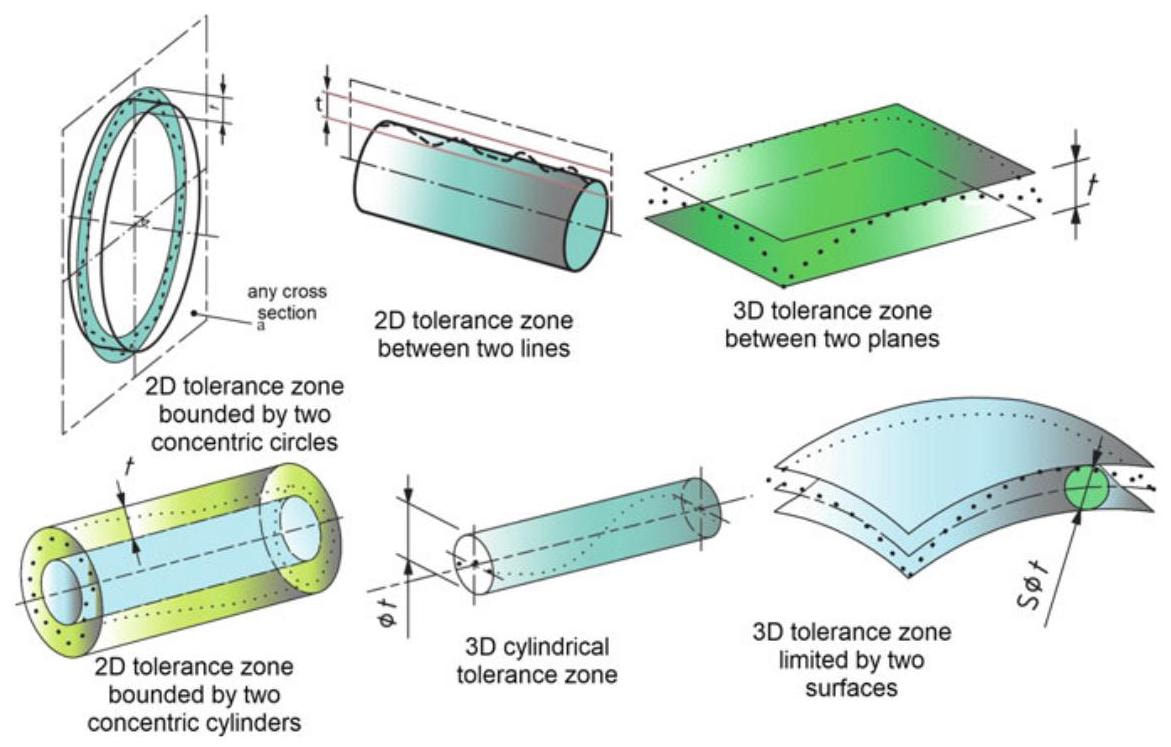

Fig. 2.7 Some typical forms of three-dimensional tolerance zones
Some typical forms of tri-dimensional tolerance zones are visible in Fig. 2.7, together with indications on the relative dimensions.

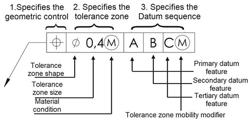

2.3.1 ISO Tolerance Indicator

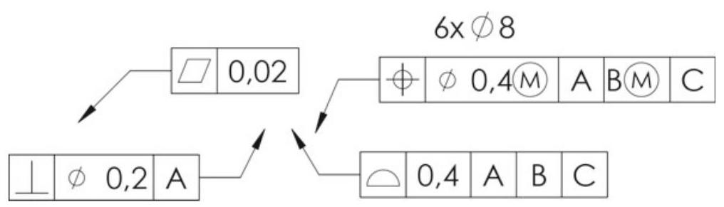

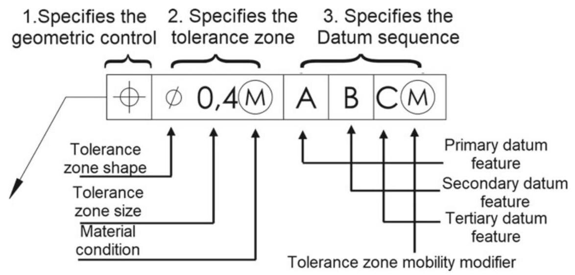

According to the aforementioned standard, that is, ISO 1101, geometrical tolerances should be indicated on drawings by means of a rectangular frame (ISO: tolerance indicator, ASME: feature control frame) divided into two or more compartments (Fig. 2.8). The compartments should contain, from left to right, the following indications in the same order:
(1) the symbol of the geometrical tolerance, according to Table 2.2
Fig. 2.8 The tolerance indicator decoding process
(2) the total tolerance value of the measurement unit used for the linear dimensions. This value is preceded by the sign
if the tolerance zone is round or cylindrical; another indication can be given in this compartment, that is, a capital letter inserted into a circle, which is used to prescribe the so-called “modifiers”, such as, for example, the application of the requirement of the maximum material, and so on, which modify the tolerance value;
(3) the letter or letters that identify the datum features, whenever necessary, which may be followed by the indication of modifiers.
Any necessary annotations may be written either above or close to the tolerance indicator (for example, “6 x”, as in Fig. 2.9) or joined to the frame by means of a leader line. If more than one geometrical tolerance is indicated on the same feature, the indications should be reported in overlapping compartments, as shown in Fig. 2.10.
Fig. 2.9 Examples of geometrical specifications with a tolerance indicator. The geometrical specification indication should be connected to the leader line by a reference line. The reference line should be attached to the mid-point of the left-hand side or the right-hand side of the tolerance indicator

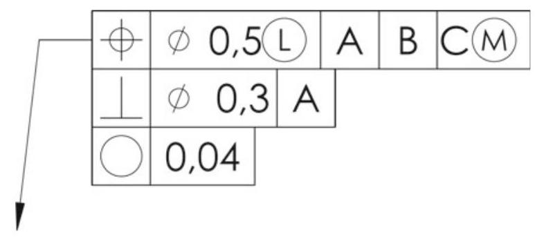

Fig. 2.10 If more than one geometrical tolerance is indicated on the same feature, the indications should be reported in overlapping compartments. In this case, it is recommended that the tolerance indicators are arranged so that the tolerance values are shown in descending order, from top to bottom

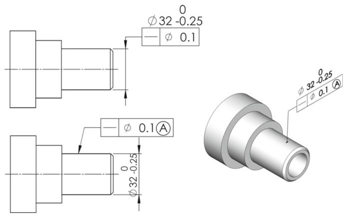

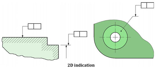

The tolerance frame is connected to a toleranced feature by a leader line, with an arrow at the end:
(a) on the contour line of the feature or on an extension line of the contour (but clearly separate from a measurement line), if the tolerance is applied to a line or surface (Fig. 2.11); it is also possible to use a reference line that points directly to the surface.

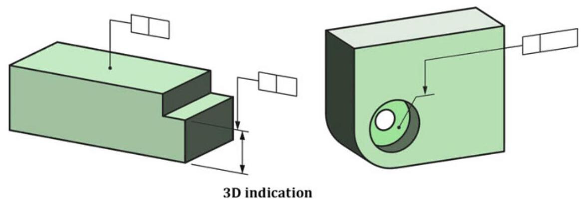

(b) According to ISO/CD 16792:2011, pertaining to the definition of 3D digital products, leader lines that have the aim of representing line elements should terminate with an arrowhead, see Fig. 2.12. When an indicated element is a surface, the leader line should terminate with a dot within the bounds of the surface.

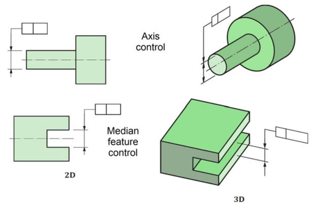

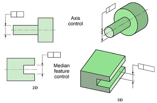

(c) as an extension of the dimension line, if the tolerance applies to a derived feature (axis, median line, median surface or a centre point, Fig. 2.13).
Fig. 2.11 Indication of an integral feature specification
Fig. 2.12 In 3D annotation, when an indicated element is a surface, the leader line should terminate with a dot within the bounds of the surface
Fig. 2.13 Indication of a derived feature specification

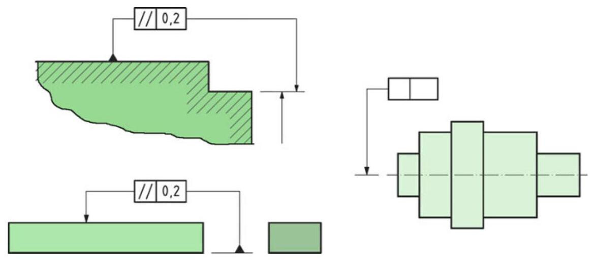

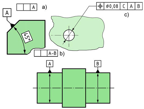

The direct joining of a reference element to the frame through a leader line, with the omission of the datum letter, should be avoided. The practice of directly connecting a tolerance indicator with a leader line terminating with an arrow directly to the axis has been deprecated (Fig. 2.14); see Fig. 2.13 for the preferred indications.
The letter that indicates the datum feature should be reported in the frame, as shown in Fig. 2.15. Although a single datum feature is identified by just one single capital letter (Fig. 2.15a), a common datum, established from two features, should be identified by two different letters separated by a hyphen (Fig. 2.15b).
As will be seen later on, the datum system is not only useful to establish the functional relationships between several features, but also to indicate the sequence that has to be followed to control the geometrical tolerance of a part; this means that, in the case of several datums, the relative letters should be indicated in consecutive compartments in the frame (Fig. 2.15c), in priority order from left to right.
Fig. 2.14 It was former practice to connect the tolerance indicator directly to the datum feature by means of a leader line or to connect the tolerance indicator by a leader line terminating with an arrow directly to the axis
Fig. 2.15 Indication of a single datum feature (a), a common datum established from two features (b) and three datums, in priority order, from left to right (c)

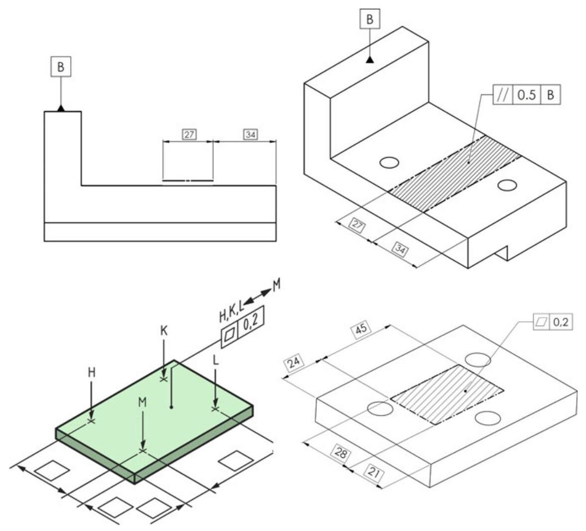

If the tolerance is applicable to a limited length, which is not defined as a location, the value of this length should be added to the tolerance value and separated from it by an oblique stroke. If a more restrictive tolerance on a limited length is added to another tolerance on a feature, the tolerance indicator should be placed below the other, as indicated in Fig. 2.16.
Fig. 2.16 Indication of restrictive specifications. If two or more specifications of the same feature have to be indicated, they may be combined. they may be combined
If the tolerance (or datum) only has to be applied to a restricted area of a feature, it should be identified (with locations and dimensions defined according to Theoretically Exact Dimensions (TED), as indicated in Fig. 2.17,using a chain line (line 4.2 in ISO 128-24).
Inserting a circle, in correspondence to the junction of the leader line of the tolerance (Fig. 2.18), indicates that the geometric control applies to the entire external boundary (all around), while two circles indicate that a profile tolerance, or other specification, applies over the entire three-dimensional profile of a part (all over). An “all around” or “all over” symbol should always be combined with an SZ (separate zones), CZ (combined zone) or UF (united feature) specification element, except for when the referenced datum system locks all non-redundant degrees of freedom (see the next section).

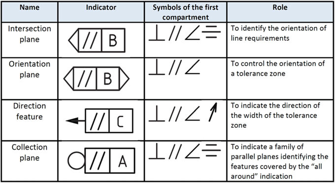

Table 2.3 shows other additional symbols (plane and feature indicators), that can be used to control the geometrical errors and allow the verification methodology to be specified in an unambiguous manner. Intersection plane, orientation plane, direction feature and collection plane indicators can be indicated in the in-line adjacent to the tolerance indicator.

Fig. 2.19 In the case of a revolute, the derived median line can be indicated by a modifier (median feature) placed in a specific section of the tolerance indicator. In this case, the leader line does not have to terminate on the dimension line

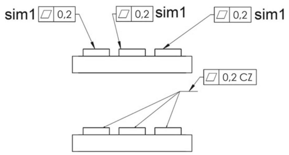

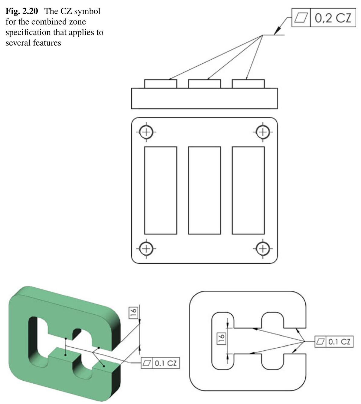

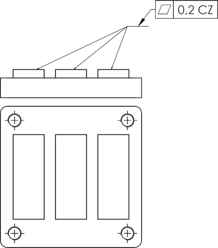

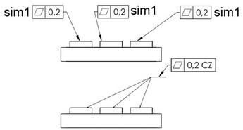

Fig. 2.20 The CZ symbolfor the combined zone specification that applies to several features
Fig. 2.21 All the related individual tolerance zones should be constrained in location and in orientation between each other using either explicit theoretically exact dimensions (TED), or implicit TEDs

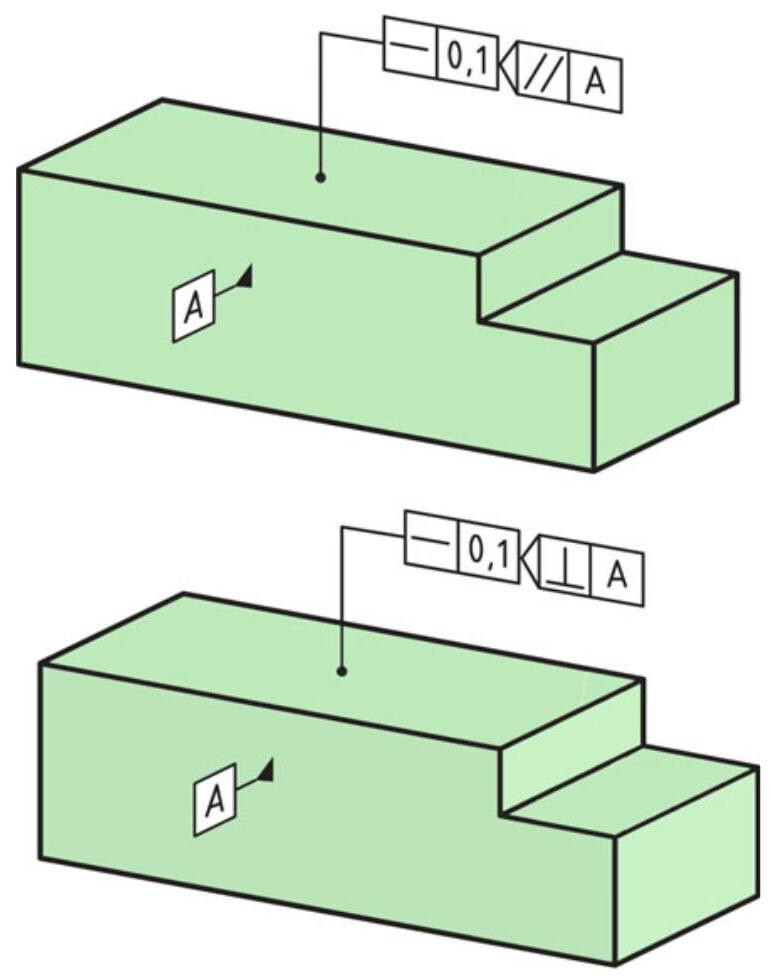

For example, the use of the intersection plane indications (specified through the use of an intersection plane indicator placed, as an extension, to the right of the tolerance indicator) makes the identification of the bi-dimensional tolerance zone possible, regardless of which projection is used (Fig. 2.23), and it is therefore very useful for 3D dimensioning (Fig. 2.24).
Fig. 2.22 Indications adjacent to the tolerance indicator
Table 2.3 Roles and symbols that can be used with intersection plane, orientation plane, direction feature and collection plane indicators
The letter that identifies the datum used to establish the intersection plane is placed in the second section of the intersection plane indicator. The symmetry symbol is used to indicate that the intersection plane includes the datum.

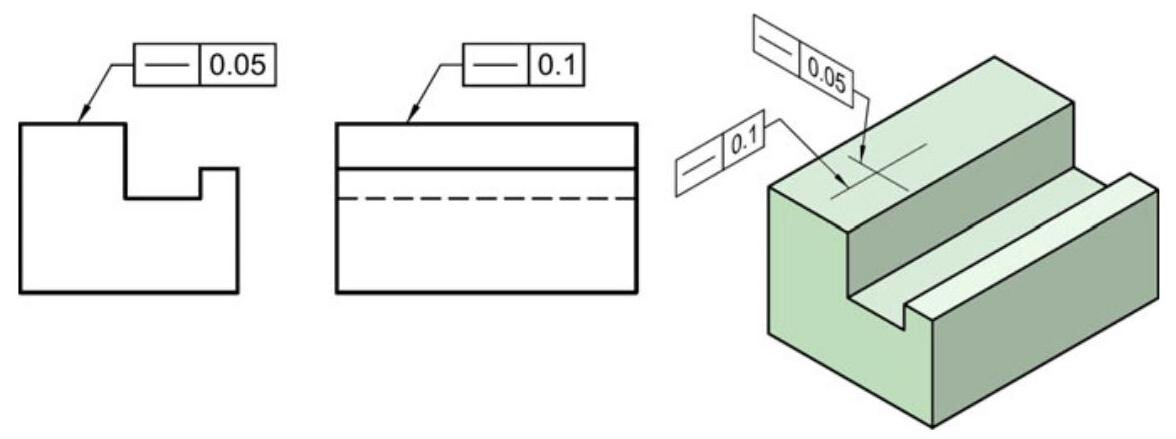

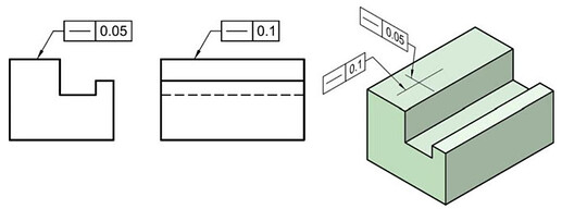

Figure 2.25 illustrates the use of a straightness tolerance on a flat surface as indicated in the ASME Y14.5:2018 standard. The intersection plane is not used, but the direction of the prescribed straightness tolerance is indicated by means of an orthographic view or by a line as a supplemental geometry in the 3D model.
Fig. 2.23 Specification using an intersection plane indicator. The toleranced feature is made up of all the lines of a feature in a given direction, and the intersection plane is used to identify the orientation of the line requirements
Fig. 2.24 In 3D annotation, the intersection plane should be indicated to avoid misinterpretation of the toleranced feature
Fig. 2.25 Straightness applied to control line elements in multiple directions on a flat surface in the ASME Y14.5:2018 standard; the direction of the prescribed straightness tolerance is indicated by two lines as a supplemental geometry in the 3D model

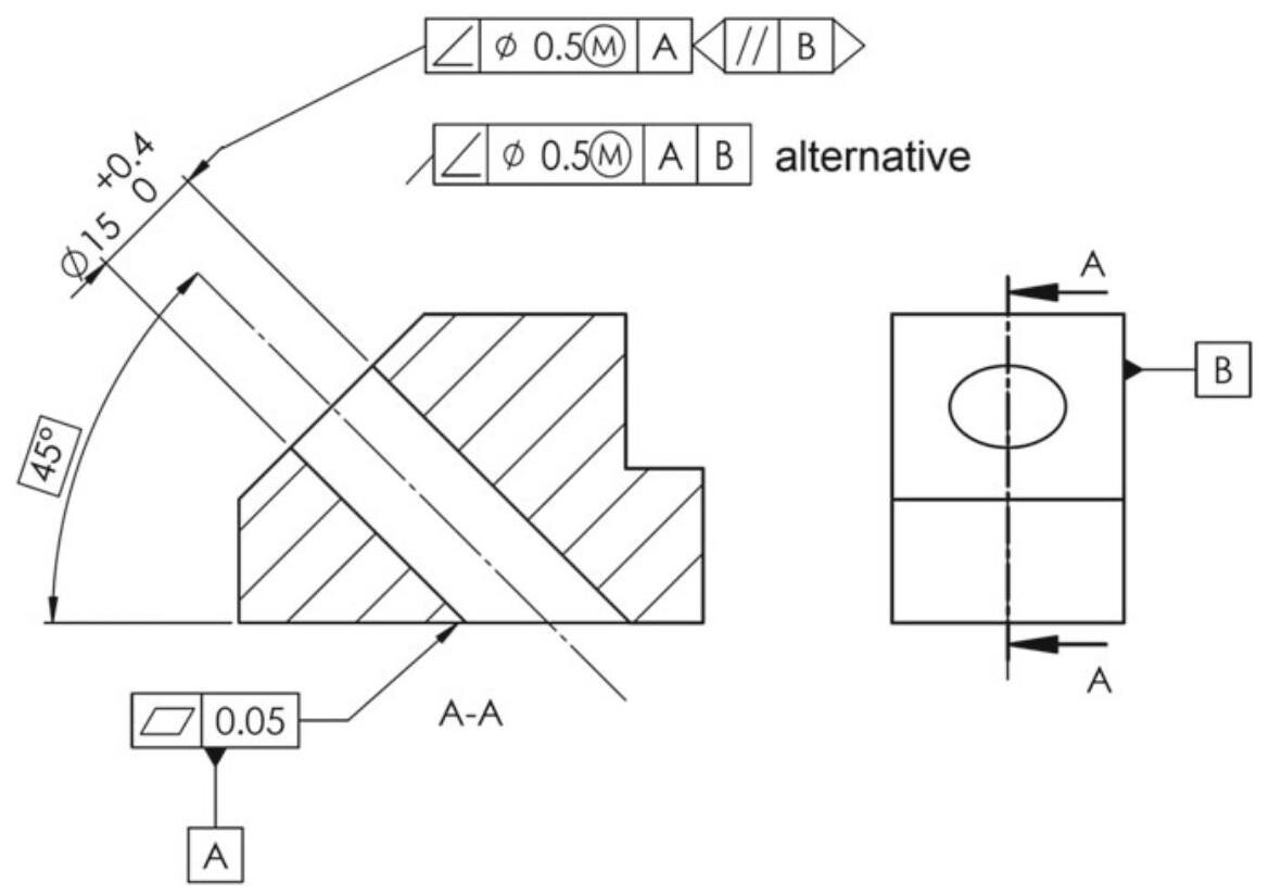

The orientation plane indicator controls both the orientation of the planes that limit the tolerance zone (directly, by means of the datum and the symbol in the indicator) and the orientation of the width of the tolerance zone (indirectly, perpendicular to the planes), or the orientation of the axis for a cylindrical tolerance zone. A typical application used to control the angle of an axis is shown in Fig. 2.26, as an alternative to the previous methodology, which foresaw the indication of two datums.
Fig. 2.26 The cylindrical tolerance zone is parallel to datum plane B and inclined at the specified angle to datum plane A; the orientation plane is used to avoid the presence of two datum features in the tolerance indicator

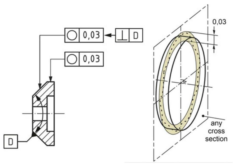

The new standard, that is, standard 1101 of 2017, has also clarified a misunderstanding that had existed for some time pertaining to the previous versions and which has finally been resolved, that is, the indication of the direction of the tolerance zone of roundness.
In fact, the old 1101 standard foresaw, in Sect. 8.1, that “the amplitude of all the roundness tolerance zones, if not otherwise expressed, shall always be developed in an orthogonal direction to the surface of the feature that had to be controlled”. However, just a few lines later, at the end of the section, two lines, which stated “in the case of roundness, the amplitude of the tolerance zone shall be applied in an orthogonal direction to the nominal axis of the piece” appeared in a cryptic way.
Instead, in the new version, in Sect. 7.1, the new standard specifically states, notwithstanding what is prescribed by default, that the new “direction feature” symbols should be used for surfaces that are not round or cylindrical to specify how the tolerance is applied. Therefore, a direction indicator should always be indicated for the roundness of conical features. In Fig. 2.27, for both the cylindrical and conical surfaces, the extracted circumferential line, in any cross-section of the surfaces, should be contained between two coplanar concentric circles, with a difference in radii of 0,03 . This is the default value for the cylindrical surface and is indicated by means of the direction feature indicator for the conical surface.

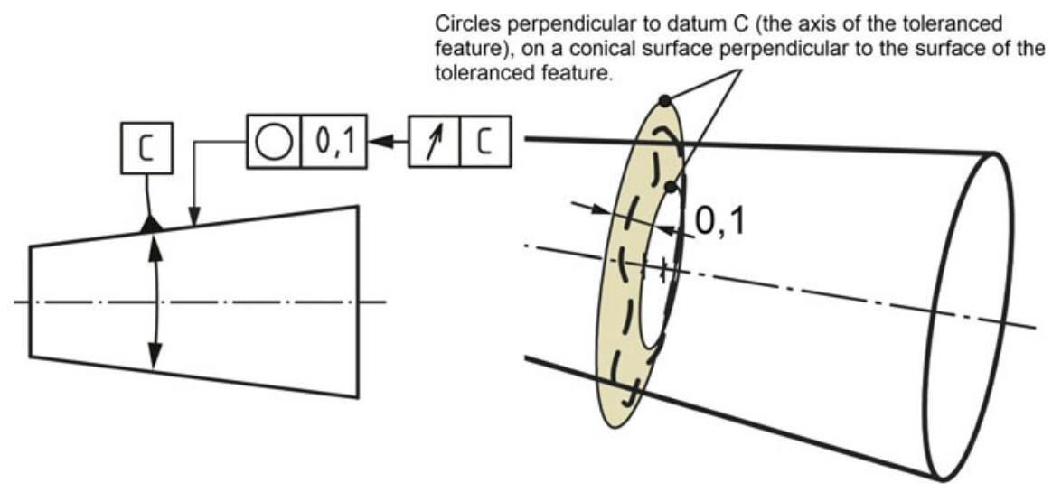

The tolerance zone defined by the specification in Fig. 2.28 is limited, in the considered cross-section,by two circles on a conical surface 0.1mm apart along the surface.
Fig. 2.27 The extracted circumferential line should be contained between two coplanar concentric circles, with a difference in radii of 0,03 , for both cylindrical and conical surfaces, in any cross-section of the surfaces perpendicular to an axis. This is the default value for the cylindrical surface and it is indicated by means of the direction feature indicator for a conical surface
Fig. 2.28 The extracted circumferential line in the conical component on the right should be contained between two circles on the intersecting cone, 0.1 apart. The tolerance zone is perpendicular to the surface of the toleranced feature, as indicated by the direction indicator
The collection plane symbol establishes a family of parallel planes, which identifies a closed boundary of contiguous features covered by the “all around” symbol. Indeed, if a geometrical specification is applied to all the features represented by a closed outline, it should be indicated by the “all around” symbol together with a collection plane indicator in order to make the drawing unambiguous (see Fig. 2.29), especially for 3D annotations.

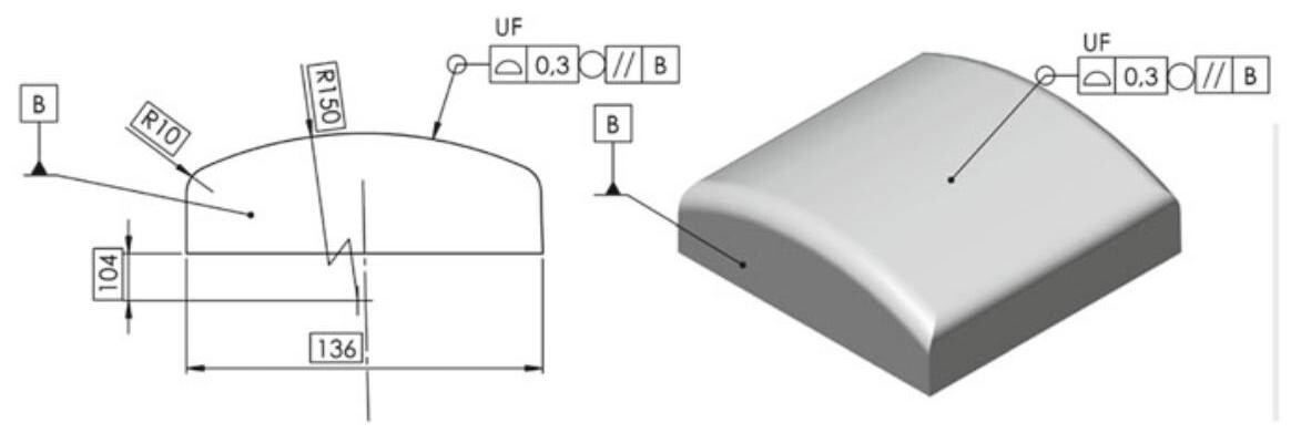

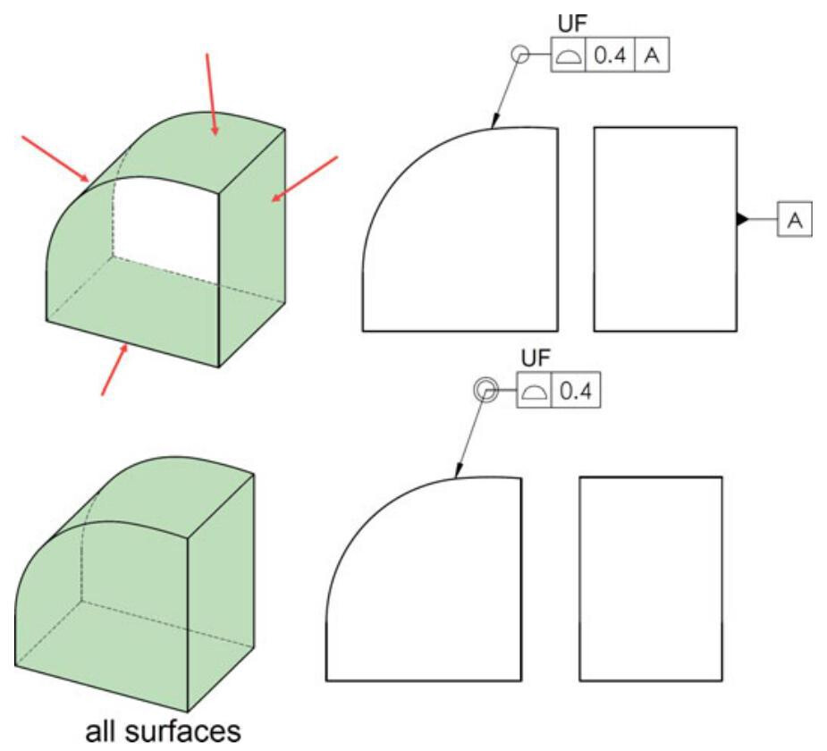

In Fig. 2.30, as the “all around” symbol is used with a UF modifier (Unified Feature), the tolerance applies to a united feature which includes the features that make up the periphery of the workpiece when seen in a plane parallel to datum B, as indicated by the collection plane indicator. Basically, a collection plane identifies a set of single features whose intersection with any plane parallel to the collection plane is a line or a point.
If the specification applies to any cross section or any longitudinal section of a feature, it should be indicated with the “ACS” specification modifier for any cross section or with the “ALS” specification modifier for any longitudinal section. The two symbols can be placed above the tolerance frame (see Fig. 2.31a) or after the datum letter symbol in the tolerance frame (see Fig. 2.31b), with no change in meaning.
Fig. 2.29 Without any indication of the collection plane, the symbol “all around” symbol is ambiguously applied to all the features represented by a closed outline
Fig. 2.30 Since the “all around” symbol and the UF modifier are used, the tolerance applies to a united feature consisting of the features that make up the periphery of the workpiece when seen in a plane parallel to datum B, as indicated by the collection plane indicator

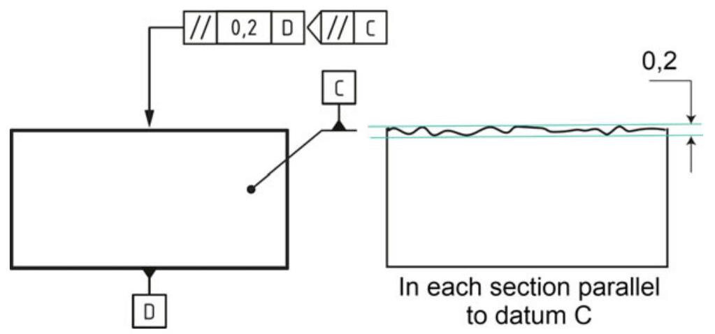

Fig. 2.31 The ACS and ALS symbols can both be placed above the tolerance frame (a,c) or after the datum letter symbol in the tolerance frame (b,d) ,with no change in meaning
When the ACS modifier is indicated, the toleranced feature and the datum feature are defined in the same cross-section. The intersection plane that defines the toler-anced feature is by definition a plane perpendicular to the median feature of the associated feature, as established from the extracted integral surface.
Indicating “ALS” above the tolerance frame (see Fig. 2.31c) or after the datum letter symbol (see Fig. 2.31d), allows the datum feature to be defined as any longitudinal section of the integral feature (concurrently with the toleranced feature). The datum feature is the intersection of the real integral feature used to establish the datum and the section plane. A longitudinal section is defined as a half plane that includes an axis.

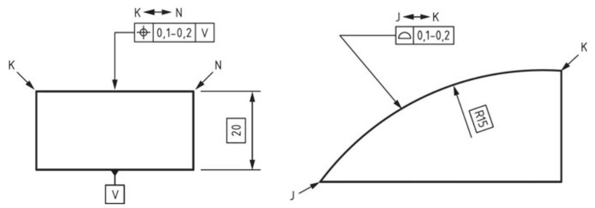

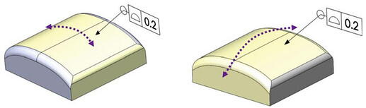

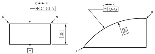

Figure 2.33 indicates the use of the between symbol adjacent to the tolerance indicator and identifies the two locations where each value applies. In this case, a proportional variation is defined from one value to another, between two specified locations, on the considered feature.
Fig. 2.32 Example of the use of a rank-order specification with ALS and ACS modifiers. For the upper indication, an upper limit (0,004) applies to the range of the two-point size values defined in any cross section. For the lower indication, an upper limit (0,006) applies to the range of the two-point size values defined in any longitudinal section
Fig. 2.33 Drawing with indications of the variable width specification using the between symbol

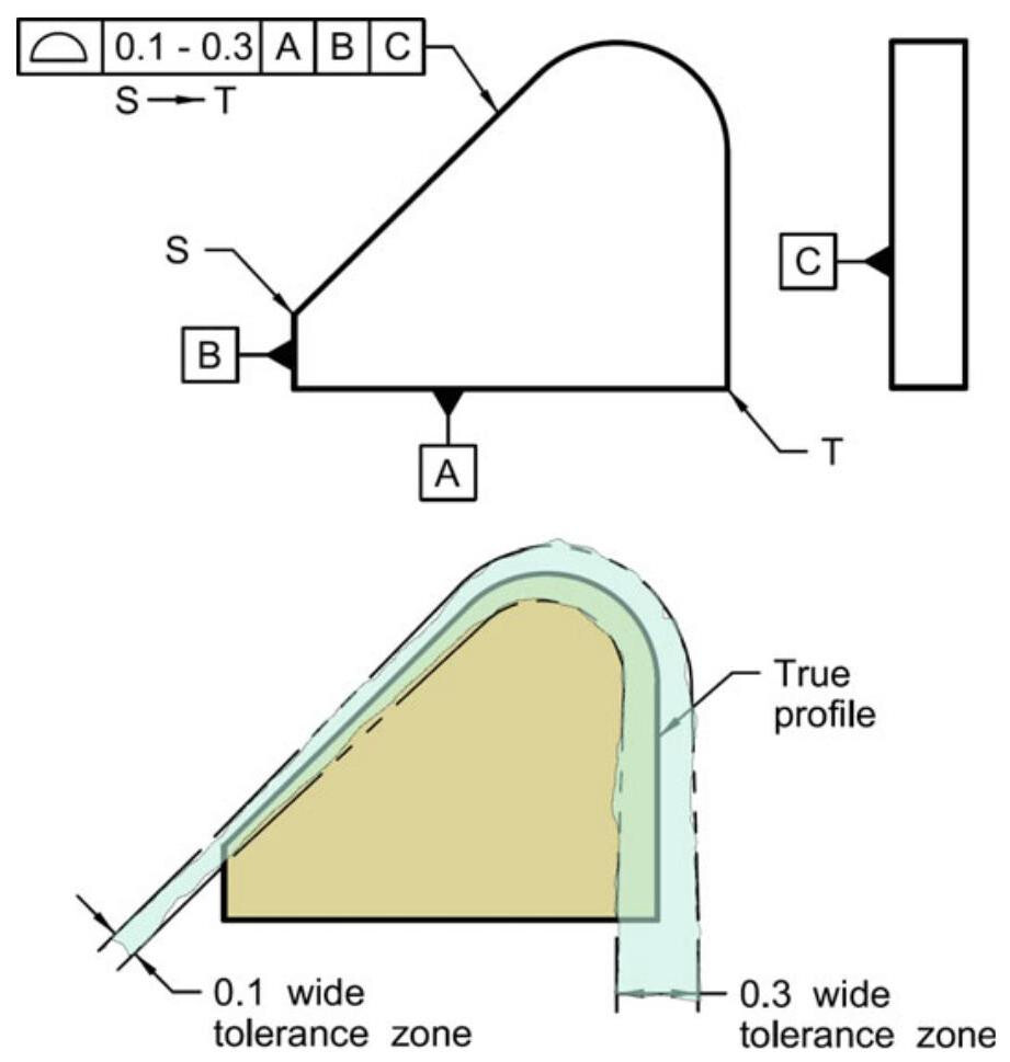

In the ASME Y14.5:2018 standard, the profile tolerance, with a proportional variation between two specified locations on the considered feature, is indicated with the new From-To symbol, which is located below the tolerance frame. In Fig. 2.34, the tolerance width varies proportionally from 0.1 at S to 0.3 at T.

Fig. 2.34 The profile tolerance in the ASME Y14.5:2018 standard, with a proportional variation between two specified locations on the considered feature, is indicated with the new From-To symbol located below the tolerance frame. The tolerance width in the figure varies proportionally between 0.1 at S and 0.3 at T

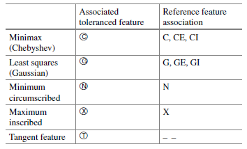

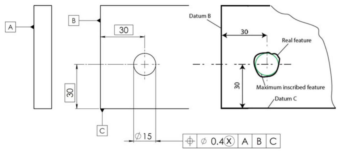

As can be seen in Sect. 2.1, an associated feature is an ideal feature that is established from a real feature through an association operation. By default, the reference feature association is the minimax (Chebyshev) association without constraints and it can be used for form specifications, but it is also possible, as an alternative, to indicate the reference feature association specification element as in Fig. 2.36. Table 2.4 shows the symbols and the relative meanings of the associated criteria. E, I should be used to indicate the criteria association with the constraint external (E) and internal (I) to the material.
Fig. 2.36 Cylindricity control with indication of the association of the two reference features (maximum inscribed and Gaussian association). The modifier X maximises the size of the reference feature, while maintaining it entirely inside the toleranced feature. G should be used to indicate the least squares (Gaussian) association. It minimises the square of the local deviations of the toleranced feature to the reference feature

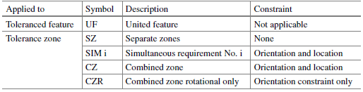

Table. 2.4 Associated toleranced feature specification elements. The symbol inside the circle in the second column indicates that the tolerance is applied to the associated element. The symbol in the third column indicates the association criterion and is usually applied to form tolerances

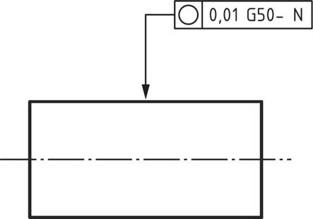

Fig. 2.37 Roundness specification with a minimum circumscribed reference feature after the application of a Gaussian long-wave pass filter with a cutoff value of 50 UPR
The filter specification is an optional specification element which is indicated by a combination of two specification elements, that is, the type of filter and the nesting index or indices for the filter (Fig. 2.37).

The new ISO 5458:2018 standard establishes rules that may be considered complementary rules to ISO 1101 to apply to pattern specifications. According to the independency principle (ISO 8015:2011, 5.5), a geometrical specification that applies to more than one single feature by default also applies to those features independently. The tolerance zones defined by one tolerance indicator or by several tolerance indicators should therefore be considered independently by default.
The new standard has introduced a new definition of internal constraints (location constraint and/or orientation constraints between the individual tolerance zones of the tolerance zone pattern) using the CZ,CZR or SIM modifiers (Table 2.5).
There are two ways of creating a tolerance zone pattern, that is, either by using a single indicator pattern specification with the CZ or CZR modifiers, or by using a multiple indicator pattern specification using SIM modifiers (Fig. 2.38).
Table. 2.5 Symbols and specification modifiers in the ISO 5458:2018 standard
Fig. 2.38 There are two ways of creating a tolerance zone pattern, that is, either by using a single indicator pattern specification with the CZ or CZR modifiers or by using a multiple indicator pattern specification using SIM modifiers
