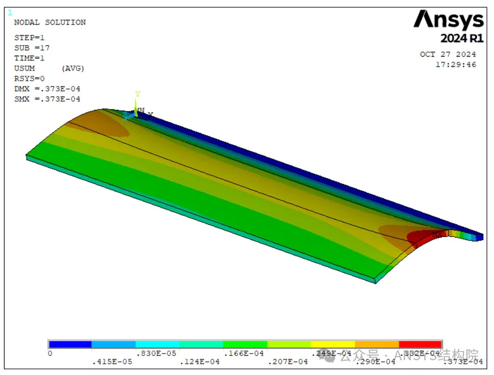

- Total Displacement Plot — Command:
PLNSOL, U, SUM
- DMX = SMX = 0.373e-4, with the contour plot’s maximum value at 0.373e-4.

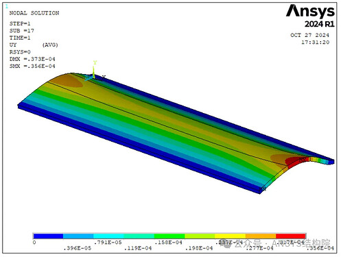

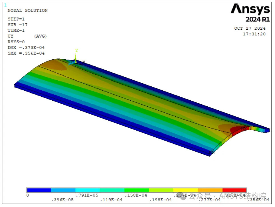

- Y-Displacement Contour Plot — Command:
PLNSOL, U, Y
- DMX = 0.373e-4
- SMX = 0.356e-4, which is the maximum value in the contour plot for this model.

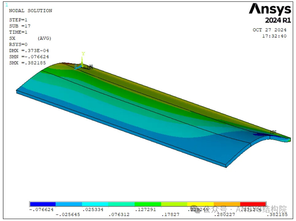

- X-Component Stress Contour Plot — Command:
PLNSOL, S, X
- DMX = 0.373e-4
- SMX = 0.3822
- SMN = -0.0766*

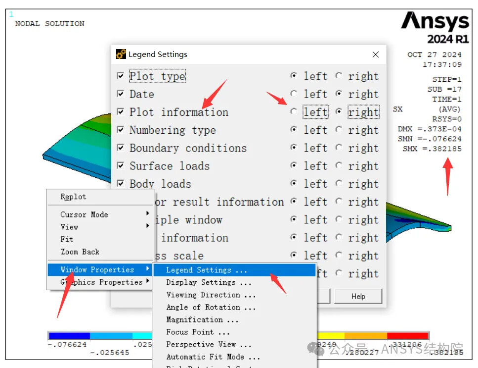

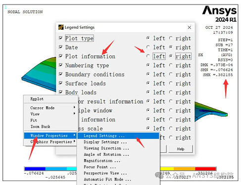

To modify the display settings for DMX, SMX, and SMN, right-click in the window and select Legend Settings.
