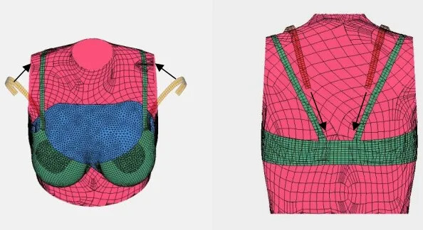

A human-bra coupling contact model is established, and model parameters such as material properties, mesh division, and boundary conditions are adjusted to ensure model accuracy and computational efficiency. The specific steps are outlined below.
Bra-Breast Coupling Contact Model
Step 1: Construct the Geometric Model

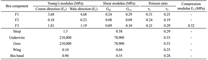

Step 2: Bra Material Properties
The material properties of the bra significantly affect its comfort. By understanding the elastic modulus, Poisson’s ratio, and stress-strain relationships of common bra materials (such as elastic fibers, cotton, etc.), a CAE simulation model can be accurately established.

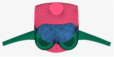

Step 3: Mesh Division
Typically, the bra is treated as a 2D shell element with quadrilateral units, and the mesh size is set between 0-5 mm. The breast is treated as a 3D shape with tetrahedral or hexahedral units, and the mesh size is generally set between 0-10 mm.

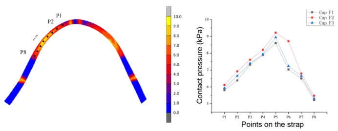

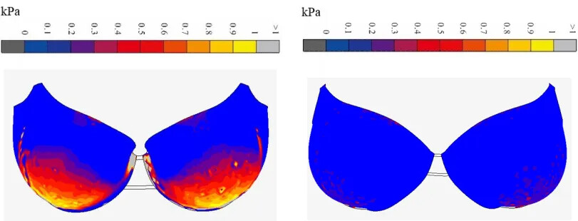

Step 6: Simulate for Different Bust Sizes
The inner diameter is defined as a variable, and the simulation is run for various bust sizes to analyze the stress distribution, deformation, and fit indicators of the bra. This helps assess the comfort and adaptability of the bra, providing guidance for choosing the right one.
