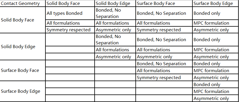

**ANSYS Professional 1 licenses** and above support mixed assemblies of shells and solids, allowing for complex assemblies that leverage the advantages of shells, providing more contact options and post-processing capabilities.
- **Edge Contact** : This is a subset of generated contact, including shell faces or solid edges, only defining bonded or non-separating contact types.
  - For edge contact involving shell edges, only MPC form of bonded behavior can be defined.
  - For MPC-based bonded contact, users can set the searcher to target normals or the pinball region (which requires multi-point constraints).
  - If gaps exist (common in shell assemblies), the pinball region can act as a detector for contact across gaps.
A summary table of contact types and their available options in DS follows.
 ![image](https://www.cax.do/uploads/default/original/1X/c9858b04b4fea1c8f4daa41d4a4df1840831f907.png)
- This table is also available in DS’s online help. It helps users decide which options are available for selection.
