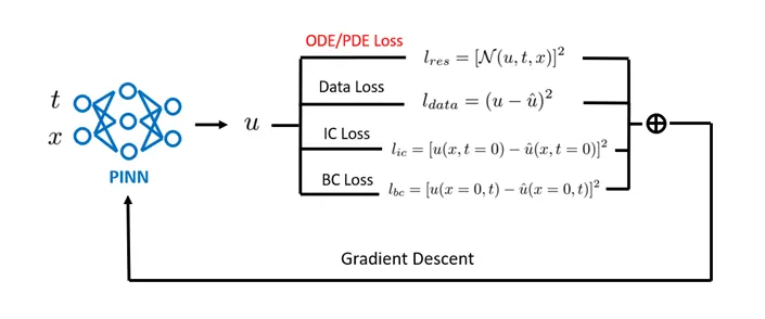

It can be simply understood like this: A traditional neural network is like a student who only memorizes by rote; as long as enough data is provided, it can remember it. But once it encounters a problem it hasn’t studied, it’s prone to errors. A PINN, on the other hand, is more like a student who not only memorizes the question bank but also masters the principles—it must pass both the “memory exam” and the “principle exam” during training. The former requires fitting observational data, while the latter requires adhering to physical laws.
 ![image](https://www.cax.do/uploads/default/original/2X/e/e4d11649cebcc23ae6c02c94c43103cce8e62cc1.png)

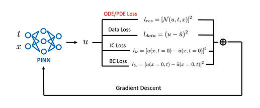

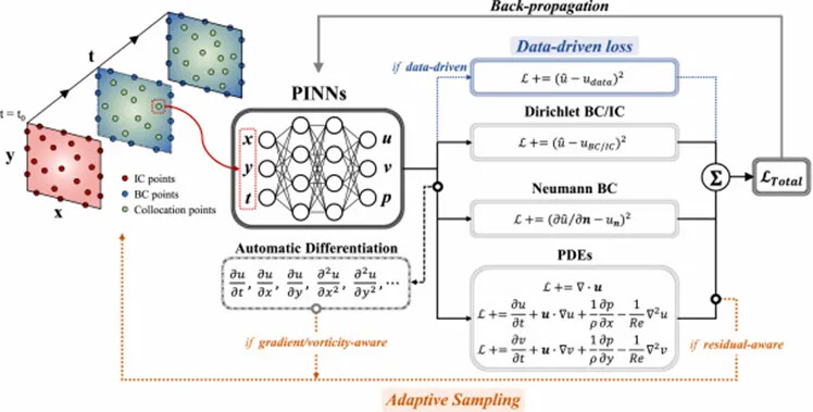

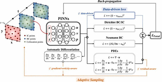

PINNs treat deep neural networks as approximate representation functions for unknown solutions. Their inputs are typically spatiotemporal coordinates (x, y, z, t), and outputs correspond to the physical quantities to be solved (such as velocity fields, temperature fields, pressure fields, etc.). During training, the loss function of a PINN usually consists of two parts: the data loss term and the physics loss term.
- **The data loss term** measures the error between the neural network’s predictions and observational data, ensuring the model’s fitting accuracy at known sample points.
- **The physics loss term** imposes constraints by substituting the network output into the governing partial differential equations (PDEs) of the system, combined with boundary and initial conditions. In practice, automatic differentiation (AD) is used to obtain the required partial derivatives, constructing equation residuals and quantifying their magnitude to ensure the neural network’s approximate solution satisfies the underlying physical laws.
By simultaneously minimizing these two loss terms, PINNs can maintain data consistency while adhering to the physical constraints implied by the governing equations, resulting in more reasonable and generalizable solutions. Thanks to this, PINNs excel in solving problems that traditional numerical methods struggle with. PINNs have been applied in various fields such as fluid mechanics, heat transfer, solid mechanics, quantum mechanics, and materials science, offering high-precision solutions for forward problems and unique advantages in inverse problems and parameter identification.

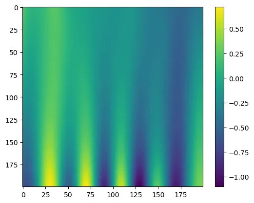

Construct the exact solution of the equation to be solved and visualize it.
```auto
import numpy as npimport matplotlib.pyplot as plt
def u(x, t): return np.exp(-2*np.pi*np.pi*t)*np.sin(np.pi*x)
pts = 200ts = np.linspace(0.2, 0, pts)xs = np.linspace(-5, 5, pts)
X, T = np.meshgrid(xs, ts)U = u(X, T)
plt.imshow(U)plt.colorbar()

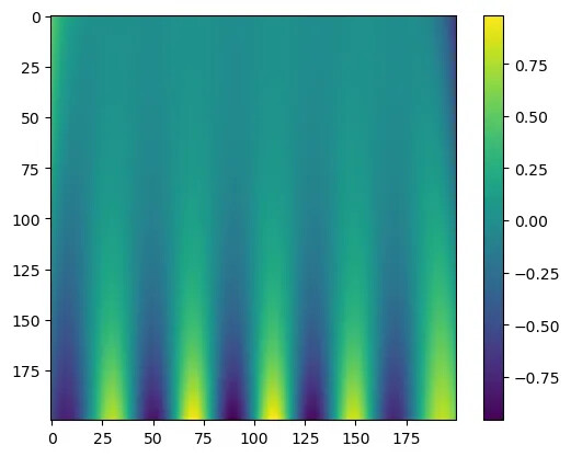

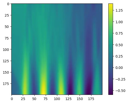

Use the trained neural network model to predict the solution and visualize the prediction results.
```auto
def u_model(xs, ts): pts = torch.stack([xs, ts], dim=1).to(DEVICE) return model(pts)
pts = 200ts = torch.linspace(0.2, 0, pts, device=DEVICE)xs = torch.linspace(-5, 5, pts, device=DEVICE)X, T = torch.meshgrid(xs, ts, indexing="ij")X = X.TT = T.T
img = []for x, t in zip(X, T): img.append(u_model(x, t).detach().cpu().numpy().tolist())
plt.imshow(img)plt.colorbar()
 ![image](https://www.cax.do/uploads/default/original/2X/7/72dca8801ca7d2fe7b05f66d8fdd8c06a3aaf4ee.jpeg)
As can be seen from the above figure, the traditional neural network model, unable to understand the physical process and merely fitting the data, produces results that deviate significantly from the exact solution, and some positions do not conform to the physical equation we defined. Next, build the PINN model and train it again, this time incorporating the physics loss term into the loss function. After training, use the PINN model for prediction and visualize it.

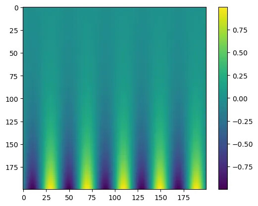

    epoch_loss = base + phys + bdry print( f"Epoch: {epoch+1} | Loss: {epoch_loss.item():.4f} = " f"{base.item():.4f} + {phys.item():.4f} + {bdry.item():.4f}" )
```auto
def u_model_pinn(xs, ts): pts = torch.stack([xs, ts], dim=1).to(DEVICE) return model_pinn(pts)
img = []for x, t in zip(X, T): img.append(u_model_pinn(x, t).detach().cpu().numpy().tolist())
 ![image](https://www.cax.do/uploads/default/original/2X/7/7e446abb1a1a4f23c5c0a3d1dc98390da4b2c15c.jpeg)

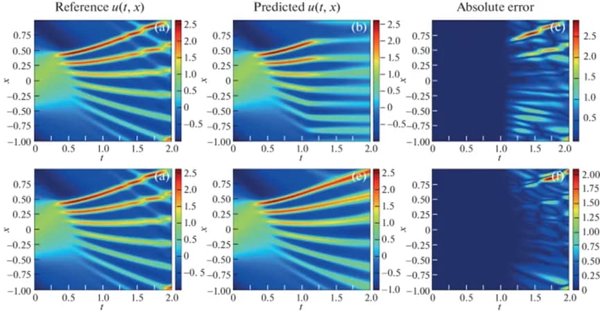

To achieve better accuracy, adopt a two-stage optimization strategy: **first use Adam for coarse tuning, then LBFGS for fine tuning, balancing the model between data fitting, PDE constraints, and boundary conditions, and visualize the results.**

```auto
def u_model_pinn_v2(xs, ts): pts = torch.stack([xs, ts], dim=1).to(DEVICE) return model_pinn_v2(pts)
img = []for x, t in zip(X, T): img.append(u_model_pinn_v2(x, t).detach().cpu().numpy().tolist())
 ![image](https://www.cax.do/uploads/default/original/2X/8/8077d4547e226508f66817bbe8f6278d7c3d8d73.jpeg)
