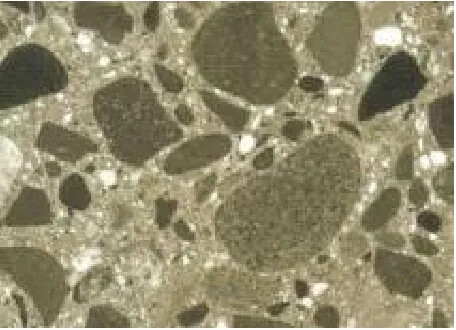

宏观意义上两种以上的材料组成的材料叫做复合材料， 一种材料称为“基体”，另一种称为“增强”，增强嵌入在基体中。
基体可认为由一种材料组成，增强根据其分布方式可分为以下几种：
◇ 离散
◇ 随机方向的纤维
◇ 呈直线分布的纤维
◇ 纤维织物
 ![A close-up photomicrograph reveals the intricate texture of a rock sample, showcasing a variety of irregularly shaped grains and a fine-grained matrix. (由 AI 生成标题)](https://www.cax.do/uploads/default/original/2X/7/7fe37d300757d580fbb77d52077ae7302aaa28e7.jpeg)
离散颗粒

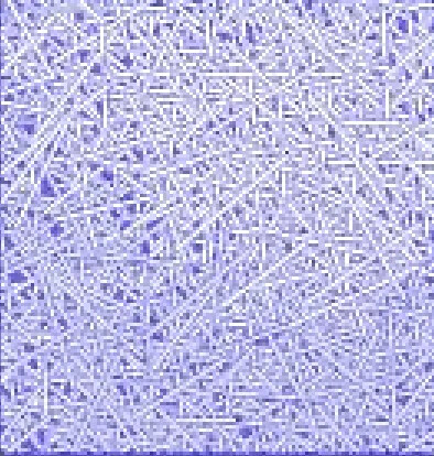

 ![An abstract image of a dense network of thin white lines on a light purple background. (由 AI 生成标题)](https://www.cax.do/uploads/default/original/2X/8/86b1ebbde4bbe5c0bb4487564d450cf6e7d8ad04.jpeg)
随机纤维

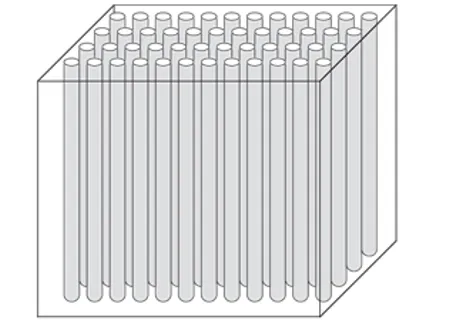

 ![A cubic container is densely packed with numerous cylindrical rods. (由 AI 生成标题)](https://www.cax.do/uploads/default/original/2X/0/050030871b07b6e1339ed728924f1eecdfdc1c9f.png)
单向纤维

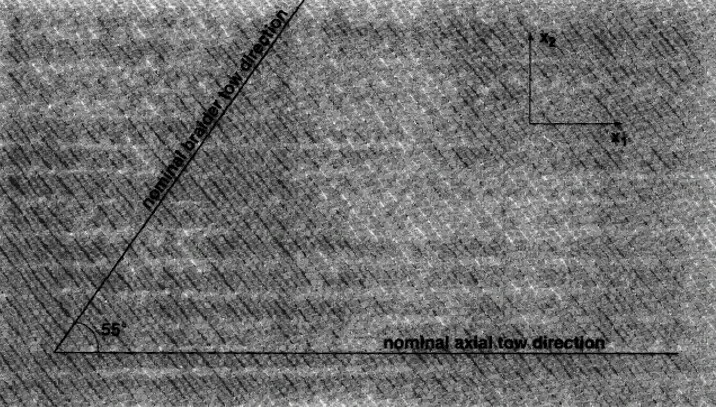

 ![A grayscale image shows a textured surface with a triangle overlay illustrating the 55-degree angle between the nominal axial tow direction and the nominal braider tow direction. (由 AI 生成标题)](https://www.cax.do/uploads/default/original/2X/8/87aeebad53c60a41fbc4ed5a74dceaeae001c760.jpeg)
编织物

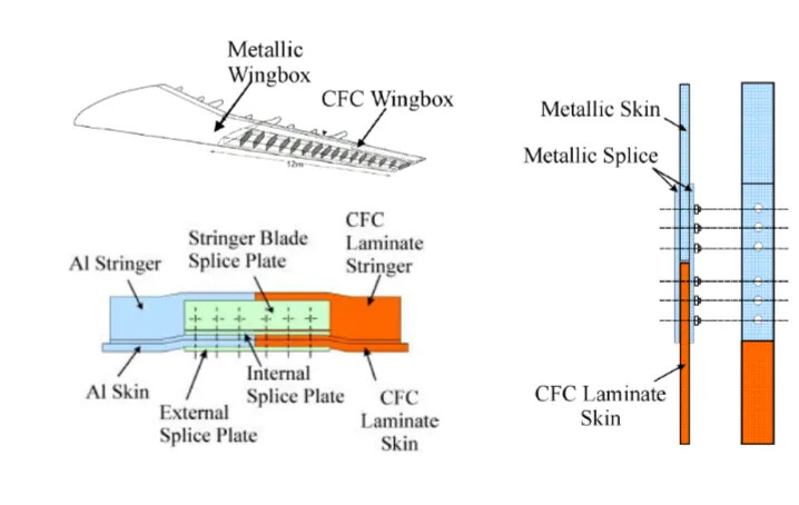

 ![This diagram illustrates the design of a wingbox structure, detailing the materials and construction methods used to join metallic and carbon fiber reinforced plastic (CFRP) components. (由 AI 生成标题)](https://www.cax.do/uploads/default/original/2X/6/626d60244f3ee300a02152e1b12edfa8409bbe47.jpeg)
单项层叠板在航空航天的应用

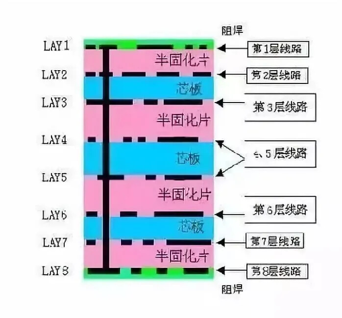

 ![A diagram shows the layered structure of a printed circuit board, with alternating layers of semi-cured sheets and core boards, connected to different levels of circuitry. (由 AI 生成标题)](https://www.cax.do/uploads/default/original/2X/9/9c44af7347f0e318e4e460e6bf80e6bdb2adf1ef.jpeg)
电路板中的应用

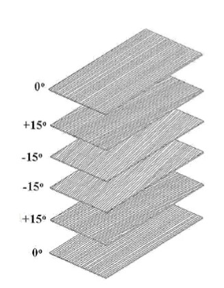

## 典型的复合材料1
 ![A diagram shows five layers of material stacked at angles of 0°, +15°, -15°, -15°, and +15°. (由 AI 生成标题)](https://www.cax.do/uploads/default/original/2X/0/0ae098e5f65a563eab16095e5e478febc0d0b5f6.jpeg)

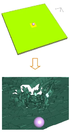

 ![A 3D model shows a sphere impacting a flat surface, causing the surface to shatter into numerous fragments. (由 AI 生成标题)](https://www.cax.do/uploads/default/original/2X/6/6111ac5a1e01779c0bdc59201b1f527a2238693e.png)
单一纤维方向复合材料板-弹道冲击分析

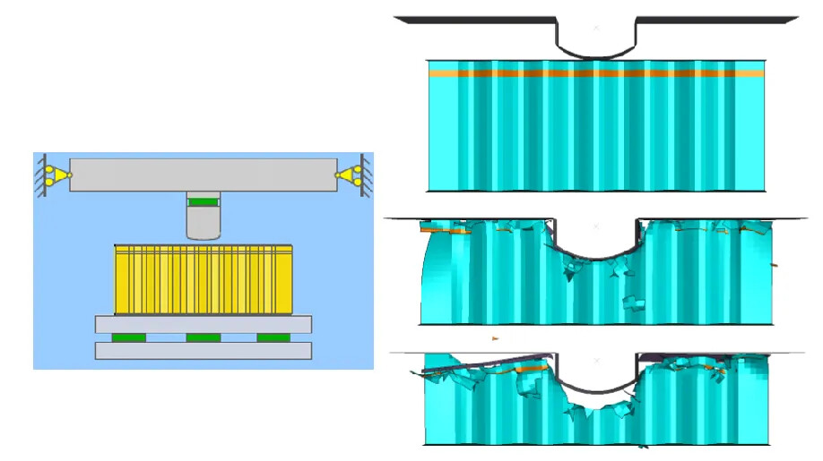

 ![A diagram shows a compression test simulation, where a block is subjected to a descending force, causing progressive fracturing. (由 AI 生成标题)](https://www.cax.do/uploads/default/original/2X/1/1182b9b2c559fcaaf1521f803c9dd1ea2ebd0c13.jpeg)
纤维织物复合材料梁-碰撞分析

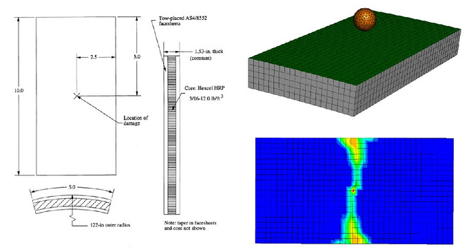

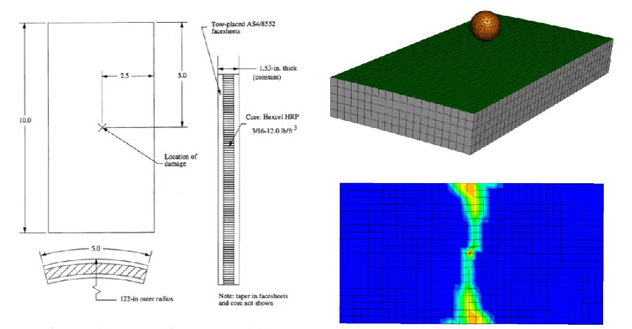

 ![This image shows a diagram of a damaged composite structure, a 3D model of the structure with an impacting object, and a finite element analysis of the resulting damage. (由 AI 生成标题)](https://www.cax.do/uploads/default/original/2X/9/9adb9f643a5cbaa1c1b1204964409feadc6cd7e1.jpeg)
蜂窝核心复合材料的损伤

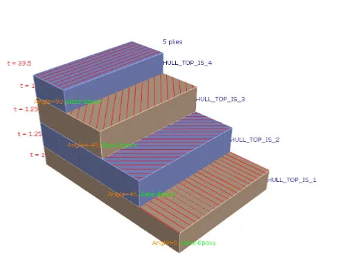

### **有限元模型**
根据不同的分析目的，选择不同的复合材料模型
常用分析模型
- 微观模型：纤维基分层单位晶胞模型
- 宏观模型
- 混合模型
- 离散增强模型
- 子模型
 ![A 3D model shows five layers of a composite material, labeled with their thickness, angle, material, and identifier. (由 AI 生成标题)](https://www.cax.do/uploads/default/original/2X/4/477b8b011adef0b23be4fee7383d4ca6cf838d1a.jpeg)

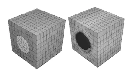

 ![Two three-dimensional models of cubes, one showing a mesh around a circular hole and the other showing the hole filled in. (由 AI 生成标题)](https://www.cax.do/uploads/default/original/2X/c/c0d8102a8e69a2366824d83123f9451edc5d0a61.png)

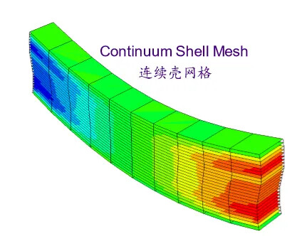

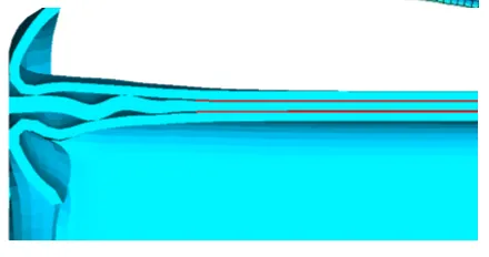

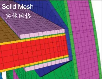

常用建模采用以下三种单元类型
- 常规壳（S4R）
- 连续壳（SC8R）
- 实体(C3D8R)
 ![A 3D model shows a cyan-colored structure with intricate internal layers and a reddish-brown line near the top. (由 AI 生成标题)](https://www.cax.do/uploads/default/original/2X/6/66b9d22a6e2568f849667ff02691b5c1849074b4.png)
