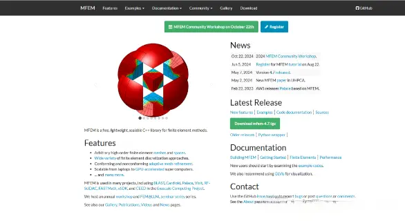

 ![0d3ae2b25cdaa410e88838785d93b7b6_thumbnail](https://www.cax.do/uploads/default/original/2X/5/5bb6073becaea2226d7d5eda751d99e9a8c8c6d6.webp)
MFEM official website, reference [1]

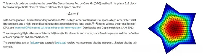

 ![Clipboard - 2025-01-12 19.29.13_thumbnail](https://www.cax.do/uploads/default/original/2X/0/069cbe430737947ed687354488e0b16fb5ca50de.webp)
Discontinuous Petrov-Galerkin (DPG) method, selected from reference [2]

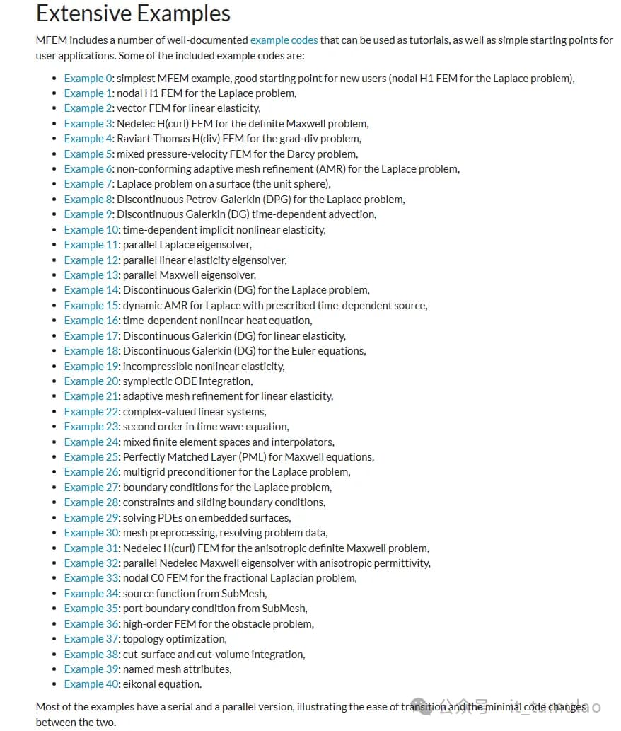

 ![image](https://www.cax.do/uploads/default/original/2X/a/a9ad3ce3a401aa8f4079c151e649d1794697e6bc.jpeg)
A large number of official example codes, selected from reference [6]

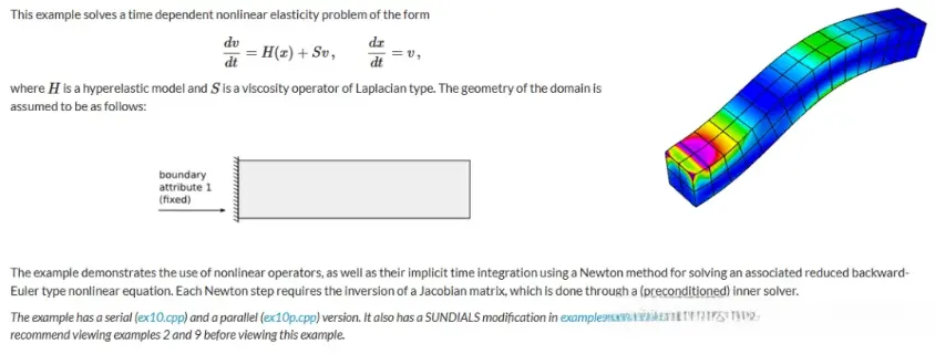

 ![Clipboard - 2025-01-12 19.30.53_thumbnail](https://www.cax.do/uploads/default/original/2X/6/628ab6acdc4d061faf8c6ea9eff8d566dd6003b6.webp)
MFEM solution for nonlinear elasticity problems, selected from reference [2]

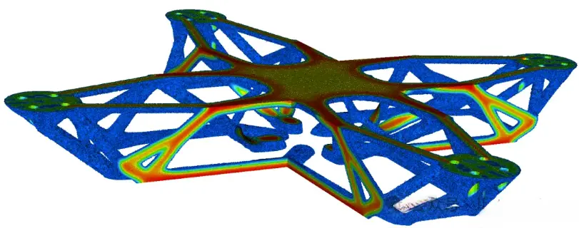

 ![Clipboard - 2025-01-12 19.31.34_thumbnail](https://www.cax.do/uploads/default/original/2X/9/919e2c93648bb2d7ccaa14c9ff6dbd112fec686b.webp)
Topology optimization of a drone fuselage using LLNL’s LiDO project based on MFEM, selected from references [3,4]

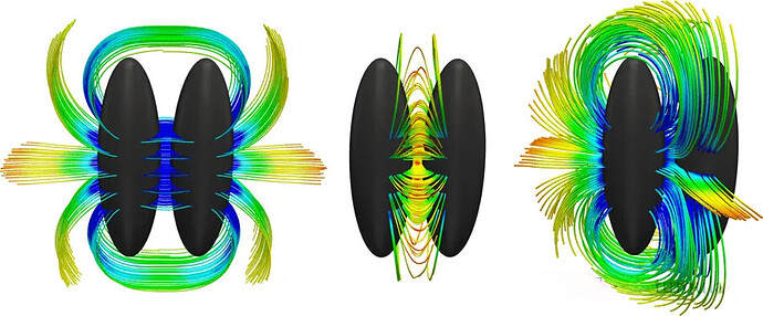

 ![Clipboard - 2025-01-12 19.32.42](https://www.cax.do/uploads/default/original/2X/c/c89b75d2931e064ad97d9a9753cd4217d3f082af.jpeg)
Magnetic field streamlines obtained from the static magnetic interaction of two magnetic spheres using parallel computing on the MFEM platform, visualized with VTK, selected from reference [4]
