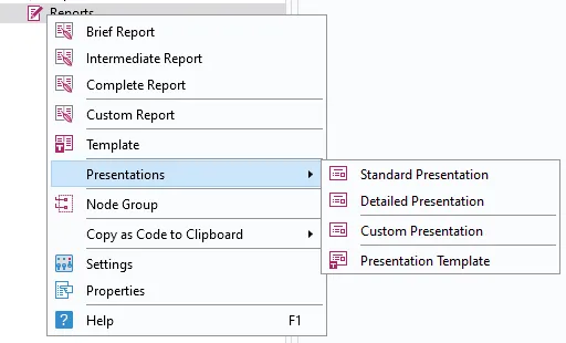

You can add PowerPoint® presentations to the Results section of the Model Builder just like any other type of report. Right-click on the report node and select one of the following presentation templates from the Presentation submenu:
- Standard presentation
- Detailed presentation
- Custom presentation
- Presentation template
Presentation submenu.

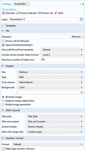

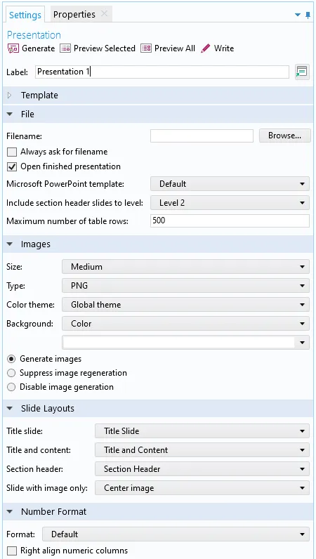

After adding a standard presentation, a Presentation node is added under the Report node. This node contains all the settings for the presentation, such as which COMSOL presentation template and Microsoft PowerPoint template to use, the type and size of the images in the presentation, and which theme and background colors to use. You can also control which slide layout types to use in the presentation. For slide layouts:
- Title slide
- Title and content
- Section header
The settings window for the main presentation section.

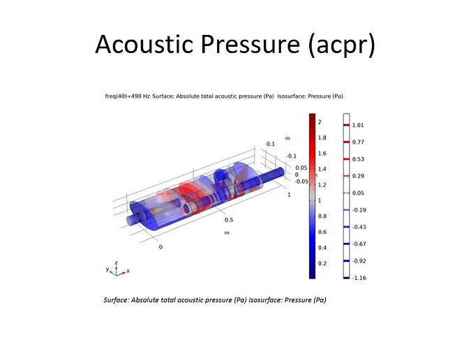

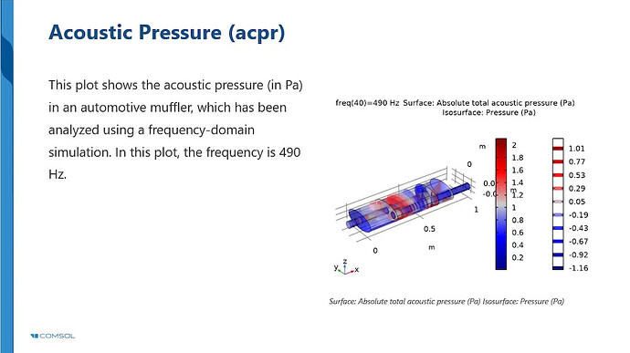

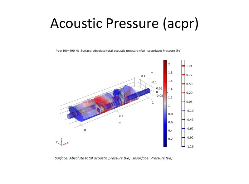

You can change the appearance of the generated PowerPoint presentation by using another Microsoft® PowerPoint® template file, for example to get the appearance from a template used in your organization. By selecting Custom from the Microsoft PowerPoint template list, you can browse and select any Microsoft PowerPoint template file (_.pptx) or Microsoft PowerPoint file (_.pptx). The two images below show a presentation based on the Automobile Muffler model from the COMSOL Multiphysics Model Library. The top image uses the built-in default template, while the bottom image uses a custom template.
 ![image](https://www.cax.do/uploads/default/original/2X/1/19ecf6b0cce9fa4745039f4ca5de08421f7bbe2d.jpeg)
Microsoft® PowerPoint® slide generated using the built-in default template.
 ![image](https://www.cax.do/uploads/default/original/2X/0/0de9da19d6653eccc31200c4ed758fe77de5d14e.jpeg)
Microsoft® PowerPoint® slide generated using the custom template with the same content as the slide above.

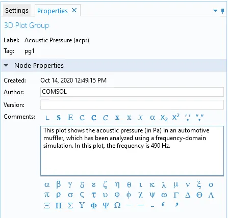

You can add information to presentation slides (and other reports generated by COMSOL Multiphysics) using the Properties window, which is available in all nodes of the Model Builder that contain settings. In this window, you can add comments in the comment box. In the toolbars above and below the text box, you can format the comment using various fonts, mathematical symbols, Greek characters, nonbreaking spaces, dashes, and quotation marks. The figure below shows the comment added to the Sound Pressure plot group node in the Model Builder:
 ![image](https://www.cax.do/uploads/default/original/2X/8/8d18d1c60cb7bb40f807b282ddebe83e73d66a36.png)
The comment added to the plot in the property window of the plot group node.

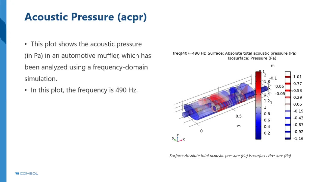

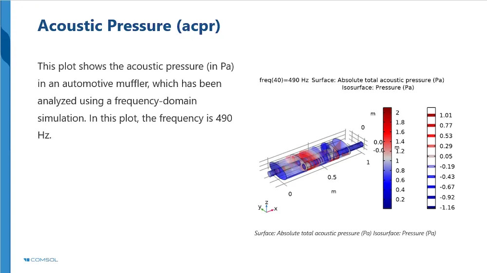

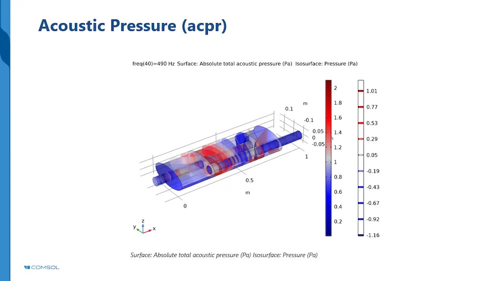

This results in a slide with a different layout than before, where the comment text is located to the left of the plot:
 ![image](https://www.cax.do/uploads/default/original/2X/5/5c07fb279bca0d3f2bef6c96c237784cdb1f2655.jpeg)
The slide with the model comment added to the slide content.
The comments in the Model Builder nodes can be used both as comments set in the model and as text in presentations and reports created from the COMSOL Multiphysics model.

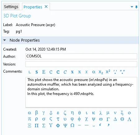

You can use line breaks to annotate text and change it to a bulleted list, where each line break represents a new bullet. In this annotation, non-breaking spaces are inserted to ensure that the units (Pa and Hz) are not separated from the preceding words.
 ![image](https://www.cax.do/uploads/default/original/2X/6/6687bc524f7a21f5ff7ec6287f8d431330efc64f.png)
A comment with a line feed turns the text into a bulleted list. Again, the non-breaking space (\nbsp) is used to ensure that the units are not separated from the preceding word.
The slide show is set up as shown in the figure below.
 ![image](https://www.cax.do/uploads/default/original/2X/f/fa27114d762a3778abf802e496cfad125710a383.jpeg)
