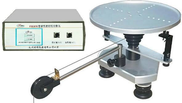

Comprehensive Moment of Inertia Experimental Apparatus
