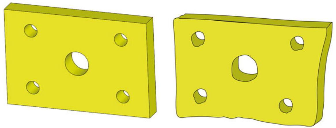

Real surfaces can in fact differ, to various extents, from the exact geometric form foreseen during the design phase, both as far as the geometric form is concerned and for the pre-established position with respect to other surfaces assumed as a reference, as a result of various factors (bending of the workpiece and of the tool during the tooling, vibrations of the machine, deformations during hardening, etc.).
 ![image](https://www.cax.do/uploads/default/original/2X/1/17d02b899320cb8912360b7c94fa28ab087efd98.jpeg)
Fig. 1.1 The real surfaces of a constructed part may deviate to various extents from both the geometrically exact form indicated during the design phase and from the pre-established position with respect to surfaces or points assumed as a datum.
The workpiece in Fig. 1.1 is shown with the form errors conveniently enlarged for explanatory purposes, but it can also appear as such for the instruments that perform precise measurements (such as the modern Coordinate Measuring Machines, CMM).

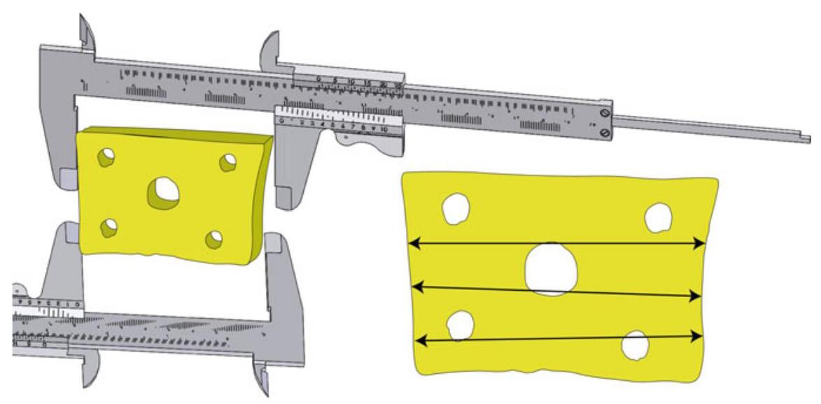

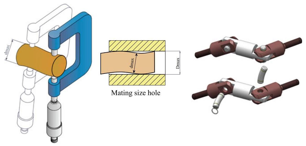

Another example of form error is illustrated in Fig. 1.2: the sinuous trend of the workpiece or not detected by the measurement gauge, which locally ascertains, section by section, the values of the diameters that fall within the dimensional tolerance limits. However, it would be difficult to insert the workpiece easily into an axially extended hole, because the spatial dimension of the pin would be greater than that foreseen for the tolerance.
 ![image](https://www.cax.do/uploads/default/original/2X/6/6740df0fc49fefed0084df1dcc47816abf52fc80.jpeg)
Fig. 1.2 Evaluating the mating conditions by only referring to linear distances leads to the effects of the form being neglected: a smooth f/H shaft-hole mating is in practice forced if the roundness and straightness conditions are not adequate. In fact, the measured maximum dimension, dmax, that conforms to the requested tolerance is less than the Dmax dimension that corresponds to the actual mating dimensions of the pin. Accordingly, it is not possible to fit the hinge pin with the hole because of the error in the straightness of the axis
It is hence necessary to set adequate constraints on the straightness of the axis and on the roundness of the surface. It therefore seems evident that, when establishing the errors that are acceptable in the construction of a part, the form and dimensions should be evaluated in light of the functional requirements. Above all, as the complexity of the designed objects increases, as a result of the numerous technological processes that are now utilised and because of the necessity of guaranteeing quality through careful inspections and verifications, the information that is derived from the project, and therefore from the design of the component that has to be produced, should refer to all the sectors involved as much as possible. The drawings of the workpiece, as requested for the process, should not be ambiguous; the function of the parts, as well as the way of obtaining and controlling them should be completely included and reported.

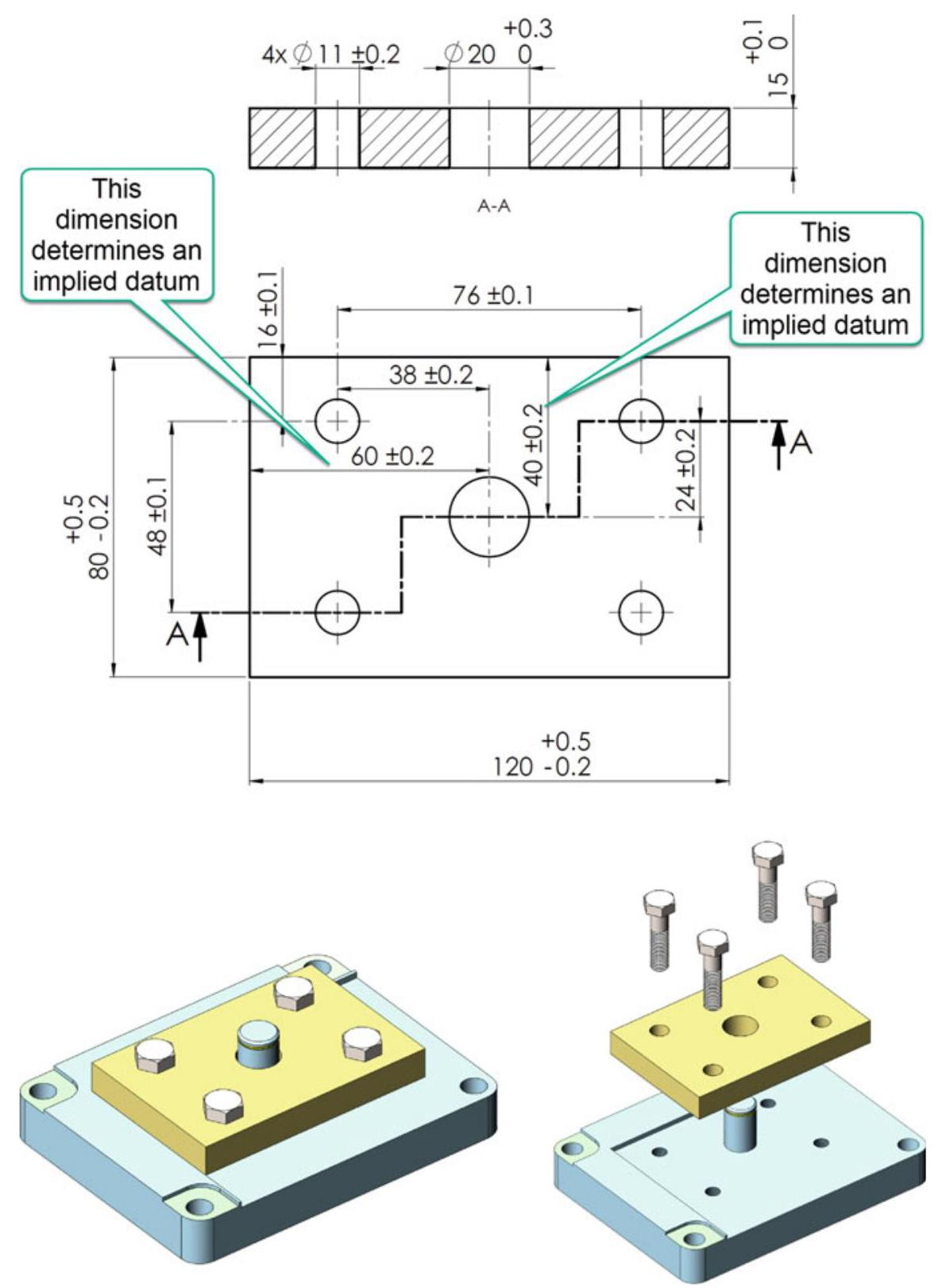

Let us consider the drawing in Fig. 1.3 of a plate with 4 holes, for which the assembly with fixed fasteners is demonstrated as an example; the traditional measurement method has been applied to the plate, that is, with the 4 holes being located according to the dimensional tolerances.
 ![image](https://www.cax.do/uploads/default/original/2X/2/2e28171a110613fe8abadd78c01719b37d183769.jpeg)
Fig. 1.3 Traditional dimensioning of a plate with 4 holes, for which the functional assembly conditions are shown (coherence of the profiles, perpendicularity of the profile, location of the holes, implied datums)

An observation of the thus defined workpiece leads to the following considerations and questions:
(1) Are the edges of the workpiece located with respect to the holes or are the holes located with respect to the edges [1]?
(2) If the distances are considered to originate at the edges, which are not orientated at 90° ,as shown in the drawing (Fig. 1.4),how should the workpiece be arranged exactly to control the dimensional tolerance? Furthermore, the measurement is not just the individual distance between pairs of opposite points.

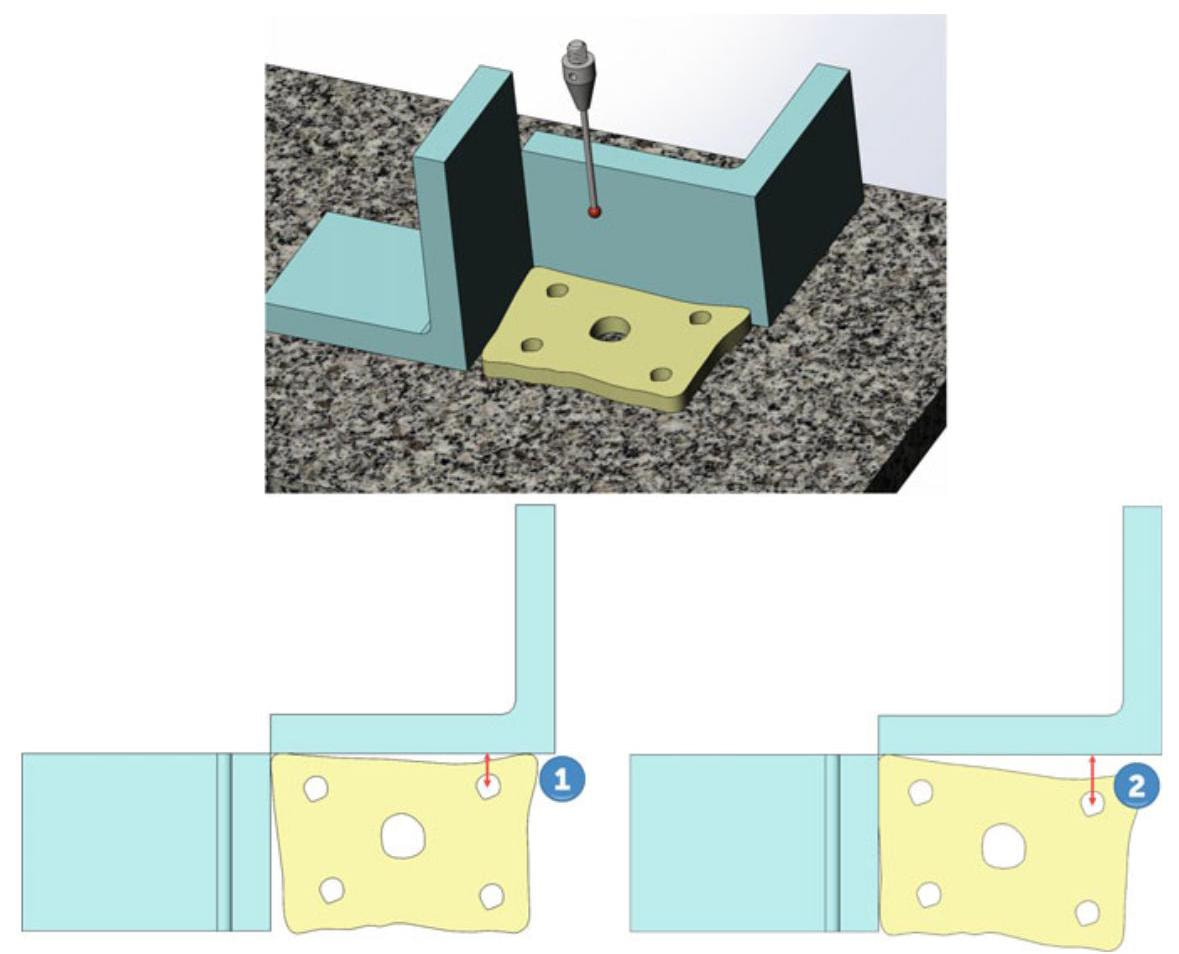

(3) In coordinate tolerancing, since datums are implied and they depend on the interpretation of the metrologists, the placement on the gauging surface may produce different measurement results. Hence it is possible that a good part may be rejected or a bad part may be accepted. Furthermore, if the datum sequence is not indicated, the control of the location of the holes can be conducted in different ways (for example, by first checking the position of a hole and from this position then checking the positions of the subsequent holes, or by considering one or two edges as a single datum for all the holes, see Fig. 1.5): such a control is therefore neither univocal nor repeatable.
(4) The cross-sectional area of the tolerance zone for the position control of the hole axis is square, while the form of the hole is round; therefore, the tolerance area does not mirror the form of the hole that it should protect. Moreover, starting from the theoretical position (point 0 in Fig. 1.6), various possible limit positions of the axis are possible, depending on the radial directions (a possible error of 0.28mm can be reached along the diagonal of the square,that is,a greater error than the tolerance of 0.2 indicated on the drawing).
 ![image](https://www.cax.do/uploads/default/original/2X/9/94c46c5fb121761832bc59e6505bbf5e4eabae44.jpeg)
Fig. 1.5 Without any indication of the datums, the control of the position of the holes is not univocal or repeatable (measurements 1 and 2 give different results, according to the support system of the part used during the verification)

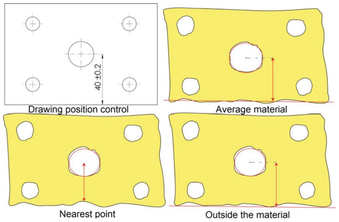

(5) A series of measurements can lead to an accumulation of the error pertaining to the position of the holes; Fig. 1.7 shows that it is important to report, in a clear way, the control method that is used for the positioning of a hole, which, if left to the discretion of an inspector, could lead to a variety of very different results.
(6) Finally, the workpiece may be rejected during the control because it does not conform with the tolerances prescribed during the design phase, even though it can be coupled and it is functional.
Inconveniencies of this type are more common than one might think, and they may lead to negative effects on the cost and times necessary for the construction of a component.
In short, the technical product documentation of a product without functional geometric tolerances and without any indication of datums is generally incomplete, and therefore not unambiguously interpretable. Such an incomplete, ambiguous toler-ancing of components on engineering drawings leads not only to increased production and inspection costs but also to an incalculable liability risk in the case of legal disputes.
 ![image](https://www.cax.do/uploads/default/original/2X/e/ed5f31bf1abbcccde9d7039c4a9fc2ba352c5de0.jpeg)
Fig. 1.6 Starting from the theoretical position (point 0), the limit positions allowed for the axis may be larger or smaller, depending on the radial directions. The axis position of the hole at point 1 is accepted during the control, but if it occurs at point 2, the workpiece is discarded. But which of the two holes is closest to the ideal position?
 ![image](https://www.cax.do/uploads/default/original/2X/e/e298a2a5204b604cd80643070ced247073fca1f2.jpeg)
Fig. 1.7 The control of the position of a hole may be achieved by resorting to of the use of ideal circles and surfaces (known as associated geometry in the ISO system). The three verification methodologies shown in the figures could furnish contrasting results
