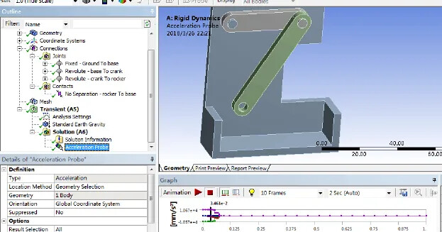

1. **Drag a Rigid Dynamics Template** : From the toolbox, drag a rigid dynamics template into the project schematic. Follow the normal steps to create a rigid dynamics analysis, applying forces, moments, etc., and then insert the necessary result objects.

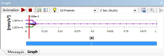

2. **Identify Time Points** : Determine the time points of interest in the graphics window.

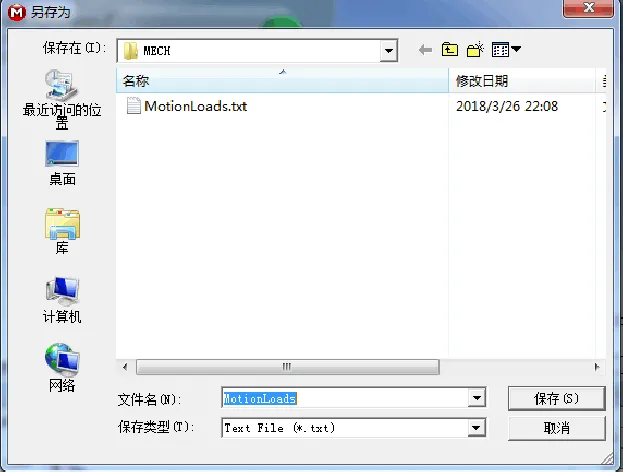

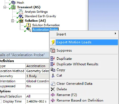

3. **Export Motion Loads** : Select a result object, right-click to choose “Export Motion Loads,” and specify a load file name.

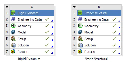

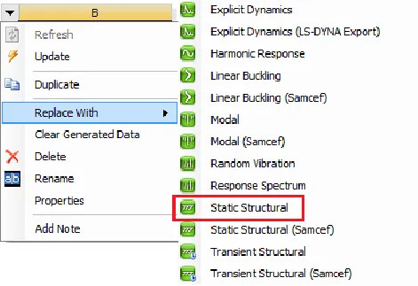

4. **Copy the Rigid Dynamics Analysis System** : In the project schematic, copy the rigid dynamics analysis system and replace it with a static structural analysis system.

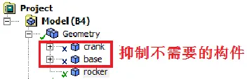

5. **Edit Static Structural Analysis** : Suppress unnecessary components, leaving only those whose strength and stiffness need to be analyzed.

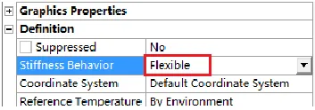

6. **Change Component Stiffness** : Change the stiffness behavior of the component from rigid to flexible.

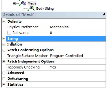

7. **Set the Solver** : Change the mesh solver settings from ANSYS Rigid Dynamics to ANSYS Mechanical.

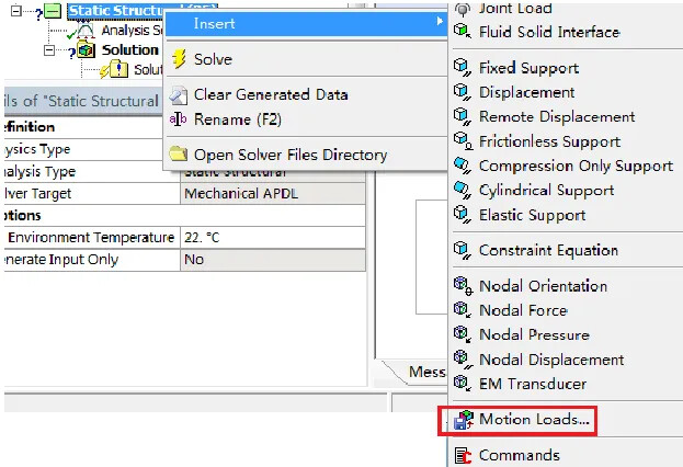

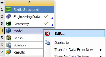

9. **Import Motion Loads** : Select the static structural branch, right-click, and choose “Insert \> Motion Loads…” to import the loads from the previous file.

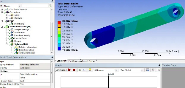

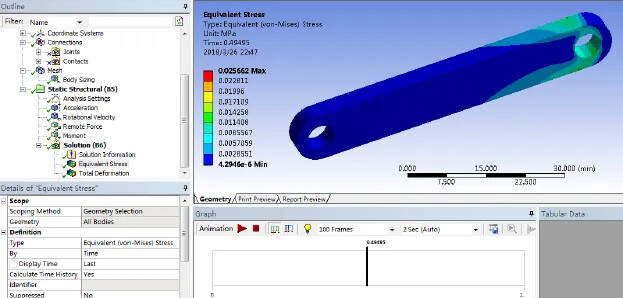

10. **Update Result Objects** : Delete the original result objects and add new objects for stress, deformation, etc.
 ![image](https://www.cax.do/uploads/default/original/1X/2baa29b60900131e3737011bc9139c518166822c.png)
11. **Solve for Stress and Deformation** : Solve to obtain the stress and deformation of the component at the specified moment (t = 0.49495 s).
