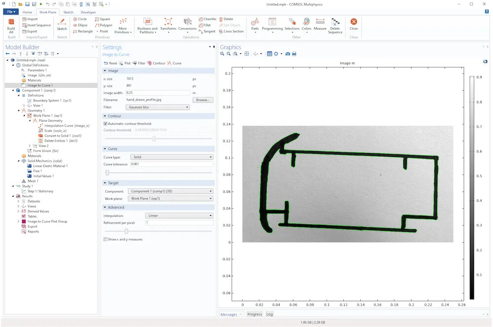

**Imported Photo:** A photo taken with a smartphone, with black marking lines outlining the contours, and green fine lines showing overlaid contour lines.

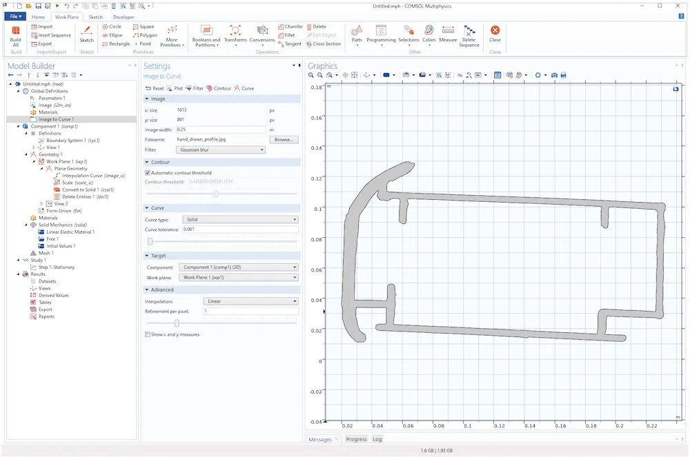

**Image Conversion to Model Geometry:** After removing irrelevant domains generated during the image-to-geometry conversion process, the resulting 3D geometry contours are obtained.

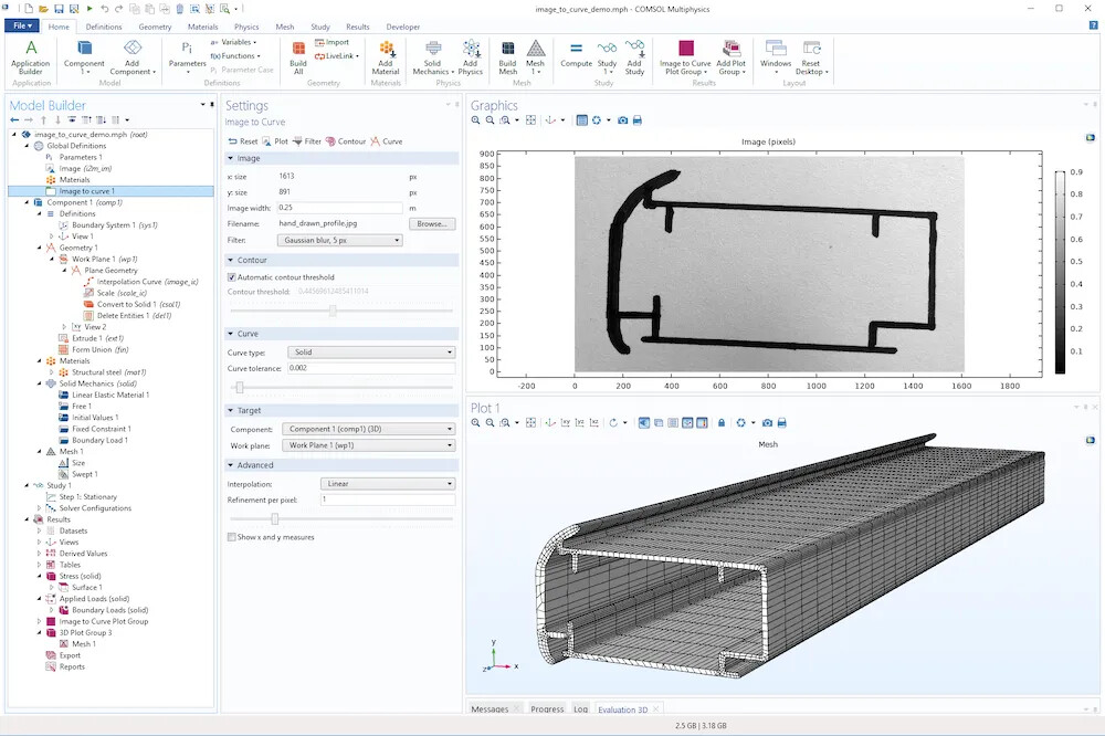

**Swept Mesh Based on Black Marking Line Contours:** The swept mesh is generated from the contours created with black marking lines.

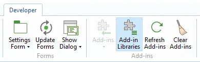

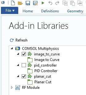

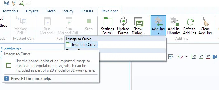

1. First, select the _Developer Tools_ tab in the model builder, click on the _Plugin Library_, and enable the “Image to Curve” plugin from the library.
2. From the list, select the “Image to Curve” checkbox to enable the plugin.
3. Once enabled, you will see the “Image to Curve” plugin displayed in the interface.

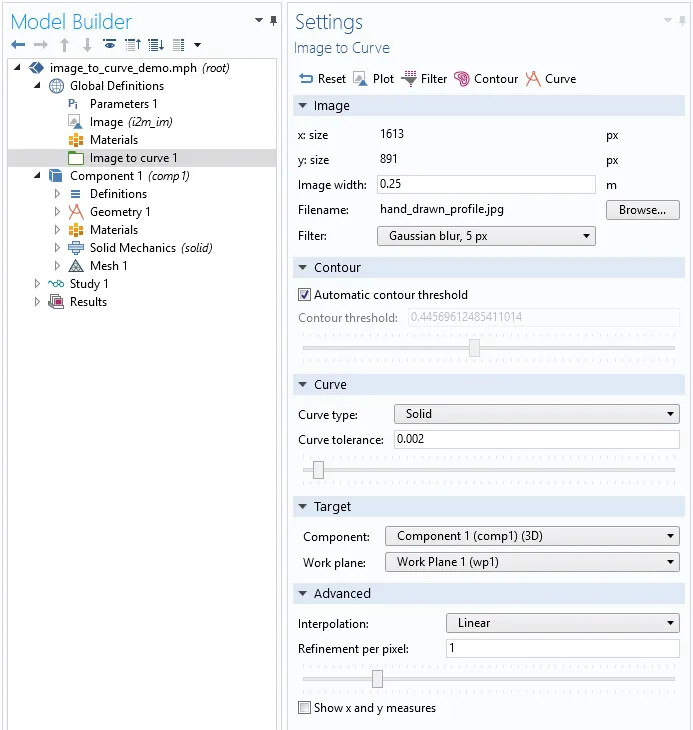

### “Image to Curve” Settings Window

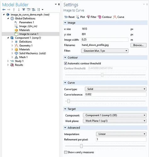

The “Image to Curve” plugin settings window is shown below. The top of the window contains 5 toolbar buttons and 5 sections with different settings.
 ![image](https://www.cax.do/uploads/default/original/1X/5b110930b945cf5b1ac48403d1018649c799e8f4.jpeg)

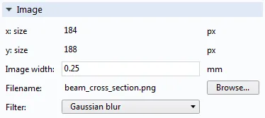

- When importing an image, it is converted to grayscale, and the image’s dimensions in pixels (x and y), width in current length units (as determined by the geometry node), filename, and filter settings will be displayed.
 ![image](https://www.cax.do/uploads/default/original/1X/67b1e6e8f56e734da02410534288f79bae8a2adc.png)

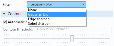

By adjusting the image width value, you can modify the final geometry structure size. You can also adjust this setting later by adding scaling feature nodes in the geometry sequence. The filter options include some blurring and sharpening filters to reduce noise or enhance edges in the imported image.

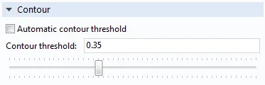

By default, the contour curve is automatically placed where the pixel intensity level is close to the average threshold in the filtered image. If you need to manually control the contour threshold, clear the “Auto Contour Threshold” checkbox.

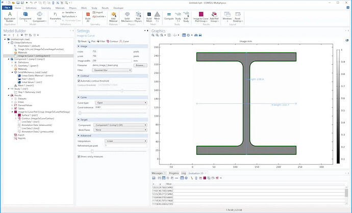

 ![image](https://www.cax.do/uploads/default/original/1X/9badd7daa4c821dfd1e78038eb8e301d3990f5f4.png)

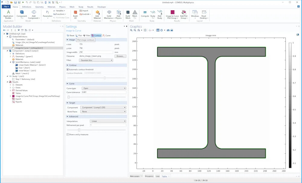

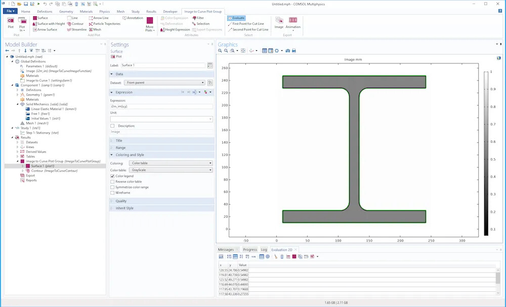

Click the **Contour** button in the toolbar to visualize the contour curve and image. The following is an example of a contour line (green) from an imported I-beam image.
 ![image](https://www.cax.do/uploads/default/original/1X/cf16100c57f1735418cb1106689a9b5dd15676bf.jpeg)
To inspect pixel values, select the surface nodes in the “Image to Curve” group and click on the graphical window. The pixel values and coordinates will be displayed in a 2D computation table.

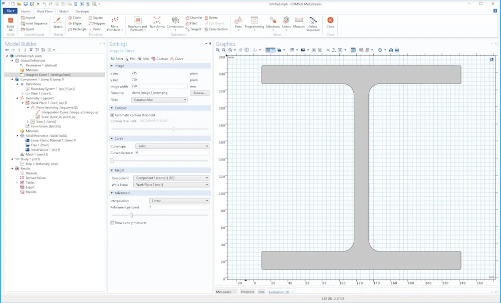

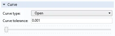

Click the **Curve** button in the toolbar to generate interpolation curve nodes in the 2D geometry sequence or 3D work plane. By default, the curve type is set to open, but you can change it to closed or solid. The curve tolerance setting determines how close the curve should be to the contour curve.
The following image shows an example of an I-beam, where the curve type is set to solid and the curve tolerance is set to 0.0.

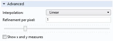

In the _Advanced_ section, you can change the interpolation method used for visualizing the image, choosing between linear and nearest neighbor interpolation. The pixel refinement setting determines the number of grid cells representing each pixel in the image: values less than 1.0 mean fewer interpolation points than the pixels in the image, and values greater than 1.0 mean the grid will oversample the image.
 ![image](https://www.cax.do/uploads/default/original/1X/ffc8ae2662f276b343a8e2fb81ce5c286f55212c.png)

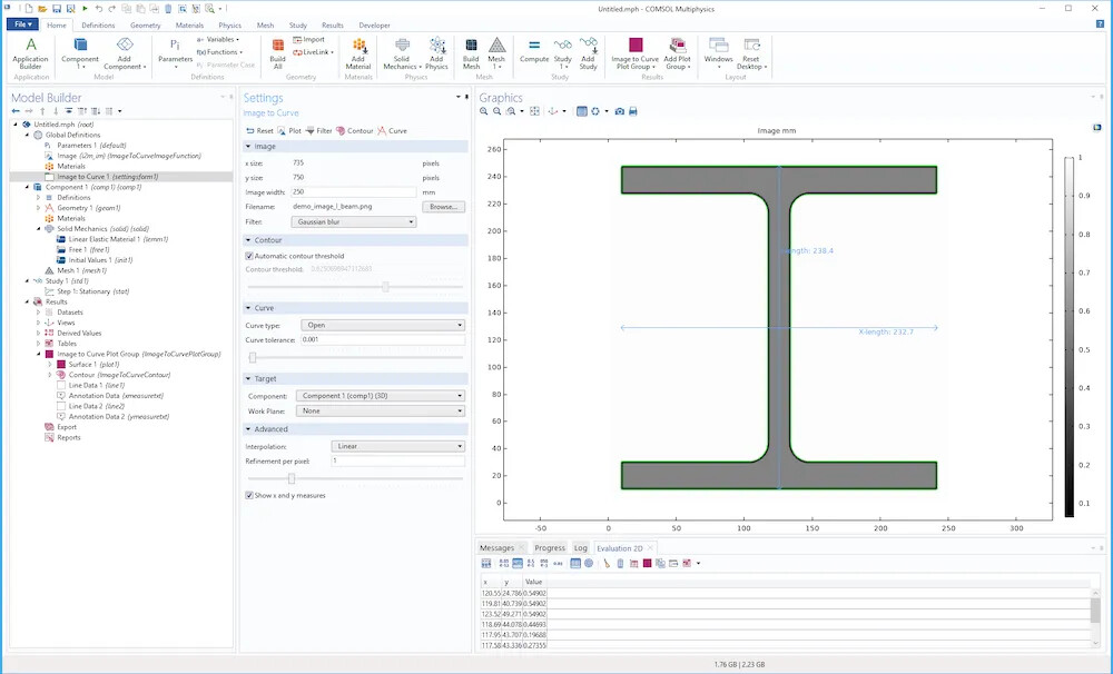

The checkbox for showing x and y measurements allows you to control whether to display the dimensions of the contour curve.
 ![image](https://www.cax.do/uploads/default/original/1X/6628b37d3a03434f55468d52f06e7762706431de.jpeg)

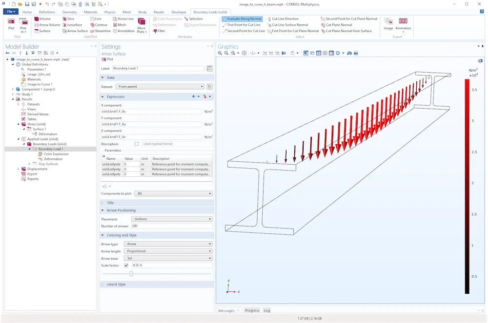

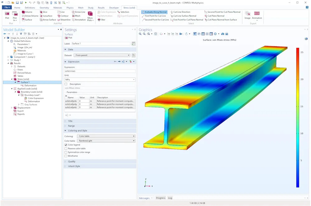

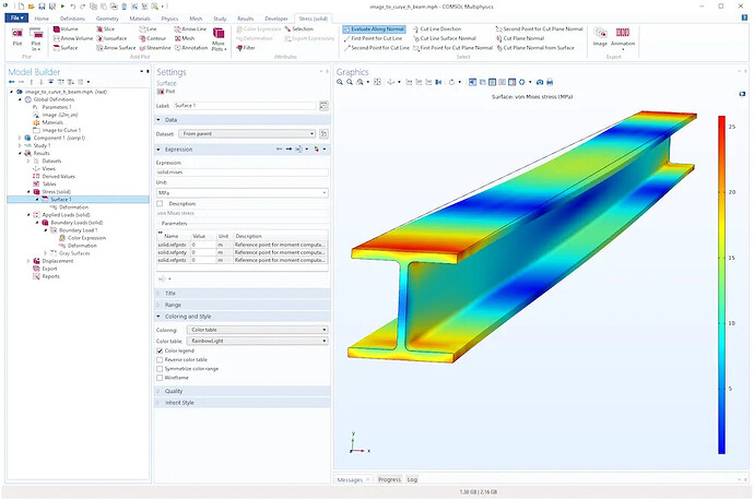

The example model file _image\_to\_curve\_h\_beam.mph_ contains a simple structural analysis with a distributed load, as shown below. The distributed load is based on the geometry formed by stretching the image geometry.
