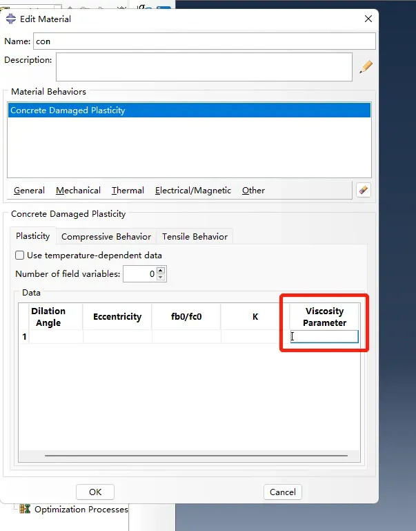

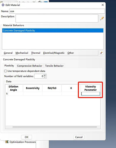

- **Modifying the Viscosity Coefficient (for Concrete CDP Model)**
**Simple Explanation** : Increase the viscosity coefficient, originally 0, adjusting it between 1e-5 to 1e-7.
**Specific Operations** : For components involving concrete, if the CDP (Concrete Damage Plasticity) model is used, increasing the viscosity coefficient helps the component converge better, though the data accuracy may decrease.
**Evaluation** : This is a relatively easy adjustment but introduces some error. The peak values may be smaller than the actual values.
**Ease of Operation** : ★★★★
**Accuracy** : ★★★

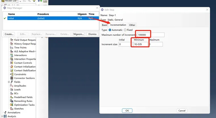

- **Adjusting Minimum Step Size and Maximum Iterations**
**Simple Explanation** : During iterative calculations, if the error exceeds the required value, iterations continue until the error is within the required range. If the maximum number of iterations is exceeded, the calculation stops. Therefore, the number of iterations should be set high, while the step size should be small to allow gradual progress. A very small step size (e.g., 1e-5) might allow the model to continue, but the system may terminate early if it’s too strict. Hence, a smaller minimum step size may benefit convergence.
**Specific Operations** : Typically, set the minimum step size to a very small value like 1e-35.
**Evaluation** : This method is effective, but it may result in a large ODB (output database) file, which consumes considerable computational resources.
**Accuracy** : ★★★★
