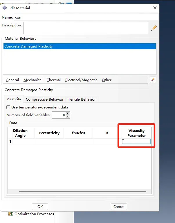

### 3. Modifying Viscosity Coefficient (Concrete CDP Model)
- **Simple Explanation** : Increase the viscosity coefficient, originally set to 0, adjusted between 1e-5 and 1e-7.
- **Specific Operation** : For components with concrete using the CDP (Concrete Damage Plasticity) model, a higher viscosity coefficient improves convergence, but the data may be inaccurate.
- **Evaluation** : Relatively easy to implement, but it may introduce some error; peak values are generally lower than actual values.
- **Operability** : ★★★★
- **Accuracy** : ★★★

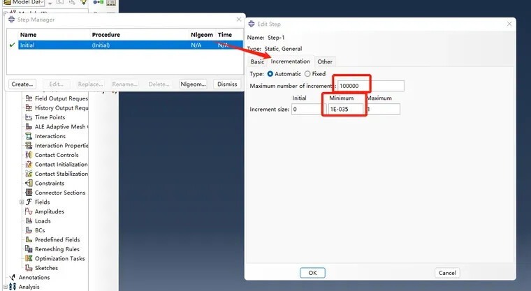

### 4. Adjusting Minimum Steps and Maximum Iterations
- **Simple Explanation** : During iterative calculations, if the error exceeds the required threshold, the system continues to iterate until the error is less than the threshold. If the maximum number of iterations is exceeded, the calculation cannot proceed, so the iteration steps should be large. For iteration step size, if the error is significant, the software will proceed cautiously, resulting in very small steps. For example, if you set it to 1e-5, the model may still calculate with a 1e-6 step size, but the system will directly terminate the computation. Therefore, setting the minimum step size smaller may facilitate convergence.
- **Specific Operation** : Generally adjusted to a minimum of 1e-35.
- **Evaluation** : This method is somewhat effective but can lead to large ODB files, consuming significant computational resources.
- **Accuracy** : ★★★★

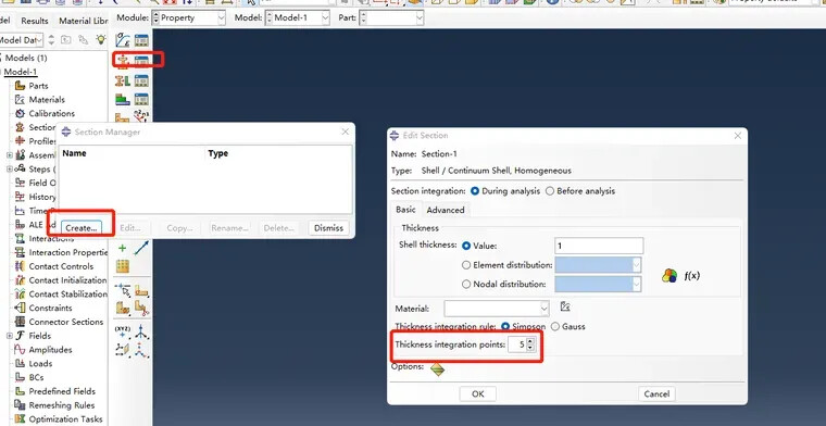

### 5. Adjusting Thickness Integration Points (Shells)
- **Simple Explanation** : When integrating the thickness of a shell, having 3 integration points indicates a cubic simulation, while 5 points indicate a fifth-degree polynomial simulation. Higher-degree polynomials are more accurate but harder to converge.
- **Specific Operation** : Typically, a fifth-degree polynomial is used; to ensure smoother simulations, a third-degree polynomial can be employed, slightly reducing computational accuracy.
- **Evaluation** : This is applicable for shells but not particularly significant.
